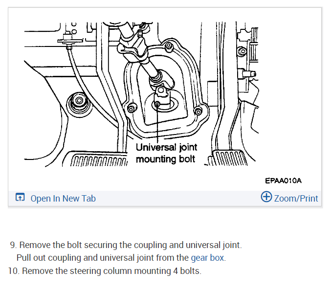

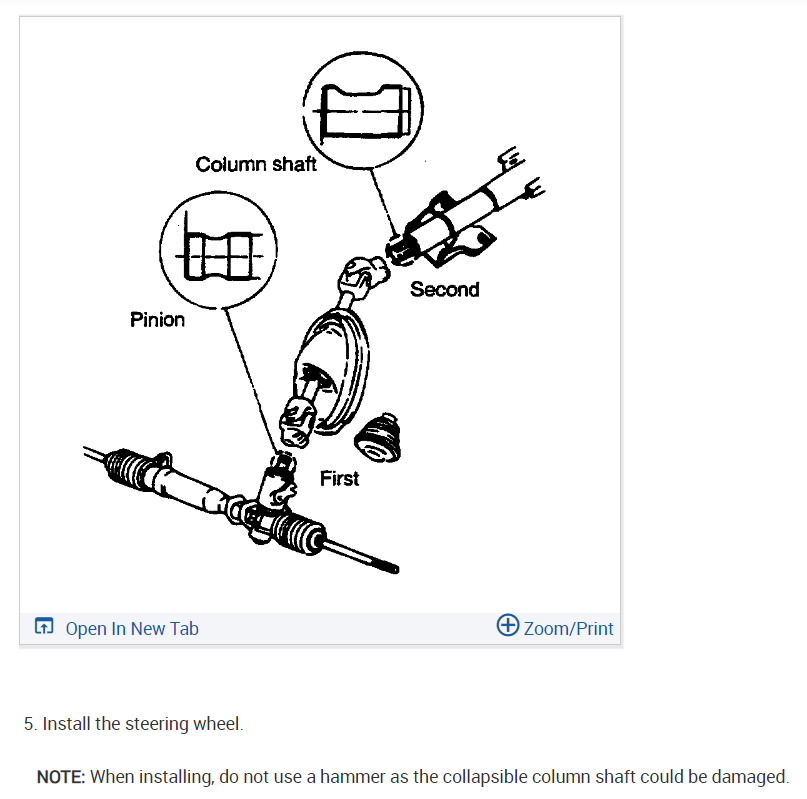

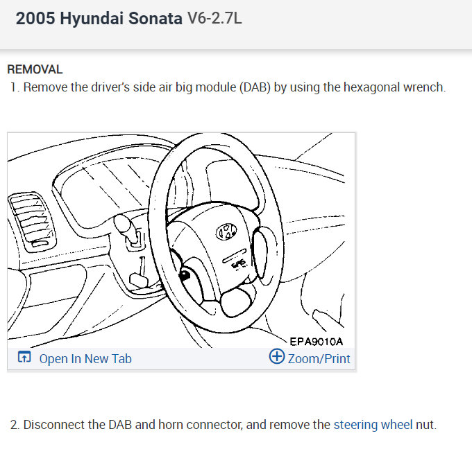

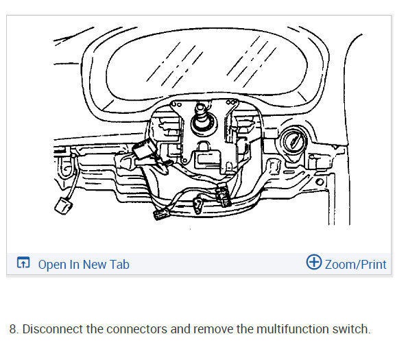

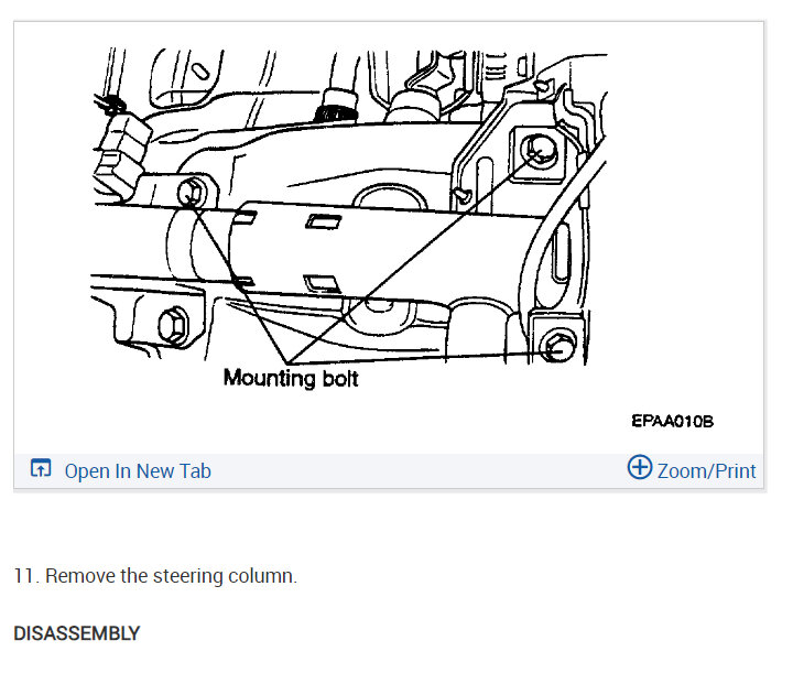

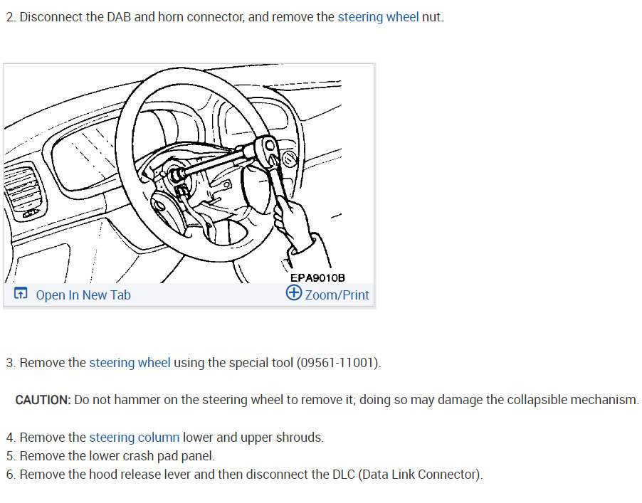

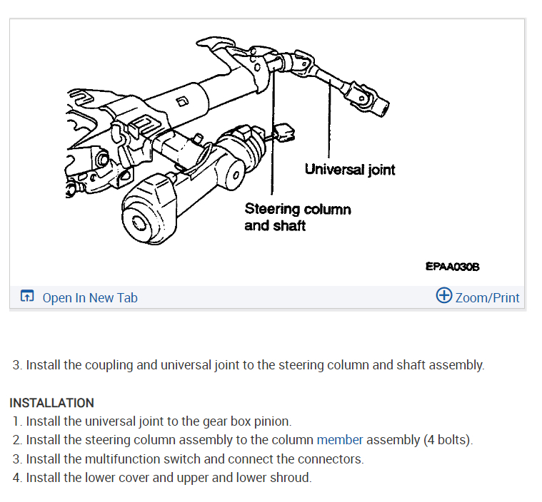

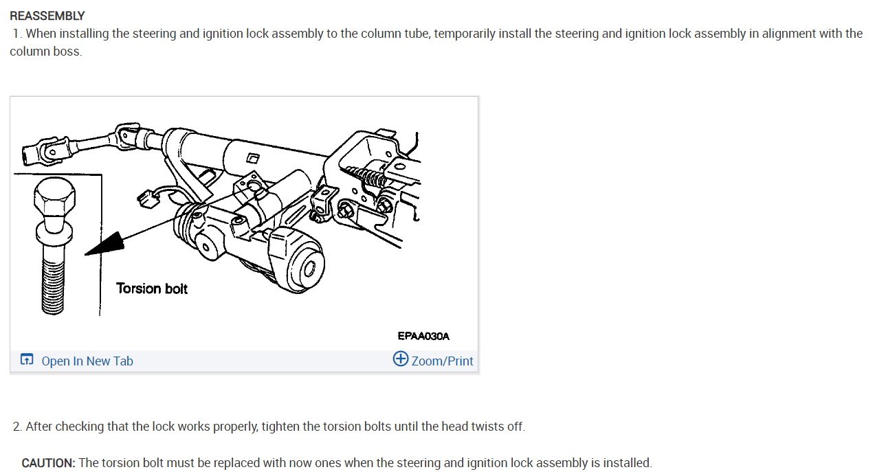

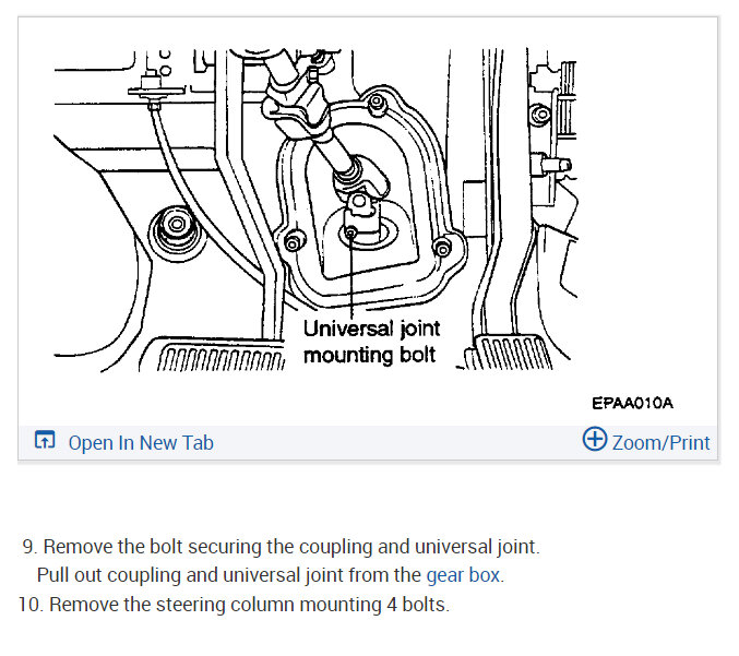

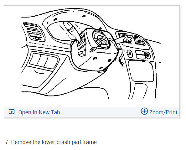

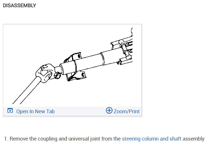

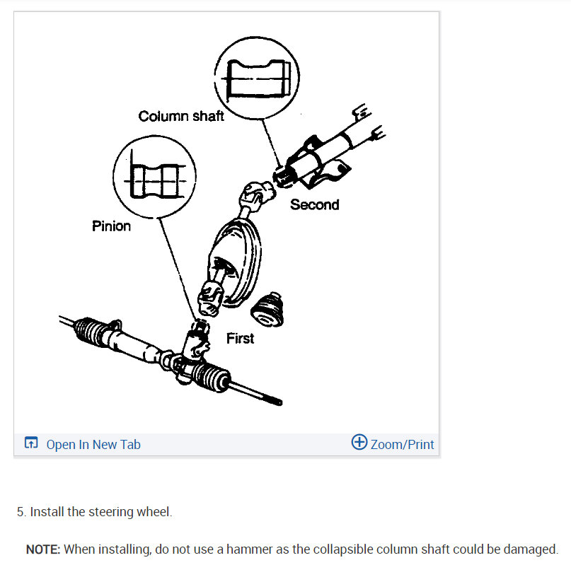

I am going to replace my whole ignition assembly. Can someone tell me will I be able to do this with the steering column in and is there anything else I should know before I do this, I would appreciate it.
Thank you
May 20, 2024 at 1:00 PM (Merged)

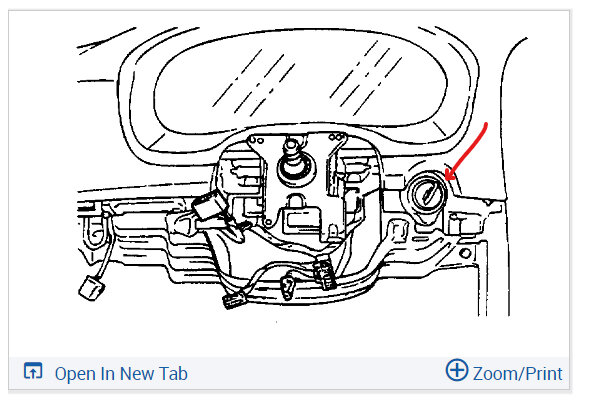

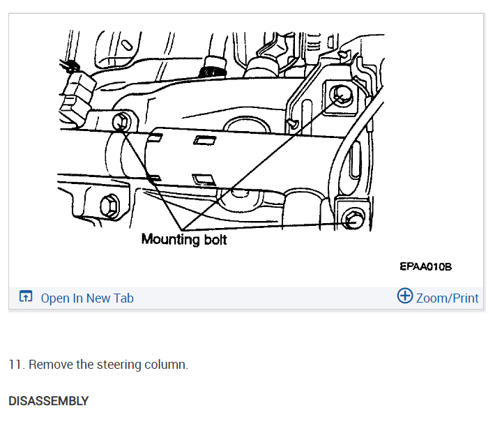

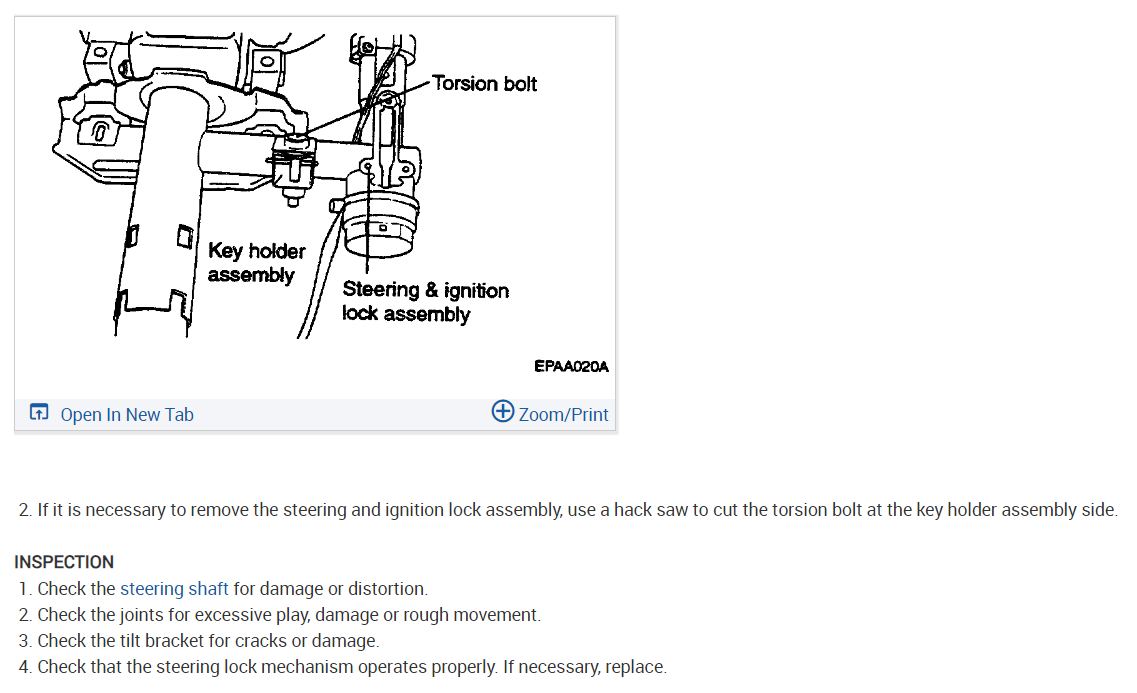

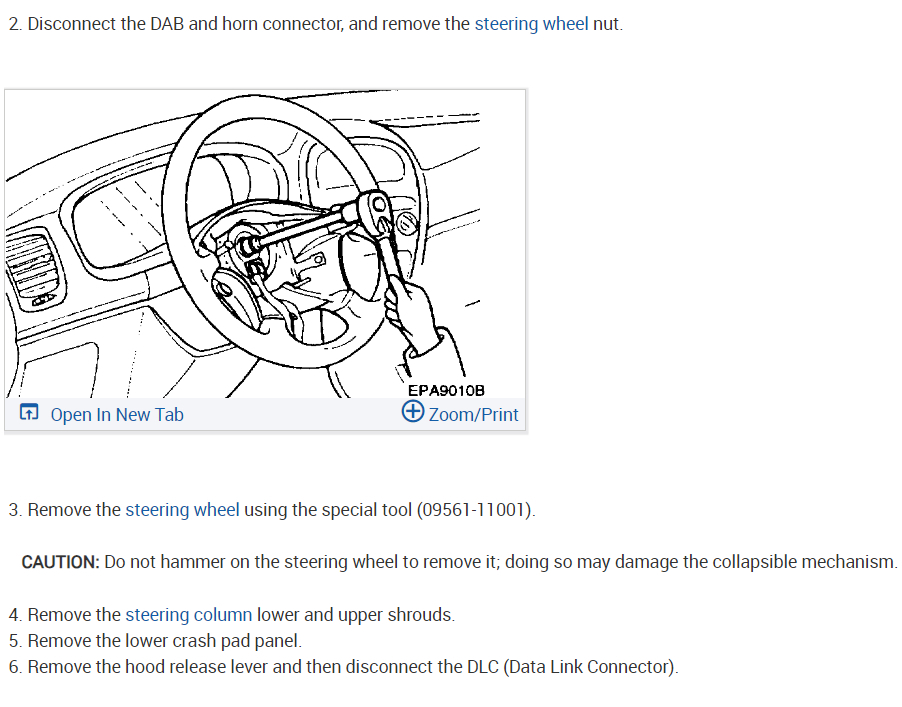

Apparently you need to remove the steering column to replace the key lock, here is how in the images below. Check out the images (below). Please let us know what happens.
