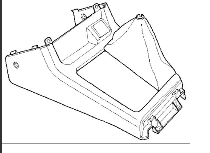

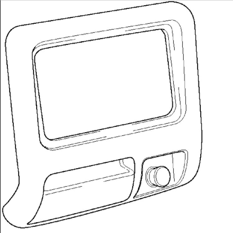

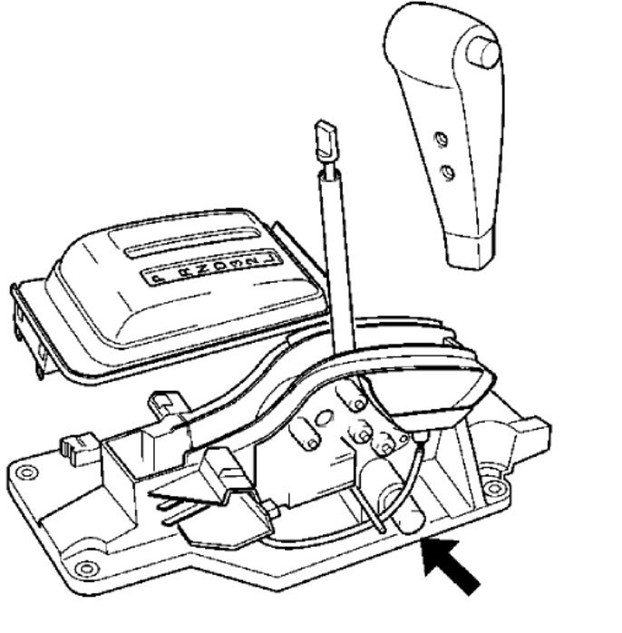

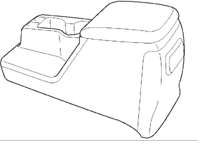

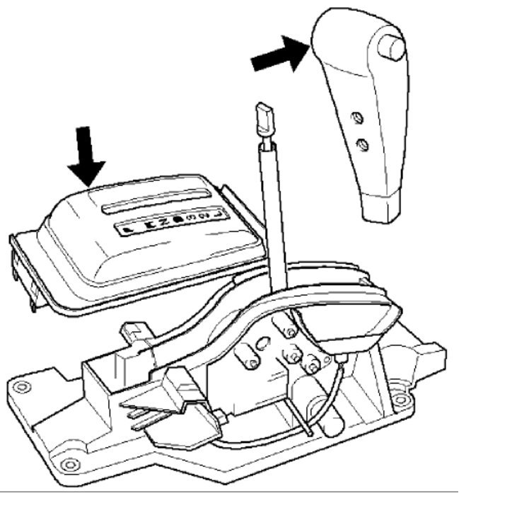

This is most likely a problem with the shift-lock cable that goes from the shifter to the ignition switch. If the cable wears out it will not push the lock into place. Remove the shift cover to check its operation. Here is some diagram to help you get the problem fixed.
May 16, 2017 at 1:06 PM
BOBBYDAVISM
Thank you. The brace for the cable going into the ignition switch had lost the screw holding the cable secure. Screwed back on and now the cable is working like designed and my problem is fixed.
