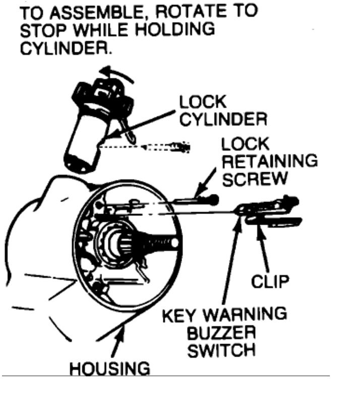

Hey CHRIS,
What happens is the key and tumbler wear out locking the ignition to the on position, you must replace the key and tumblers with a new unit. This will take some special tools to pull the steering wheel off.
If you could take some pics while doing the job and posting them it would be great!
Please let us know what you find so it will help others.
