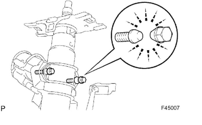

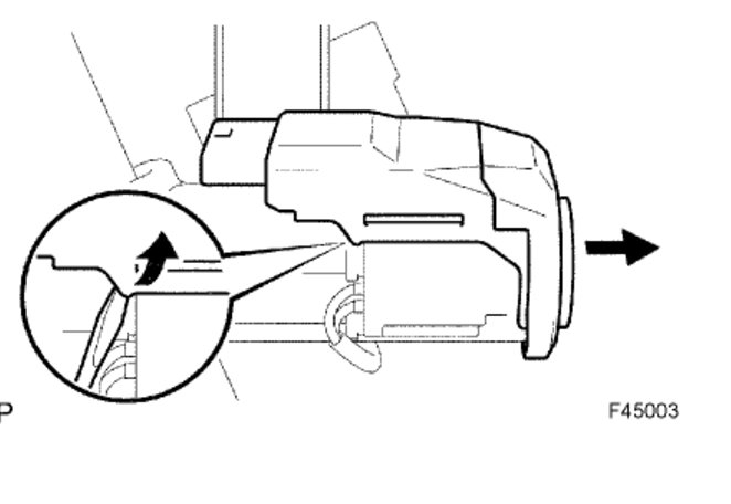

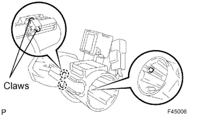

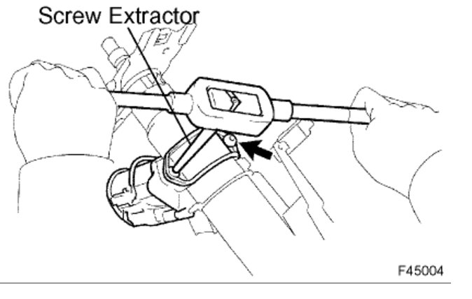

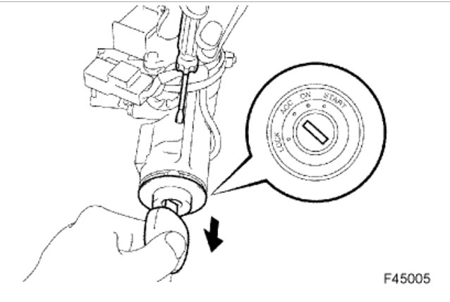

What happens is the ignition key gets worn out so its gets stuck. Here is a guide to help you get the ignition tumbler changed out.
