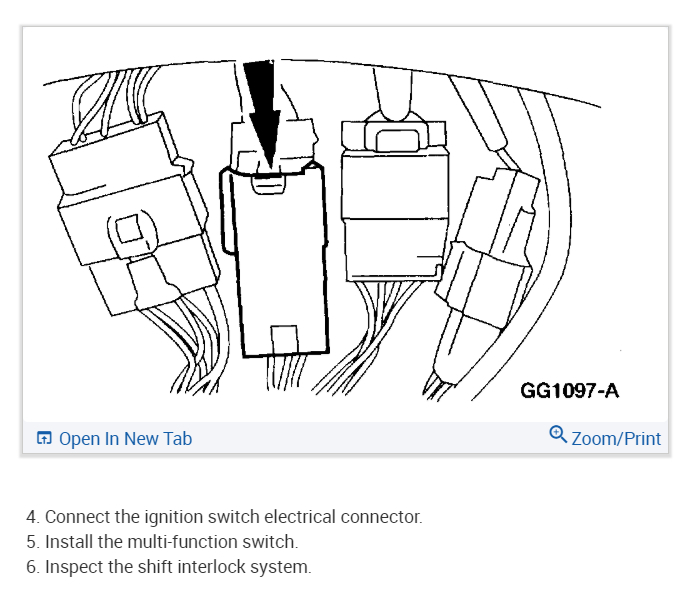

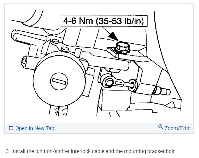

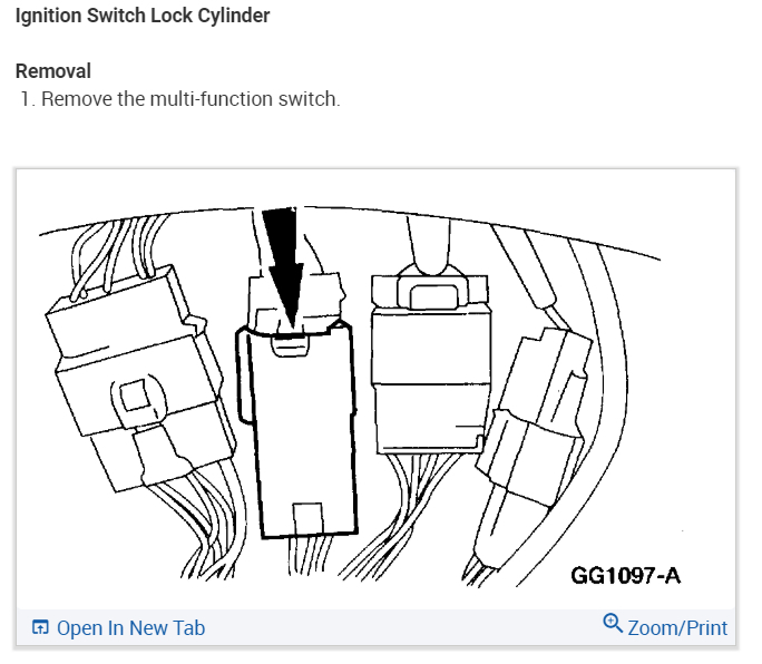

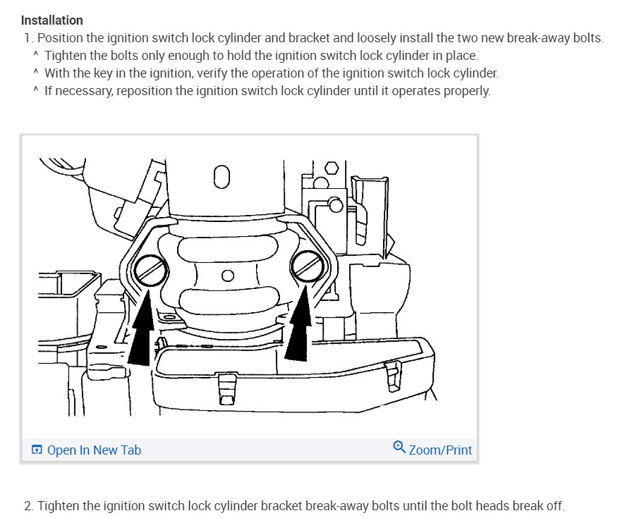

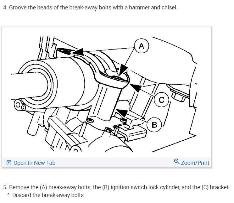

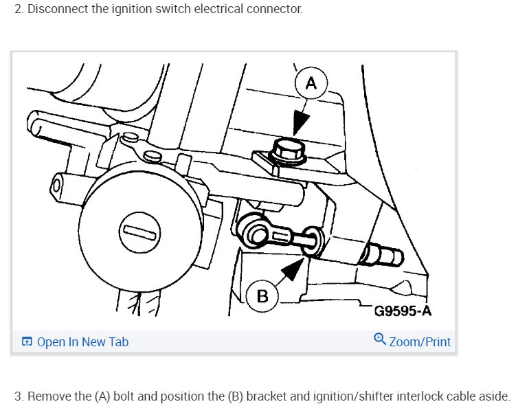

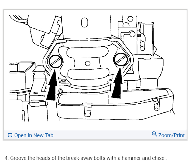

Sorry for the delay we had an issue with the system. Can you put the transmission in park? if so it sounds like the key tumbler is broken/worn out here are diagrams to help you replace it. Make sure you get the new one from the dealer bring your VIN number with you so they can program it before you install it.
Check out the diagrams (Below). Please let us know what happens.
