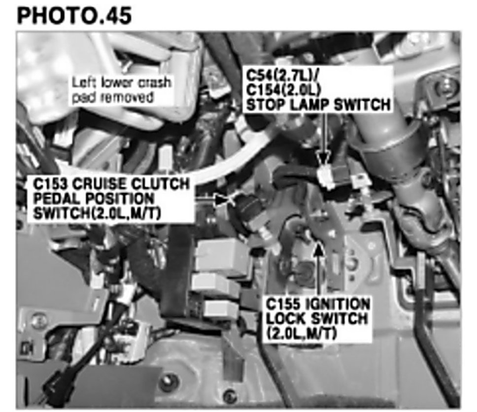

It looks like there is an ignition lock switch down at the steering column if this switch is not working it may cause the problem you are having. The next this I would do is a CAN scan which is easy. You can get a CAN scanner from Amazon for about $30.00.
Here is a video to show you how:
https://youtu.be/u-4syLc-ifQ
Here is a scanner link:
https://amzn.to/3o41KcZ
Check the location of the ignition lock switch below.
Aug 30, 2022 at 12:23 PM
