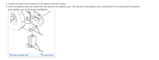

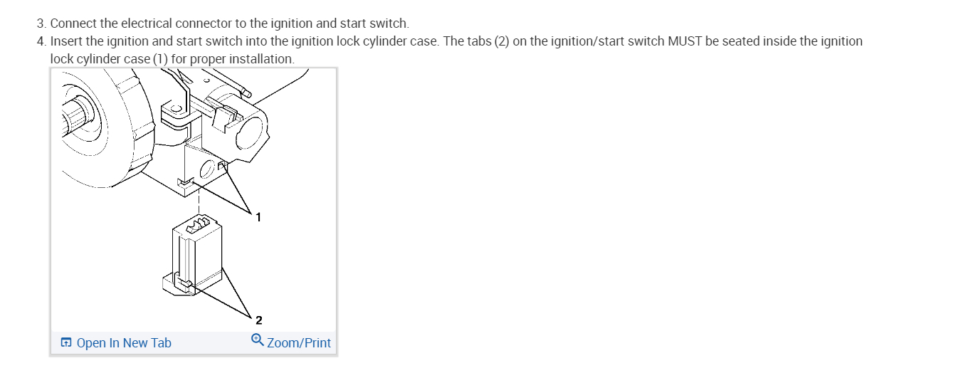

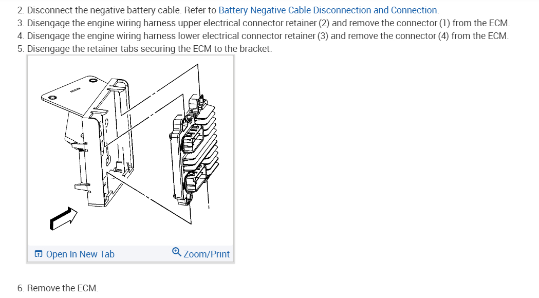

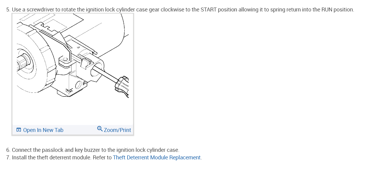

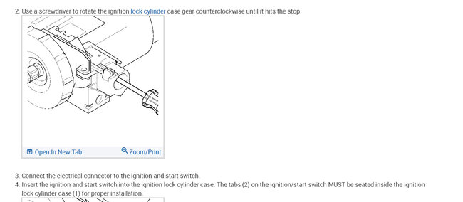

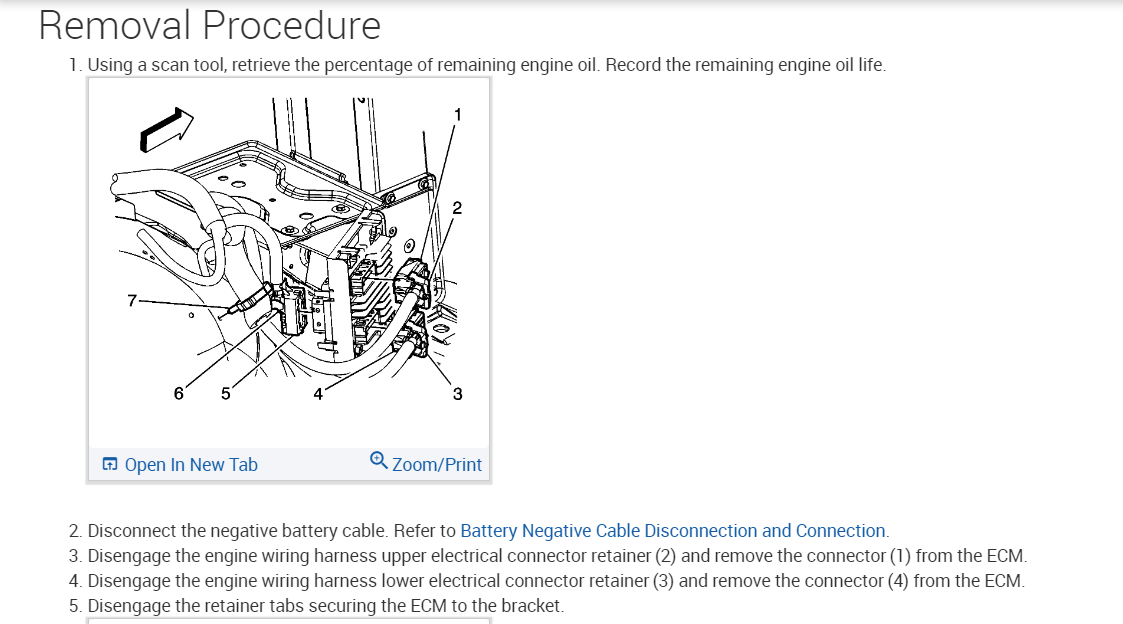

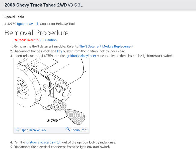

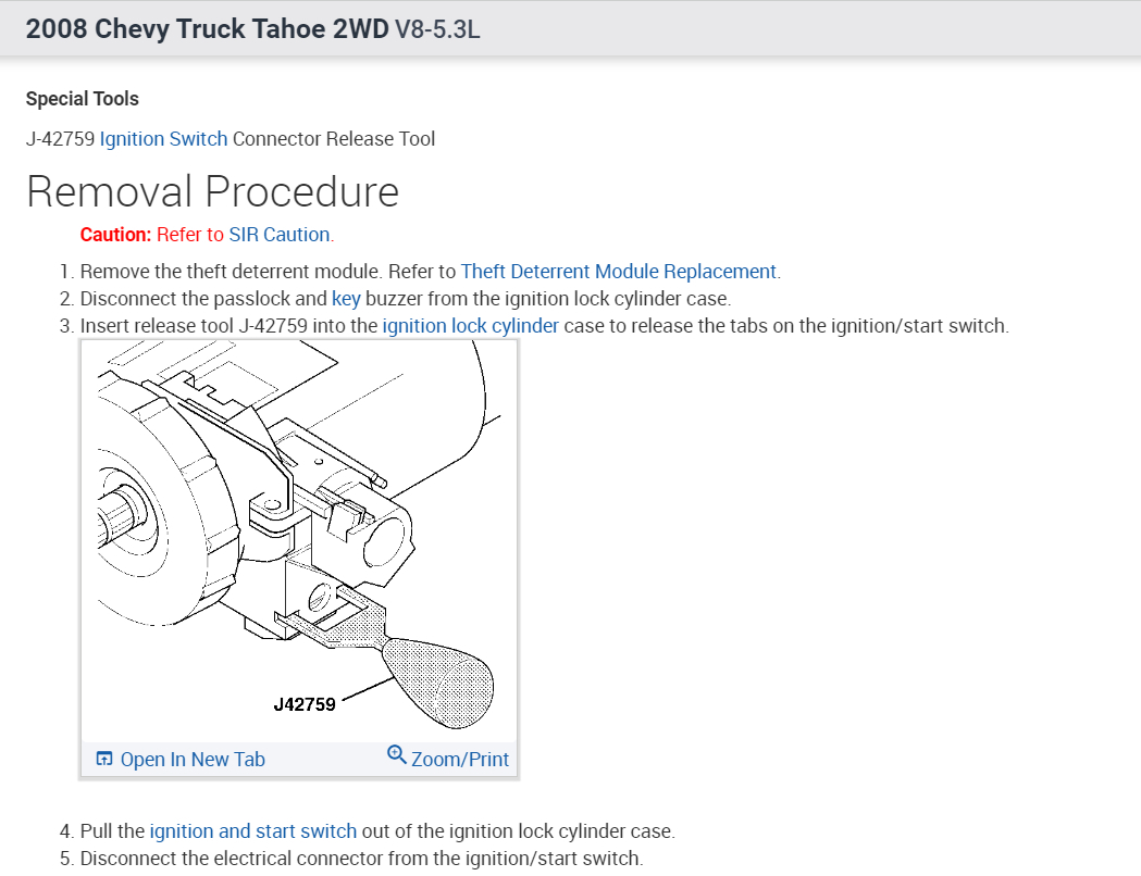

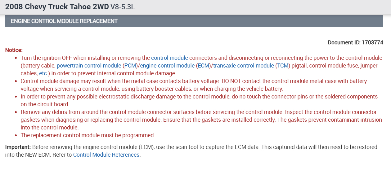

Yes, that is possible the ignition switch could be inhibiting the relearn. Can I ask if you had the new ECM programmed before you installed it? If not, this could be why the system is not working. Here is a guide to help you see what I am talking about, you can get a preprogrammed unit by searching Google or Ebay.

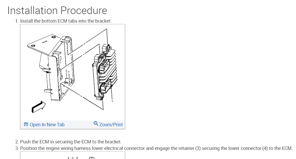

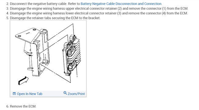

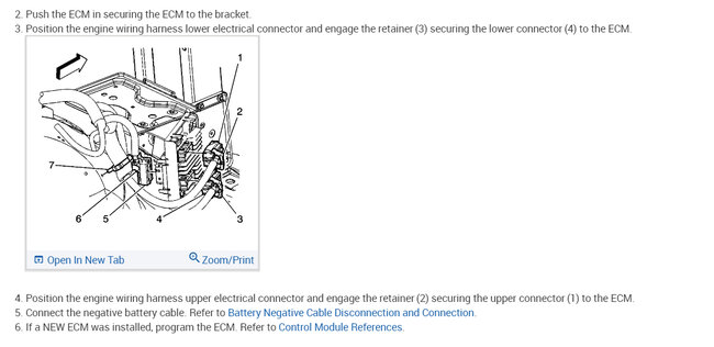

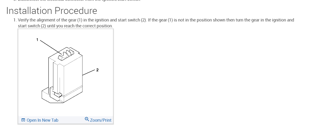

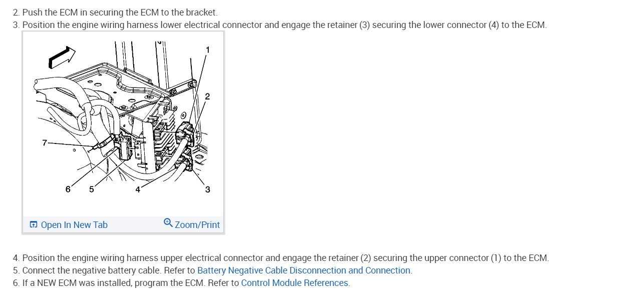

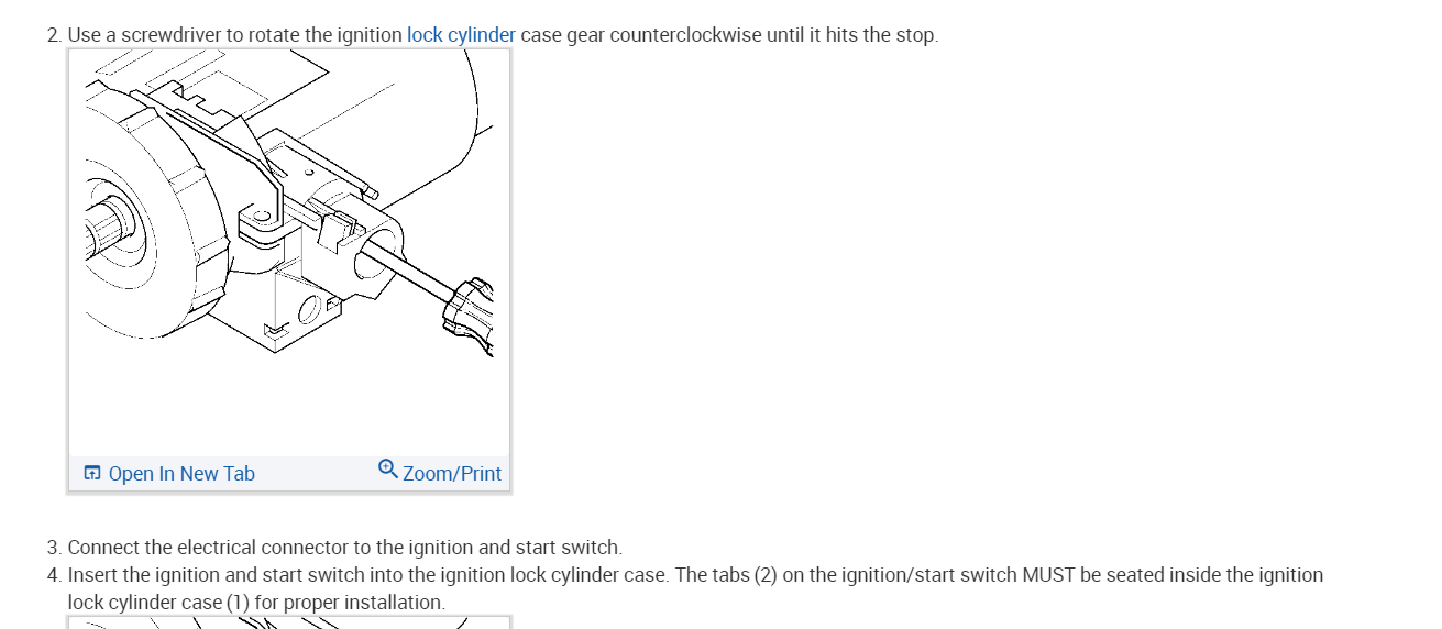

Here is how to change out the ignition switch and instructions on how to replace the ECM correctly. Check out the images (below). Let us know what happens and please upload pictures or videos of the problem so we can see what's going on.
