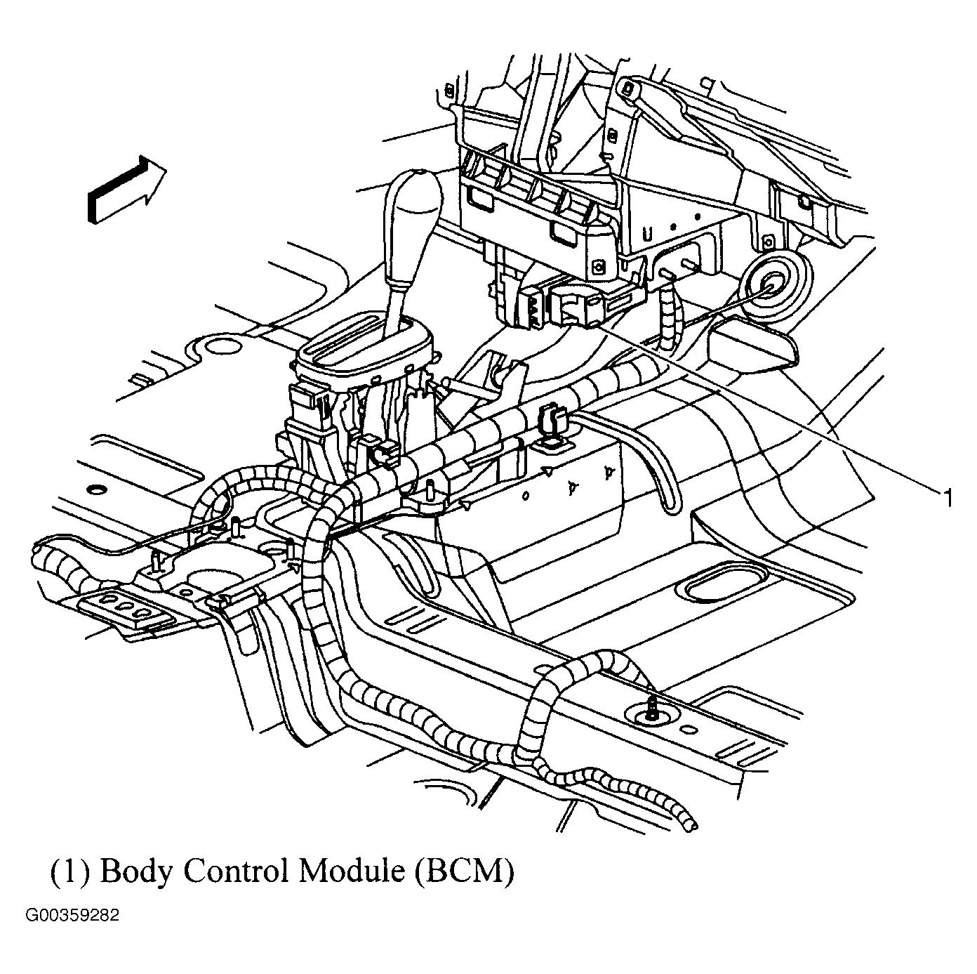

Since the brake transmission shift lock is normally on the same circuit as the stoplamps, see if the stoplamps work and if not, check the stoplamps fuse.
Feb 7, 2018 at 7:42 AM
PATENTED_REPAIR_PRO
CERTIFIED EXPERT
1,853 POSTS
Actually I looked up the fuses, they are the 'wiper sw" fuse and the "BCM elect" fuse both in the body control module, located at lower center of dash.
