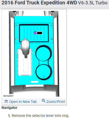

This is actually a common issue with the Expeditions and F150s.
When you put the vehicle in park there is a switch that gets activated by the shift lever, which releases the key from the ignition. It's a safety mechanism, preventing the key to come out while not in park.
Sometimes that switch gets loose and when you put in part it does not engage it.

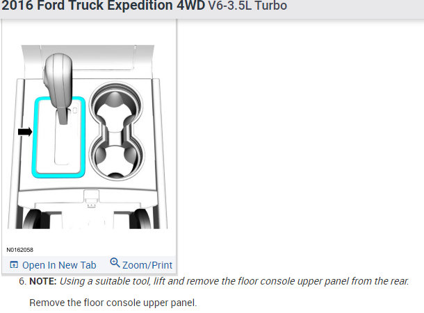

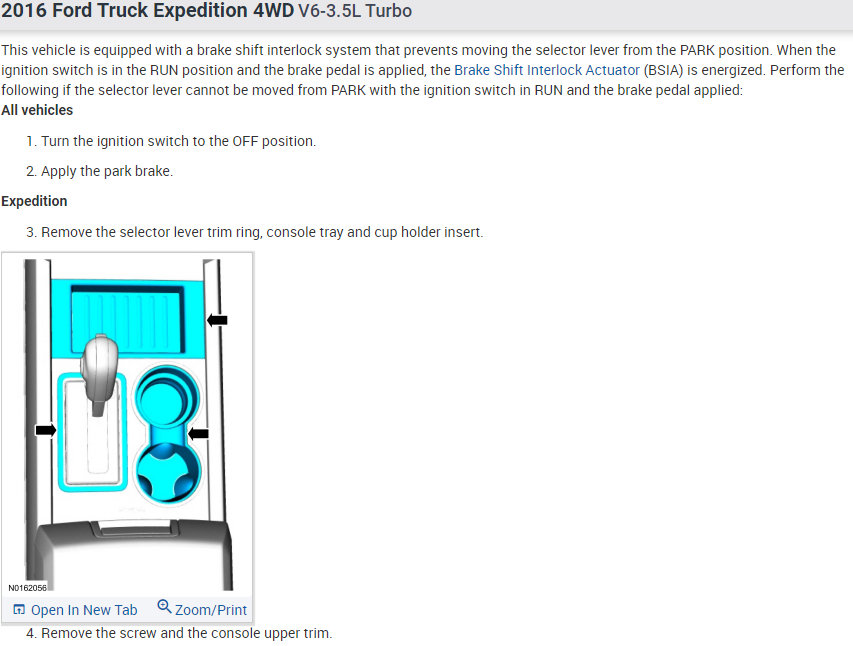

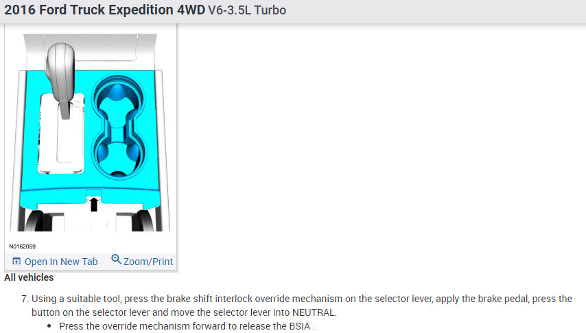

I have also attached the removal instructions for the console that you will have to remove to access the area.
Let me know if you have any questions.
