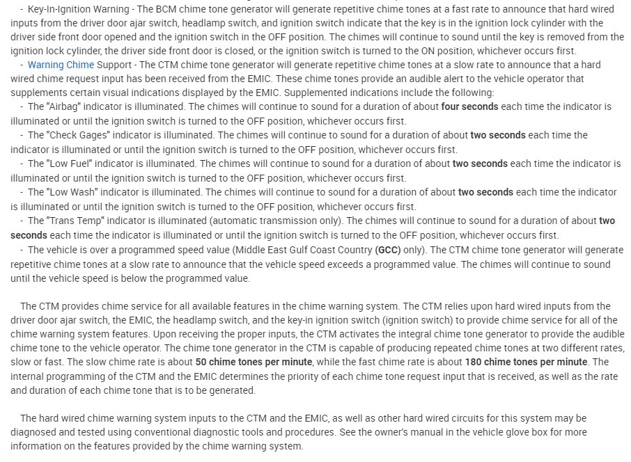

Hi JJ,

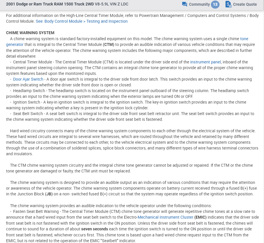

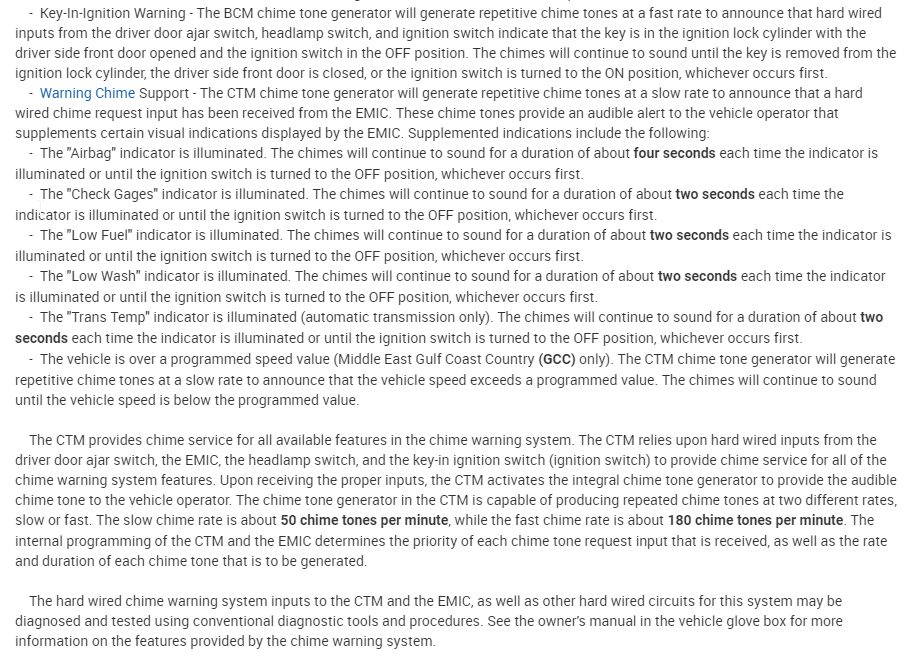

I attached the system description which gives a pretty detailed account of why this chime goes off. Give it a read (twice if needed, like me) and then apply it to what is happening.
Based on what you are saying if the chime is the slower chime described then it is either telling you that the CTM thinks the door is ajar, keys are left in the ignition, or the seat belt is unbuckled.
I am not sure but I think the door ajar only happens if the keys are in the ignition. If that is correct then it is unlikely it is the door switch. If not, then it is just as possible as the ignition switch thinking the keys are in the ignition. I am pretty confident that it is not the seat belt chime.
If the noise stops when you turn the ignition, I would suspect the ignition switch because under normal operation, I believe the door ajar will continue the chime even when the ignition is on.
Basically, there are a couple things to test but I suspect the ignition switch is your issue. Let me know what you find.Thanks

Thank you for reply! The chime sound is identical to fast rate chimes when I have key in ignition and open driver door,but the door is closed and key is not in the ignition. The only way for me to stop chime is to insert key and turn to the "on" position. So do I have to replace ignition key cylinder to fix this? Is it possible to just disable the alarm? Disabling alarm seems like it would be easier and cheaper as long as it doesn’t disable other alarms. Replacing key cylinder means I’d need a different ignition key which is different than door keys, right? Again, thanks for the reply. Can’t wait to silence this annoying alarm, especially when I’m trying to sleep in our camper.
Jul 15, 2019 at 4:32 PM
Unfortunately, the chime is coming from the central timing module itself so the only way to disable it would be to disconnect this module and I am not sure what the complete result would be. I do know that this would disable all the alarms including the seat belt, door ajar, headlights are on with no key in ignition, and the key left in ignition.

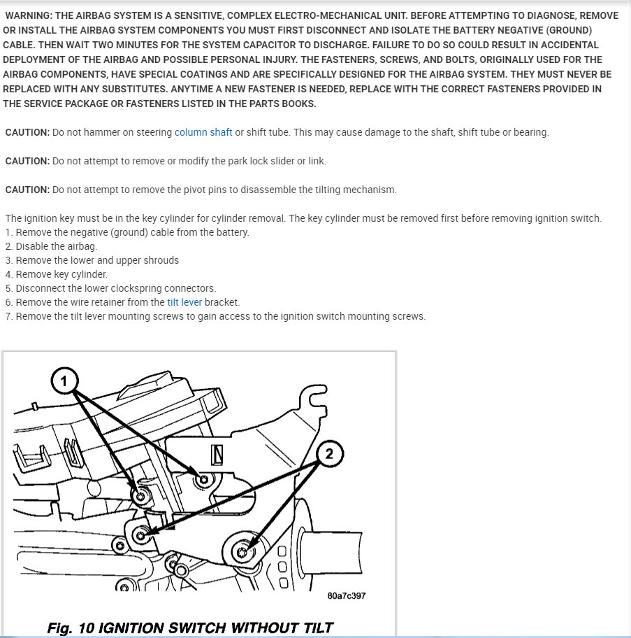

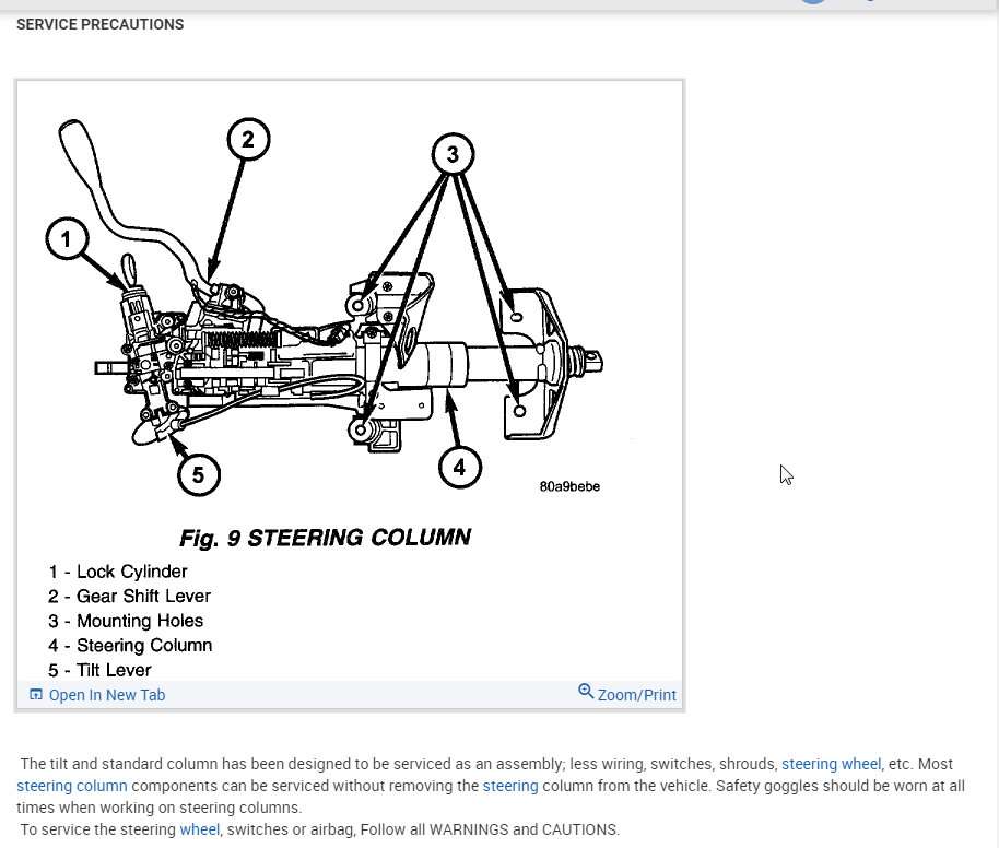

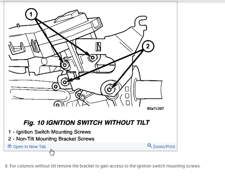

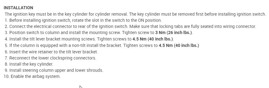

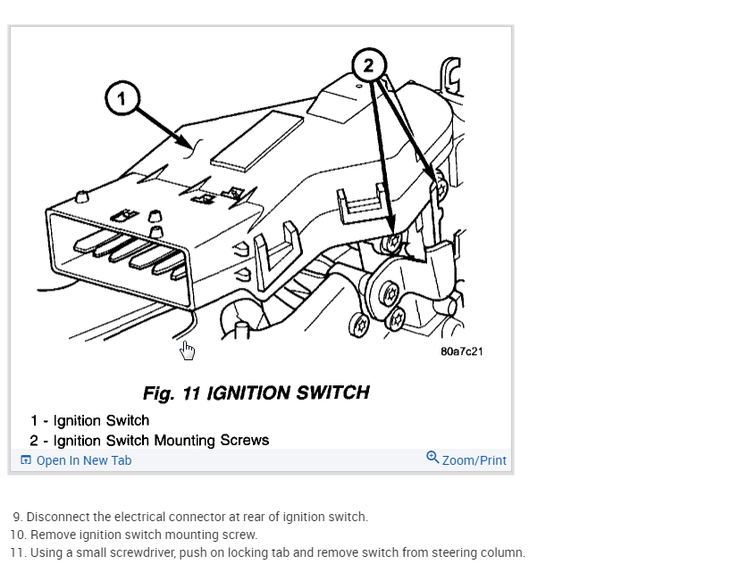

If you change the ignition switch then you can code the new one to match your key so you don't have to change everything. If you haven't done this before, I would recommend having it done because if it is off then your key won't work and obviously your vehicle will be disabled where ever it is until that is fixed.
Sorry I don't have better news, but the most likely cause is the ignition based on this information and the best course of action I would take is to replace the ignition.
