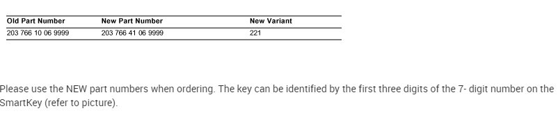

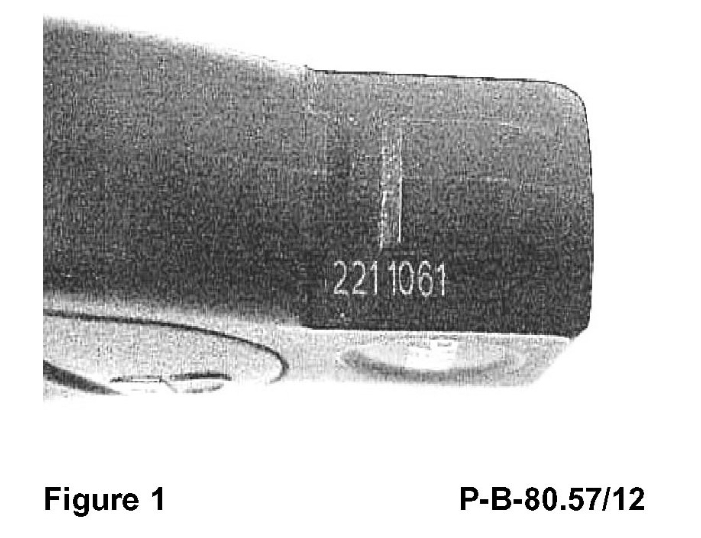

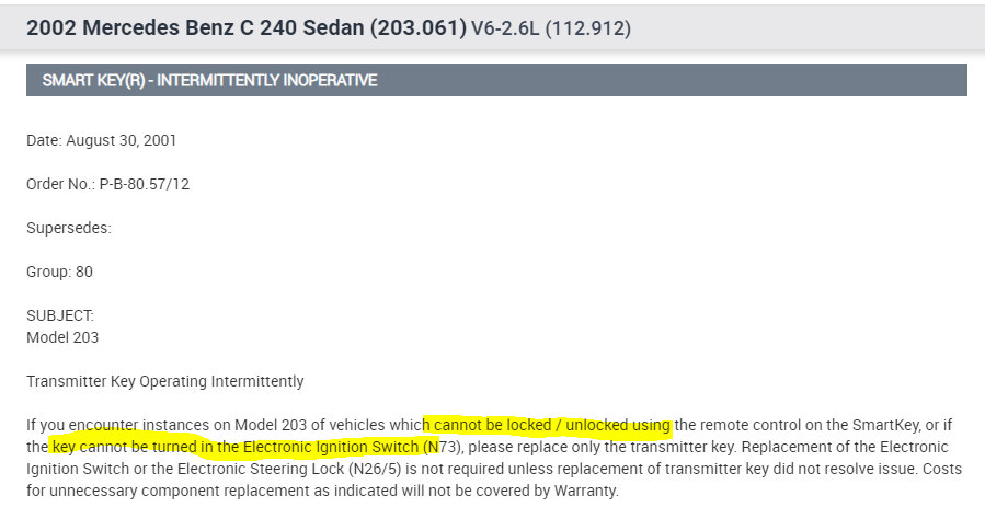

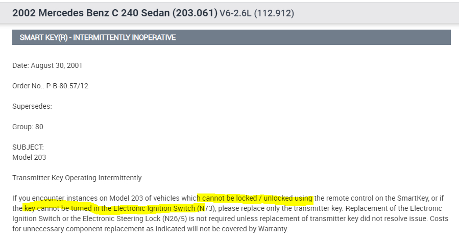

There is a technical service bulletin (TSB) related to this problem. The transmitter key needs to be replaced.
If you have a spare key, see if it works. Also, take a look at the attached pics below of the TSB listed.
Let me know if this helps.
See pics below.
