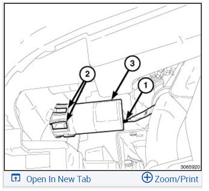

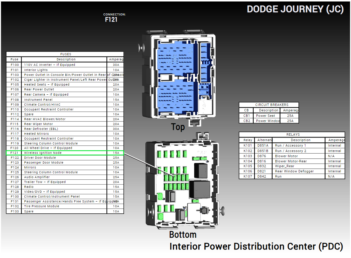

The "aftermarket remote start", did this problem happen ever since it was installed? Let's check the fuse #f121 which runs the system here is a guide to help and I have included the fuse location in the diagrams below. See if the fuse has power as well.
I have seen the keyless ignition node module go out and cause this problem, but to be sure we should do a CAN scan. You can get a CAN scanner (Controller Area Network) which will work on most cars from Amazon.
Here is a video to show you how:
https://youtu.be/u-4syLc-ifQ

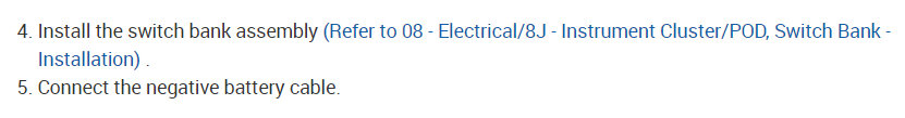

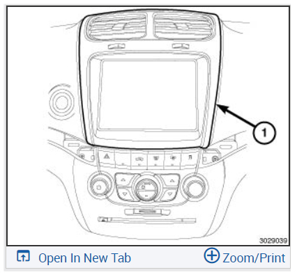

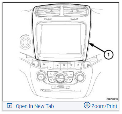

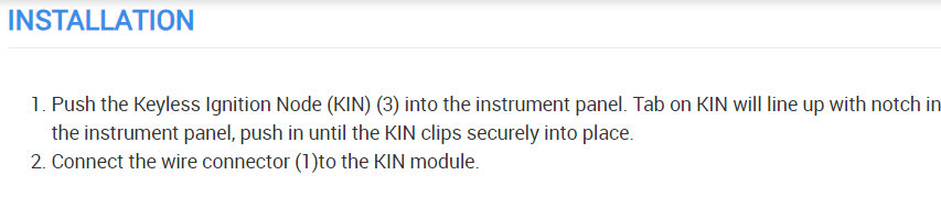

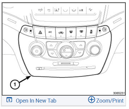

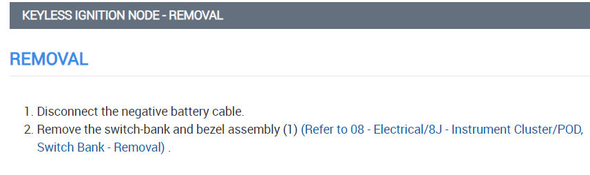

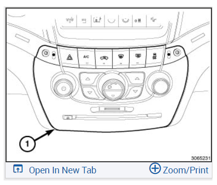

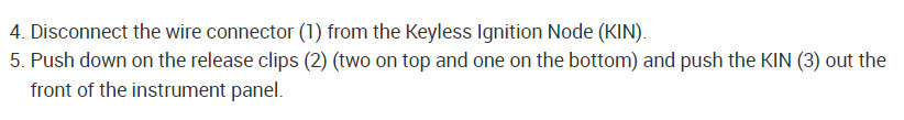

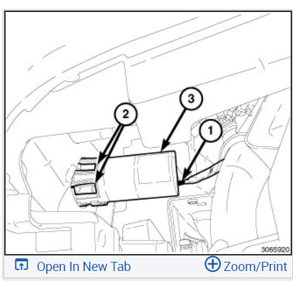

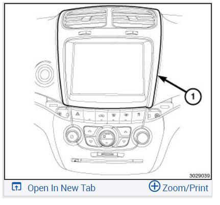

Here is how to replace the keyless ignition node module in case a code comes up for it. Check out the images (below). Please upload pictures or videos in your response to the problem so we can see what's going on.
