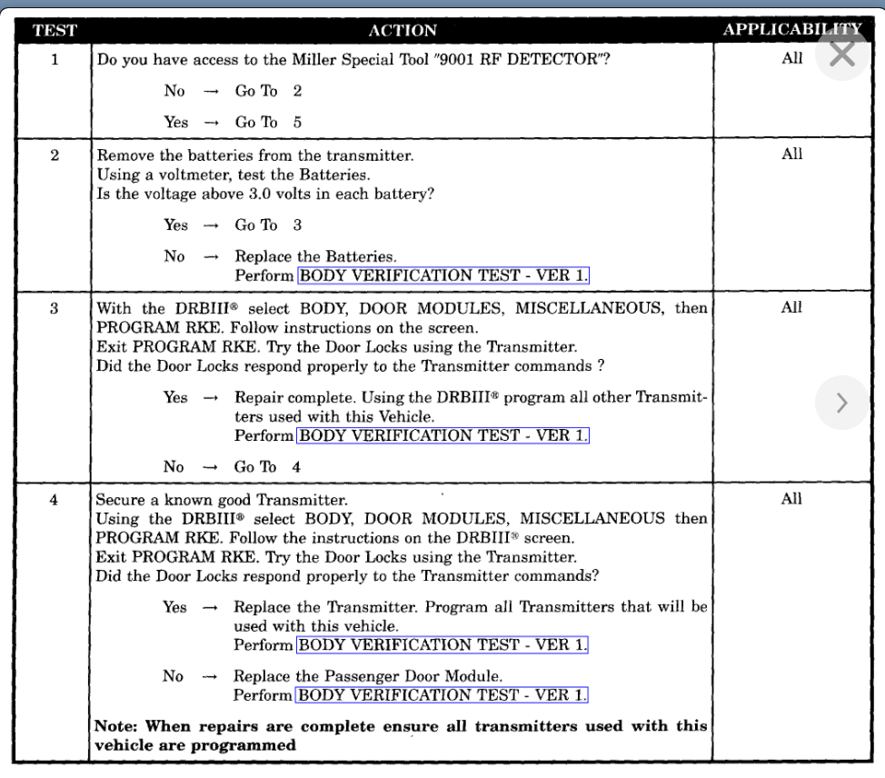

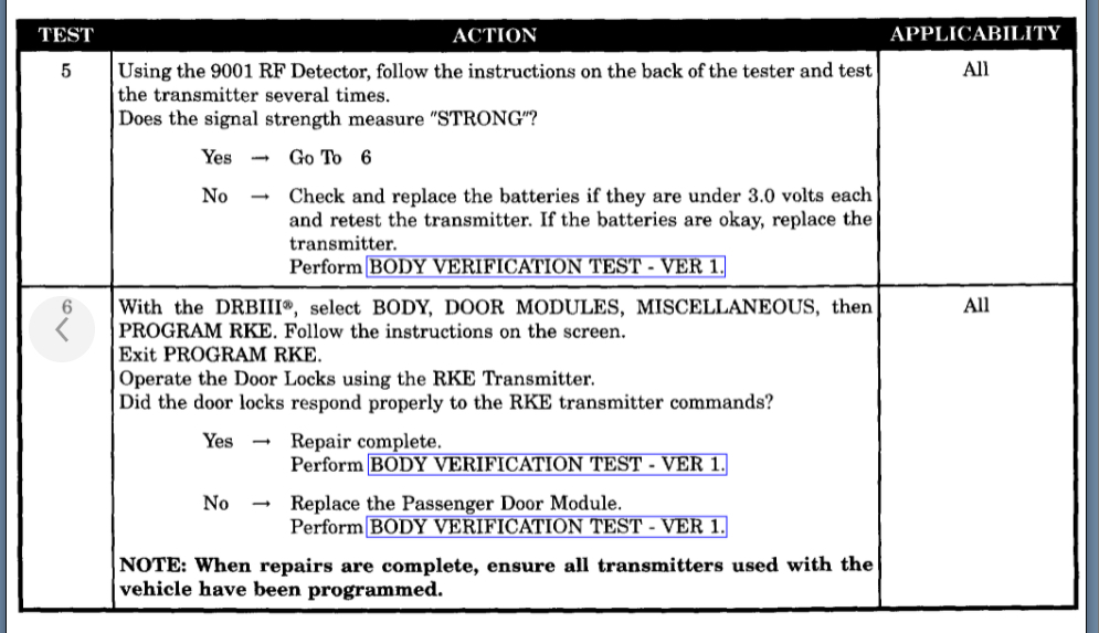

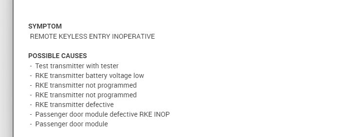

There are a couple of issues that can cause this, but we are going to have to run through some testing to figure this out.
Unfortunately, this is going to require some tools that you most likely don't have and will not find.
There may be some online, but it is not worth buying them for a single use. It would be better to pay a shop to do this testing unless you are willing to sell the tool and recoup some of the money.
https://www.2carpros.com/articles/how-to-re-program-a-key-remote-fob
I am attaching the info below from the manual which will walk us through this. Just because you replaced the batteries, we can't rule out a transmitter issue. However, if the transmitter is not the issue, then it is most likely the passenger door module.
Please let me know what questions you have on this, and we can go from there.

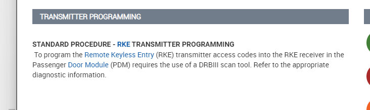

Thanks. Do I have to get it reprogrammed?
Apr 3, 2022 at 10:46 AM
Yes. You will have to go through the programming process which will require a scan tool. However, I would contact a local locksmith. They are the cheapest and most have the tool to do this.
