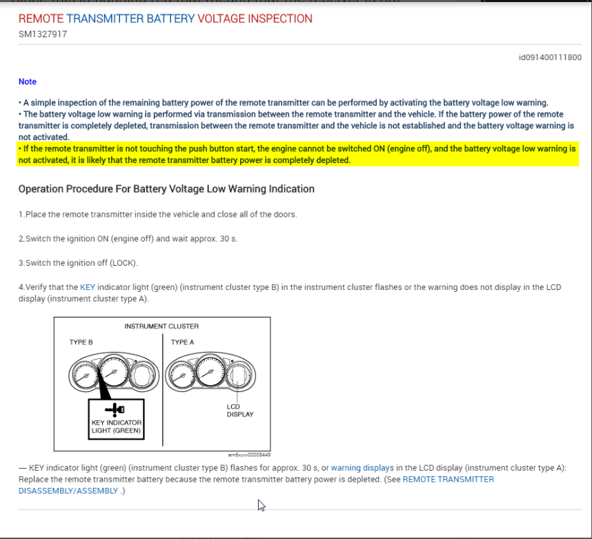

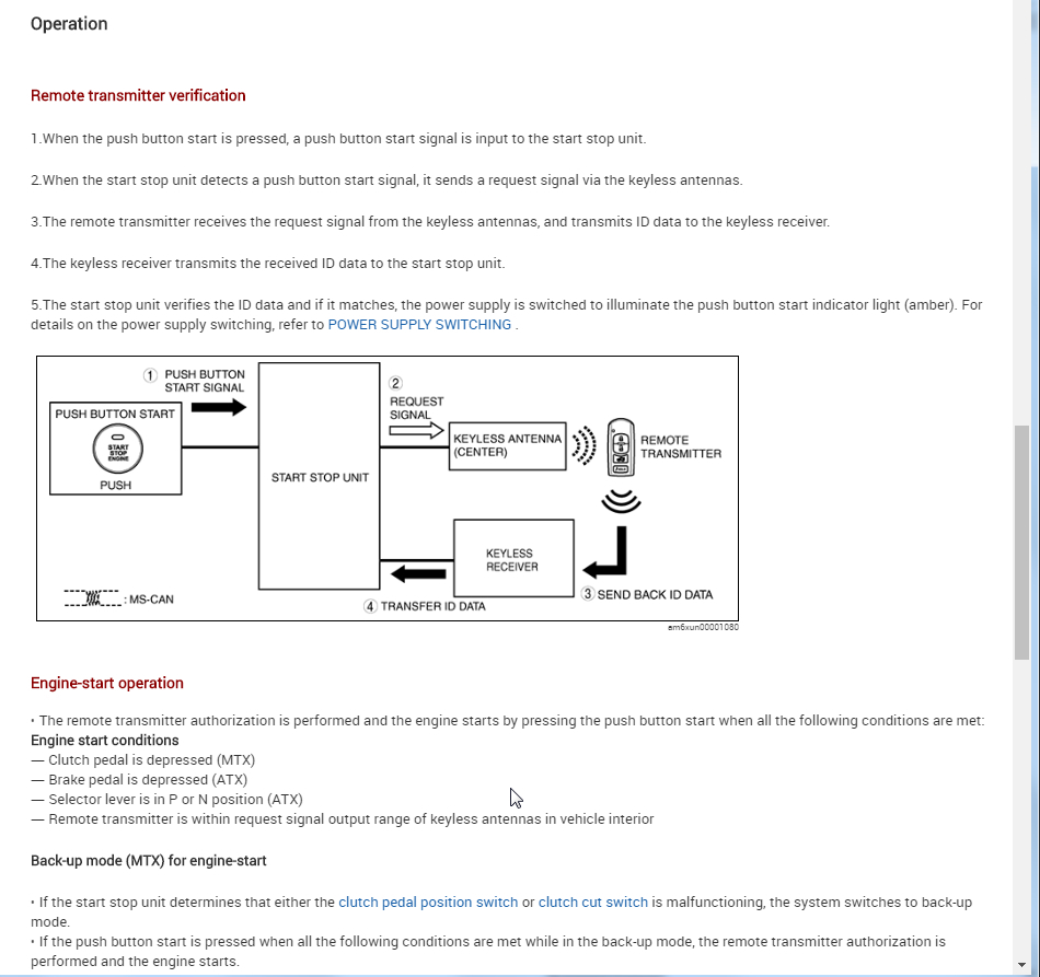

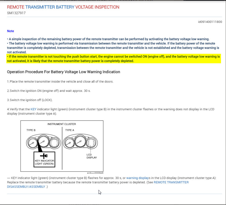

I see the light when I press the fob button but it wont unlock or lock the car and when I'm in the car the car wont start even if I depress the start button using the fob itself. I have used my normal daily fob and my spare and have the same issue. it still starts it's just I have to try starting it multiple times to have it start.it does not try to turn over or anything until the time is works and it turns over no problem.
