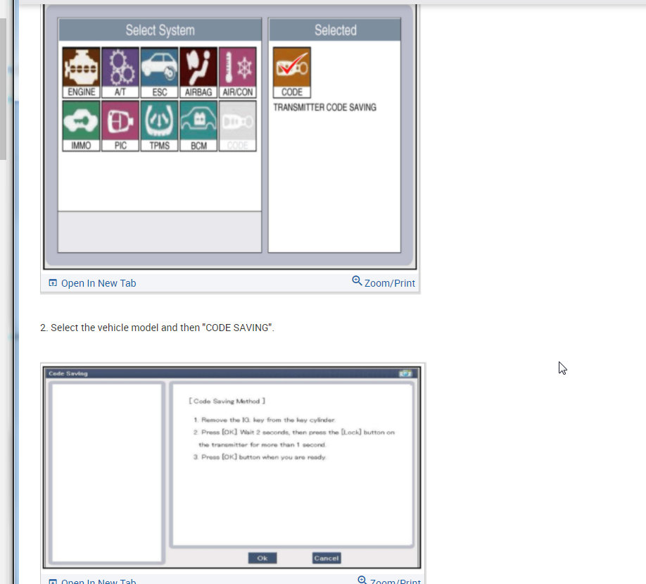

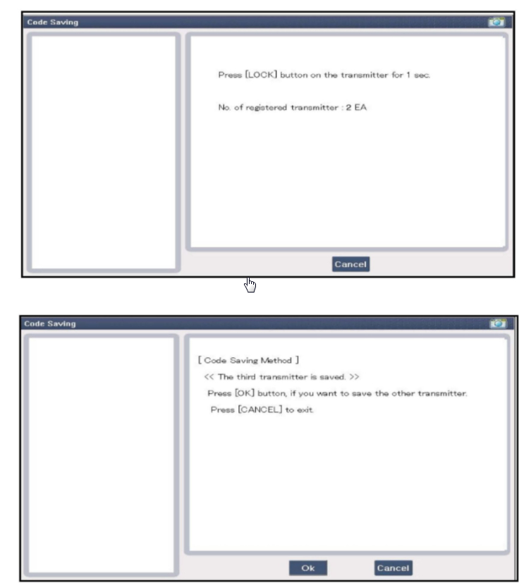

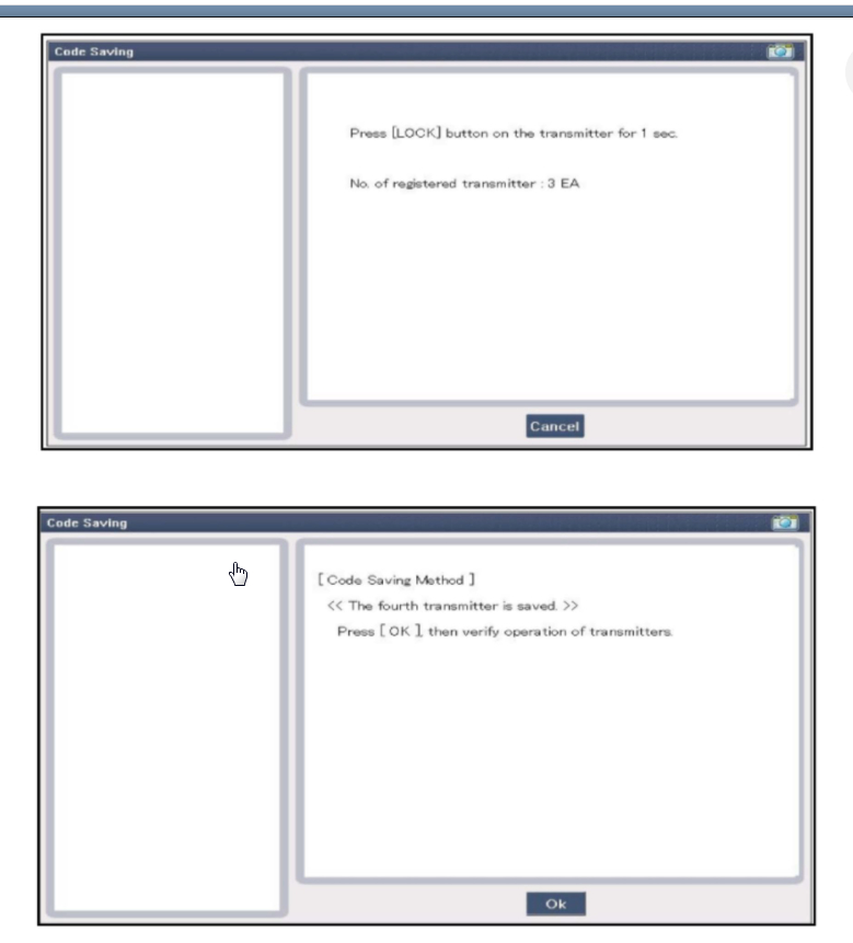

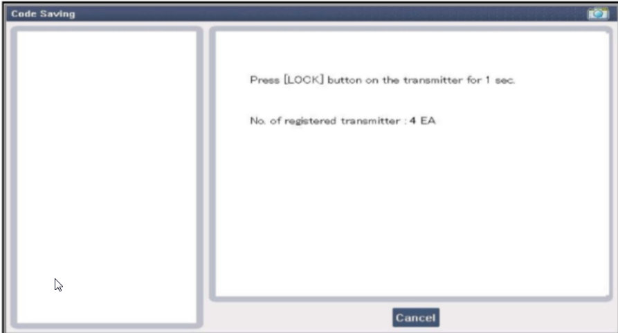

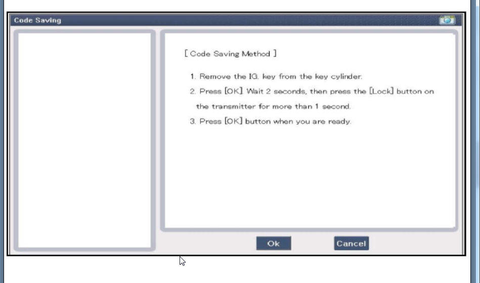

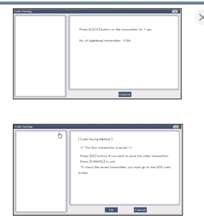

I attached the process below on how to program a new remote fob if you or someone else needs that. However, this requires a scan tool so it may not help you at this point.
Please let us know if you have other questions. Thanks
