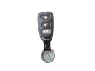

Could you possibly find a picture of the key fob?

Just so I know which one to purchase when I do take it.

It should look like this. Or search Kia #954302F950 There are aftermarket ones as well. That's why I suggest a locksmith as they might have one and be cheaper.
