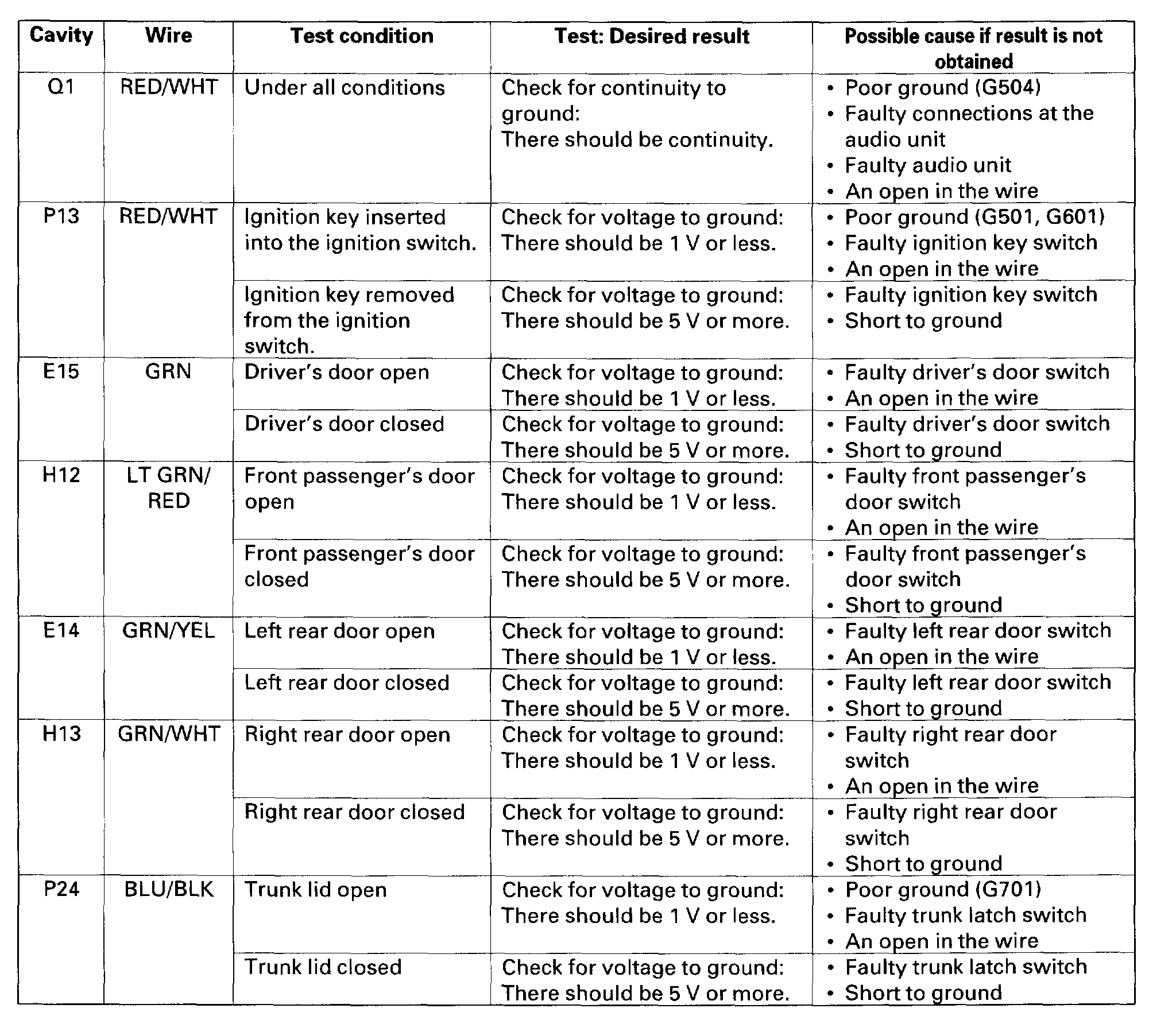

IF that doesn't help and you know the battery is good in the fob, we need to check the brains of the system. The key-less transmitter depends on a multiplex integrated control module to work. With that being said, testing it is somewhat time consuming. Here are the directions. The attached pictures correlate with these directions.

Control Unit Input Test
1. Before testing the keyless entry/security control functions, troubleshoot the multiplex integrated control system.
Multiplex Integrated Control Unit
2. Remove the left kick panel.
See Picture 1
3. Disconnect the under-dash fuse/relay box connectors.
NOTE: All connectors are wire side of female terminals.
4. Inspect the connector and socket terminals to be sure they are all making good contact.
- If the terminals are bent, loose or corroded, repair them as necessary, and recheck the system.
- If the terminals look OK, go to step 5.
See Picture 2

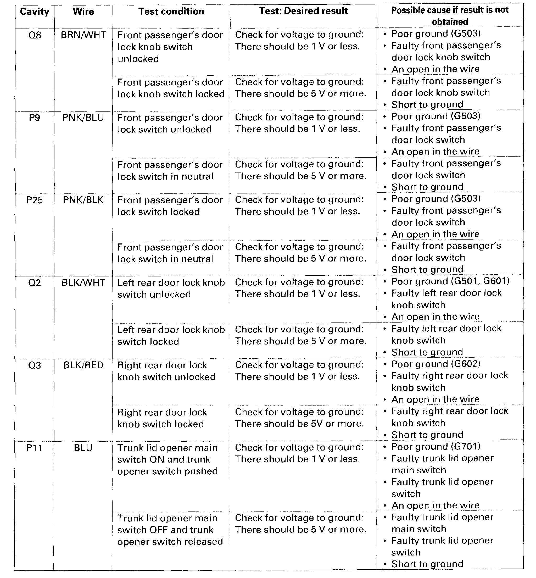

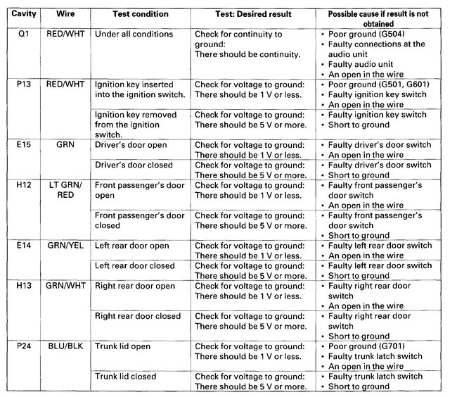

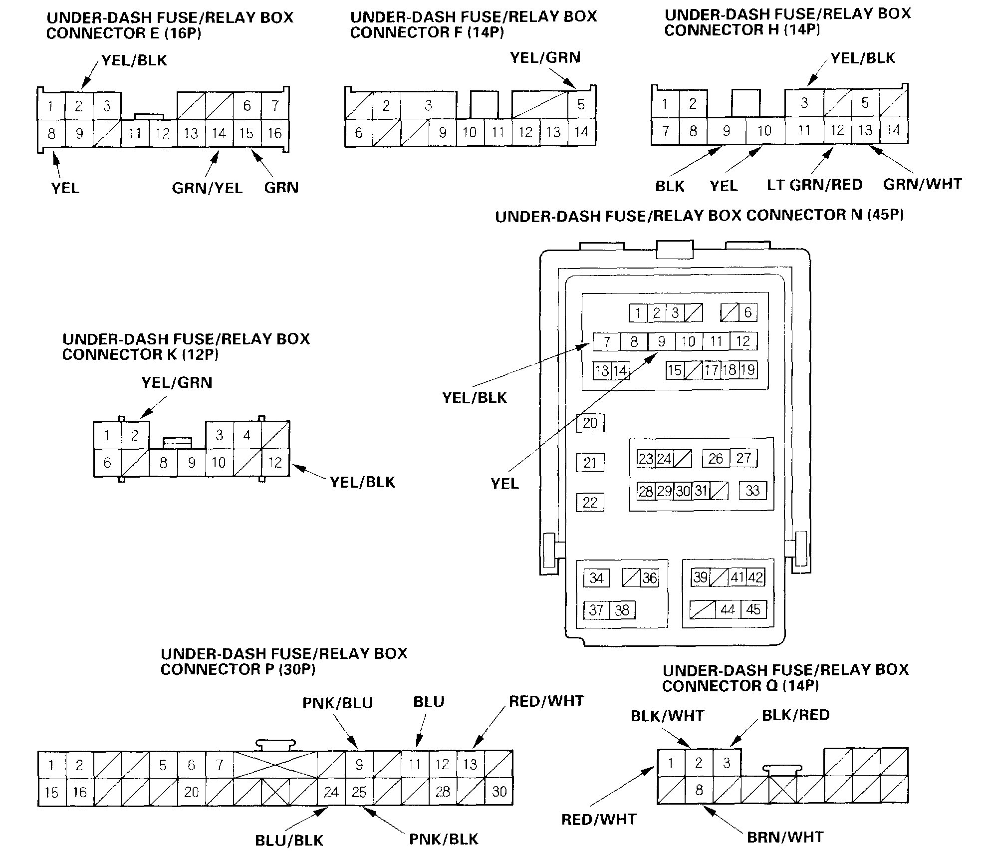

5. With the connectors still disconnected, make these input tests at the connectors.
- If any test indicates a problem, find and correct the cause, then recheck the system.
- If the input tests prove OK, go to step 6.
See Picture 3
See Picture 4
6. Reconnect all connectors to the under-dash fuse/relay box, and make these input tests at the appropriate connectors on the under-dash fuse/relay box.
- If all the input tests prove OK, go to step 7.

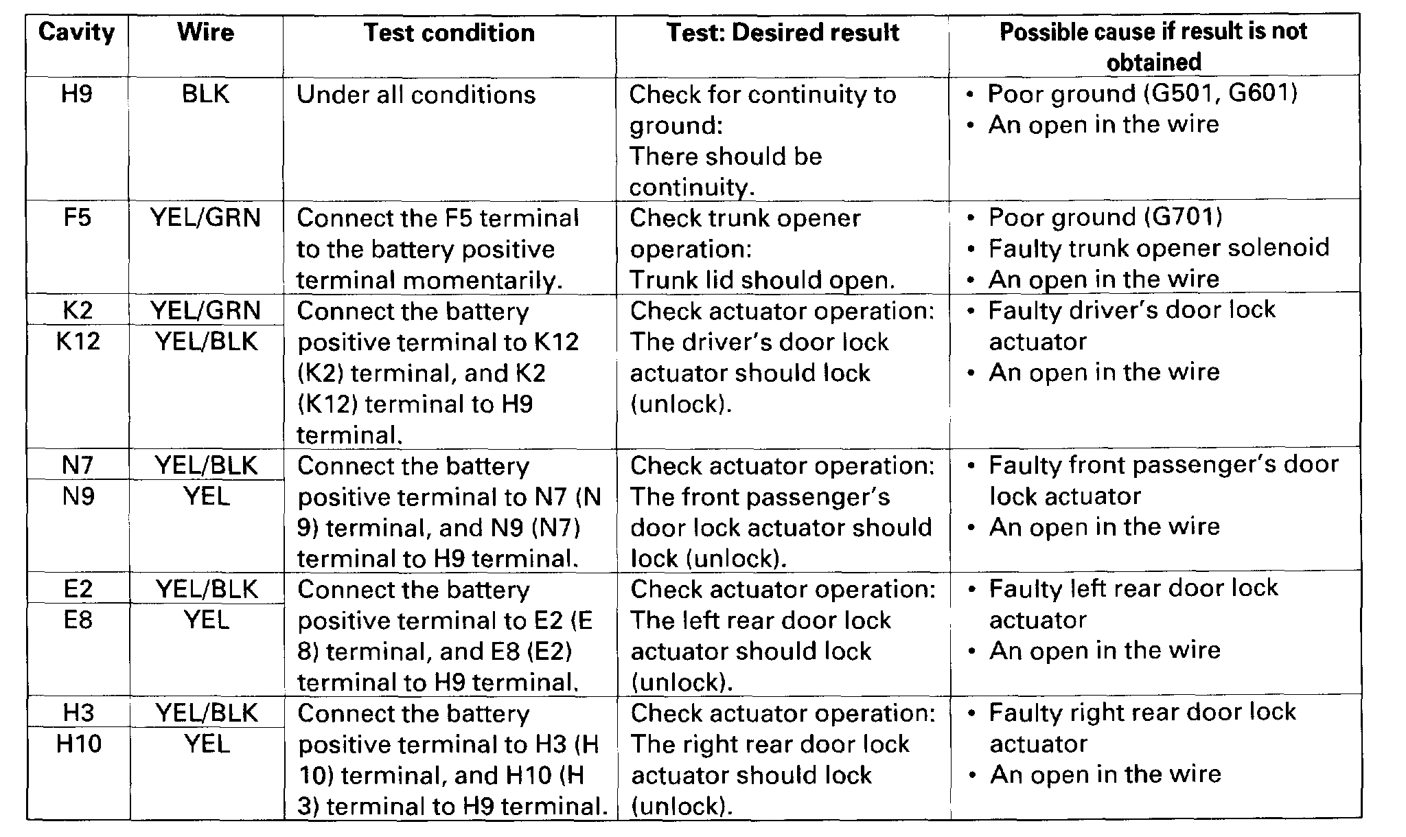

Door Multiplex Control Unit

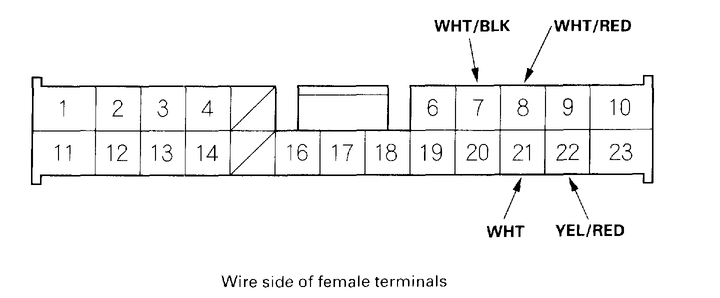

7. Remove the driver's power window switch panel.
See Picture 5

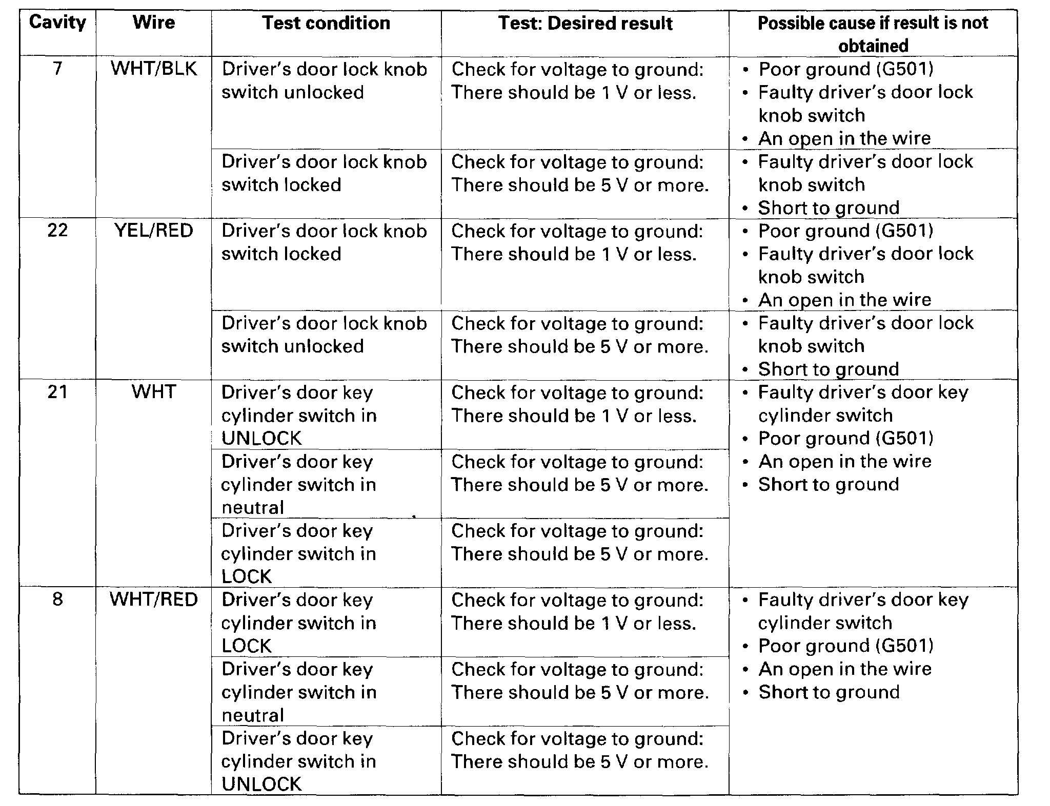

8. Disconnect the 23P connector from the power window master switch.
9. Inspect the connector and socket terminals to be sure they are all making good contact.
- If the terminals look OK, go to step 10.
See Picture 6
10. Reconnect the connector to the door multiplex control unit, and make these input tests at the connectors.
- If all the input tests prove OK, go to step 11.
