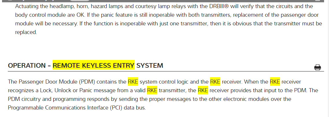

The key fob does not work. key fob is good, both are good. is there a fuse and relay to power the receiver and where is that located?
Sep 2, 2020 at 12:10 PM (Merged)
SCGRANTURISMO
  • 4,897 POSTS

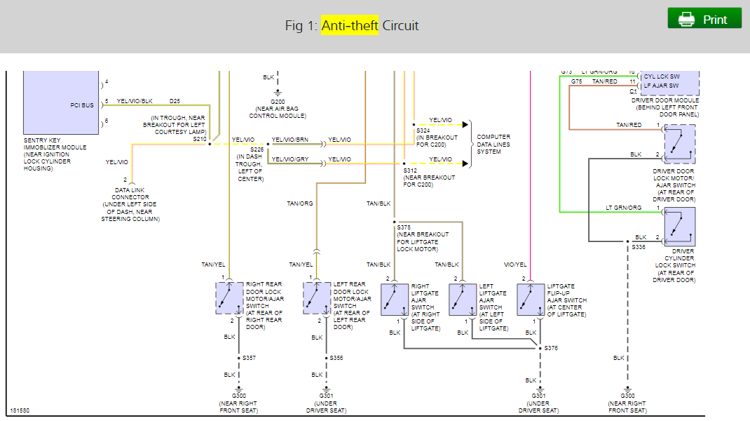

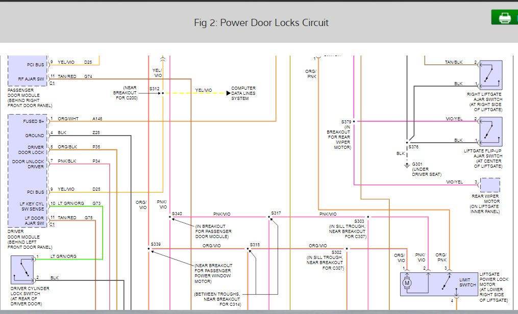

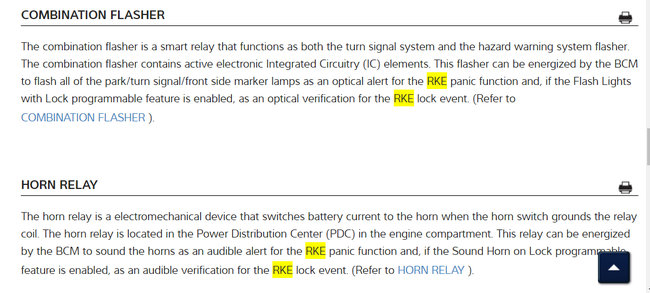

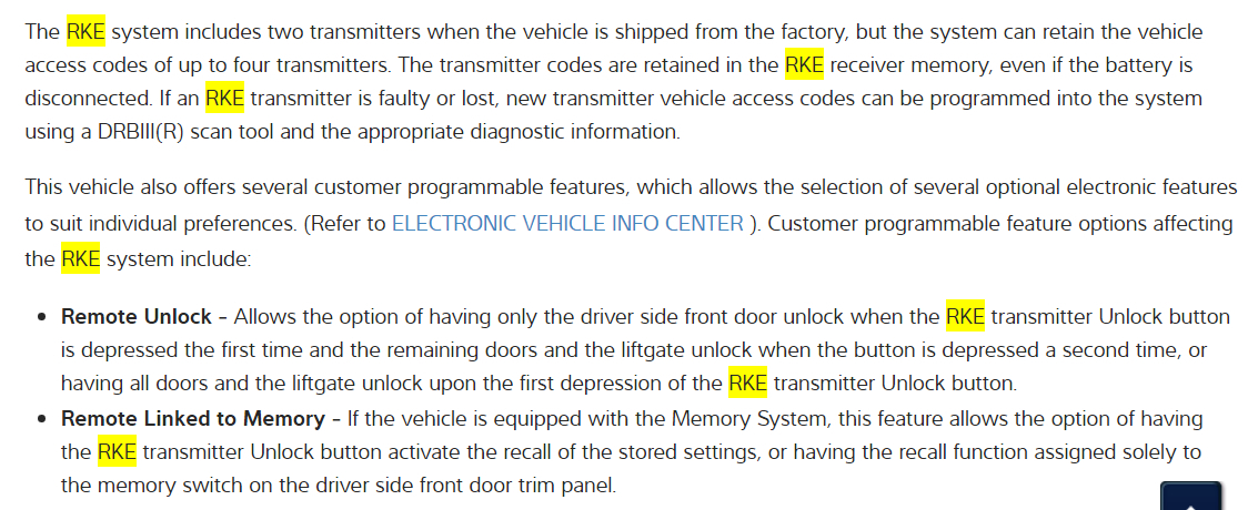

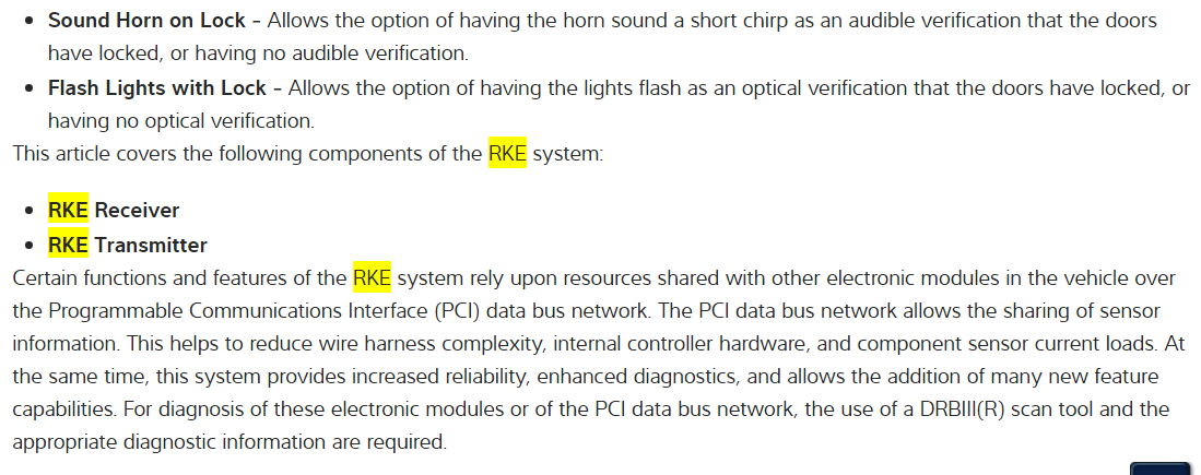

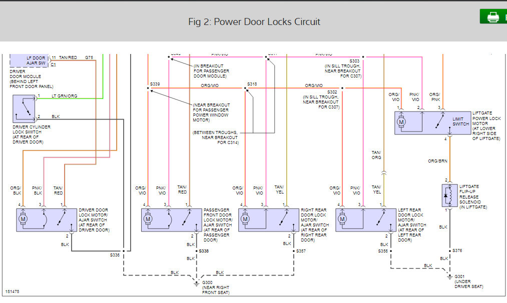

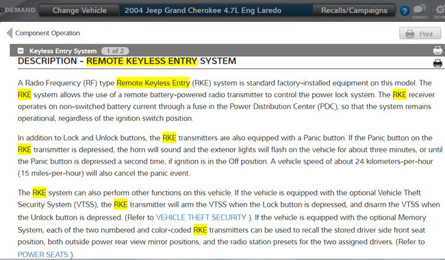

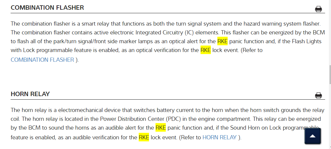

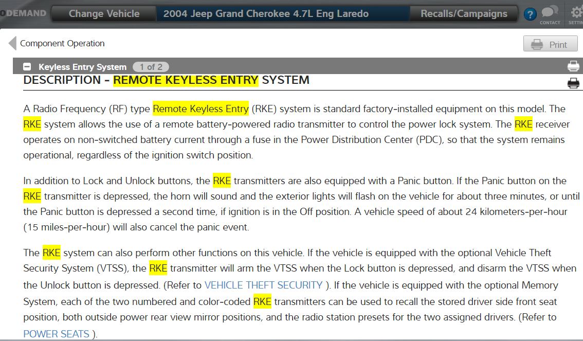

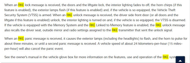

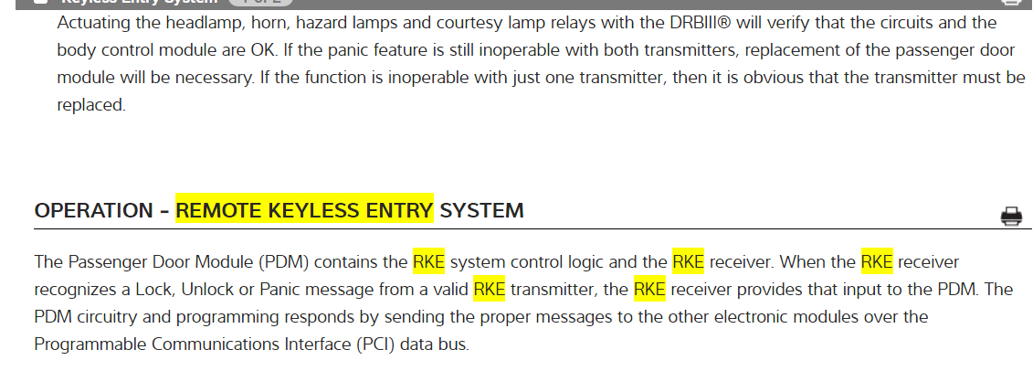

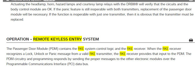

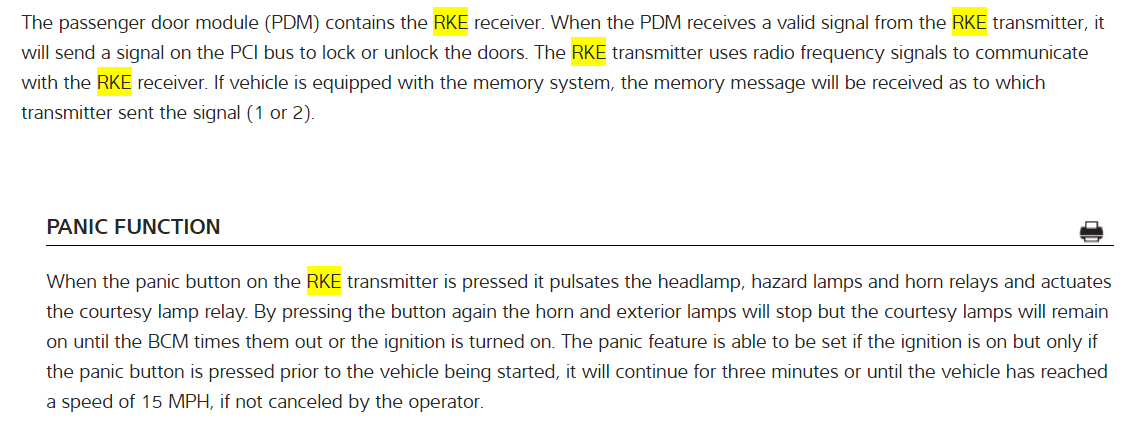

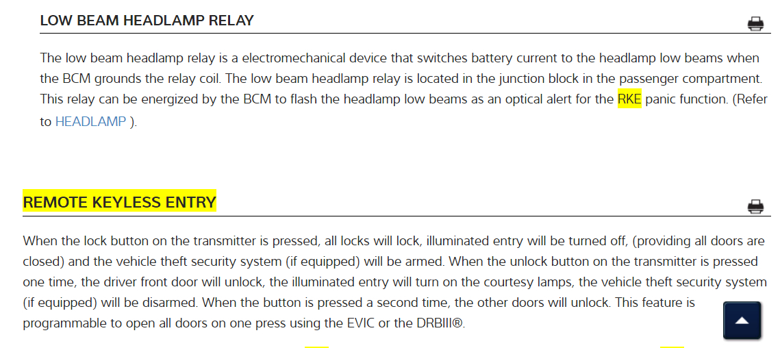

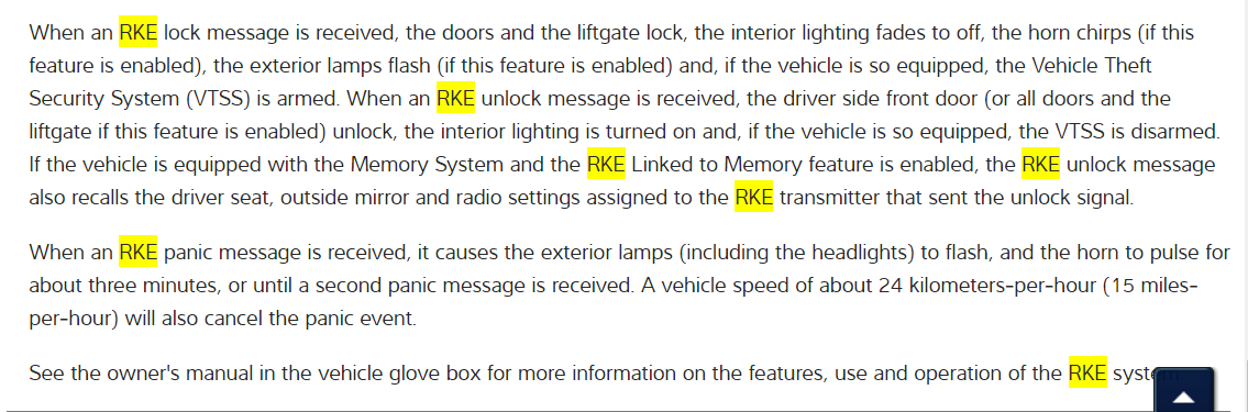

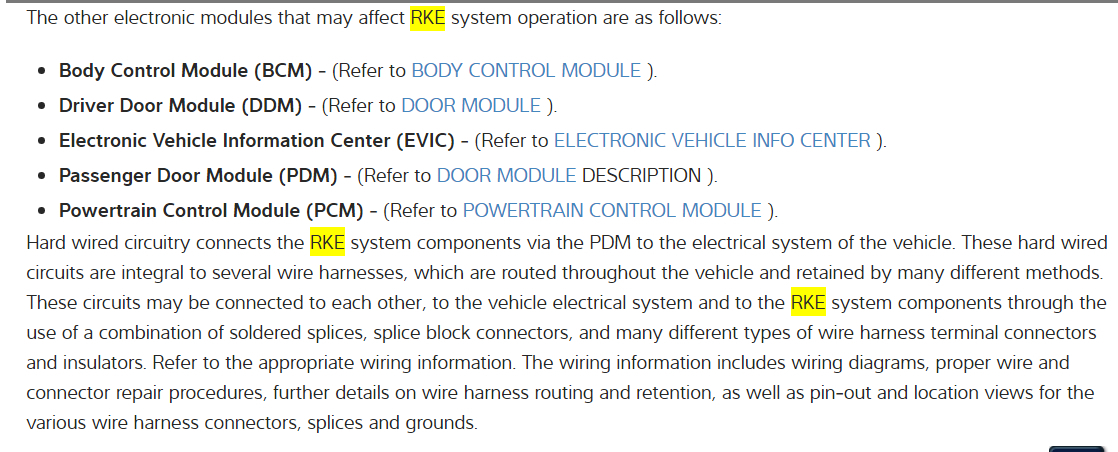

I have included all the information you will ever need on your vehicle's Remote Key-less Entry System (RKE) in the diagrams down below. Please, don't hesitate to ask should you have another question for us. That's what we are here for. Enjoy.

how do u program key fobs
KHLOW2008
  • 41,814 POSTS
PROGRAMMING
TRANSMITTER PROGRAMMING
Up to 4 Transmitter Identification Codes (TIC's) can be programmed into receiver at any given time.
1. Open driver's door of vehicle. Leave it open through the programming procedure.
2. Move mechanical door lock lever to the LOCK position.
3. Insert ignition key and turn it to RUN position.
4. Turn ignition to RUN position. Within 20 seconds, aim a transmitter at receiver dome and press lock button for at least 5 seconds. Once receiver accepts programming code the driver's door will unlock.
5. Once first transmitter has been programmed, additional transmitters (up to 4) may be programmed into receiver. Within 20 seconds of the previous transmitter programming, move the mechanical door lock lever to LOCK position. Aim another transmitter at receiver dome and press LOCK button for at least 5 seconds. The door lock will cycle again.
6. To lock the programmed codes into the receiver, the ignition must be turned off and back on within 20 seconds after programming the last transmitter's code. At that time, all previous codes are erased from the module.
© 2008 Mitchell Repair Information Co., LLC.

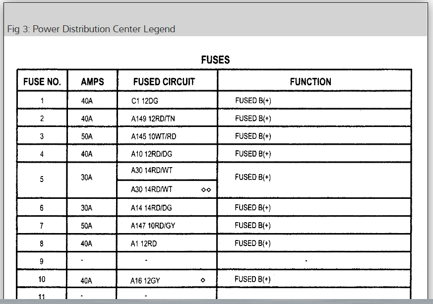

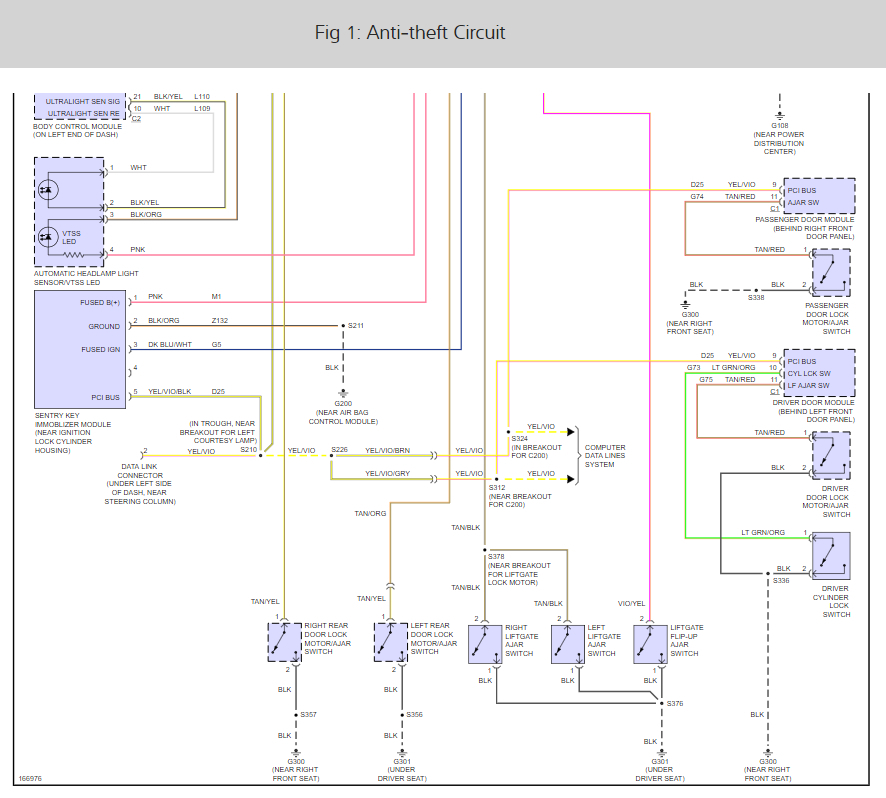

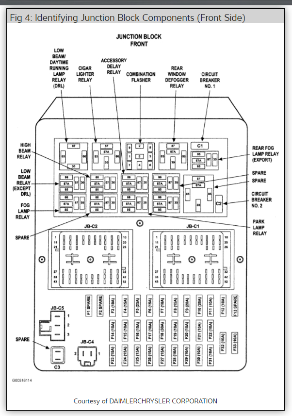

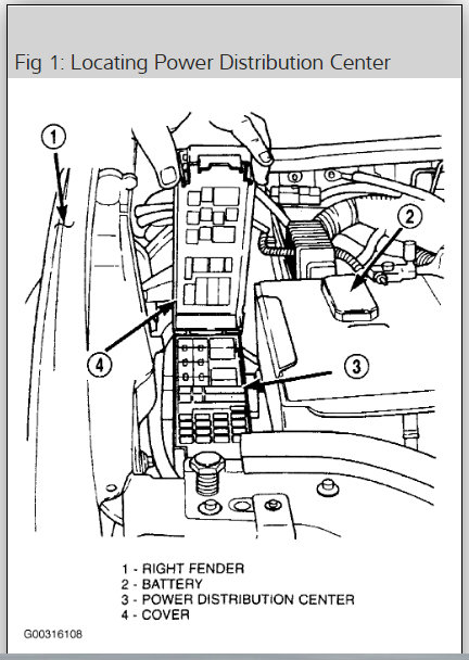

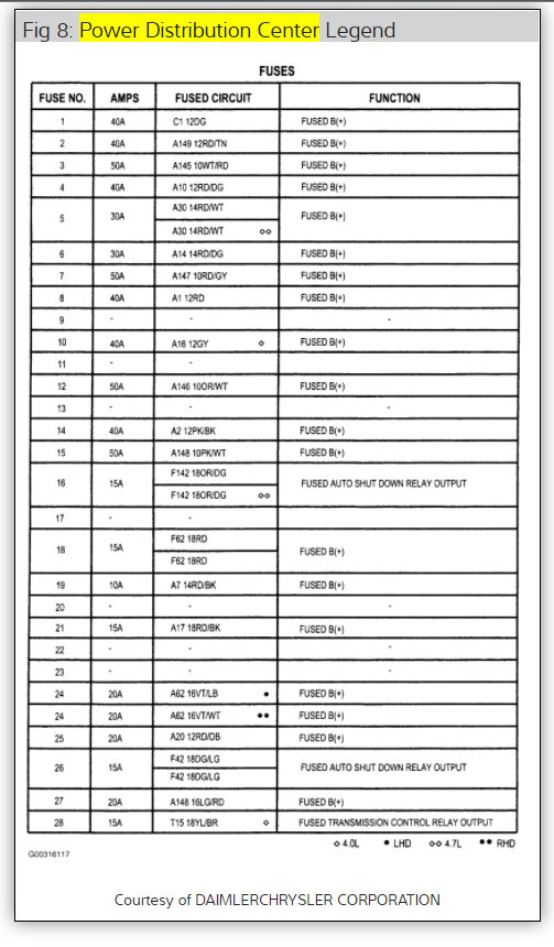

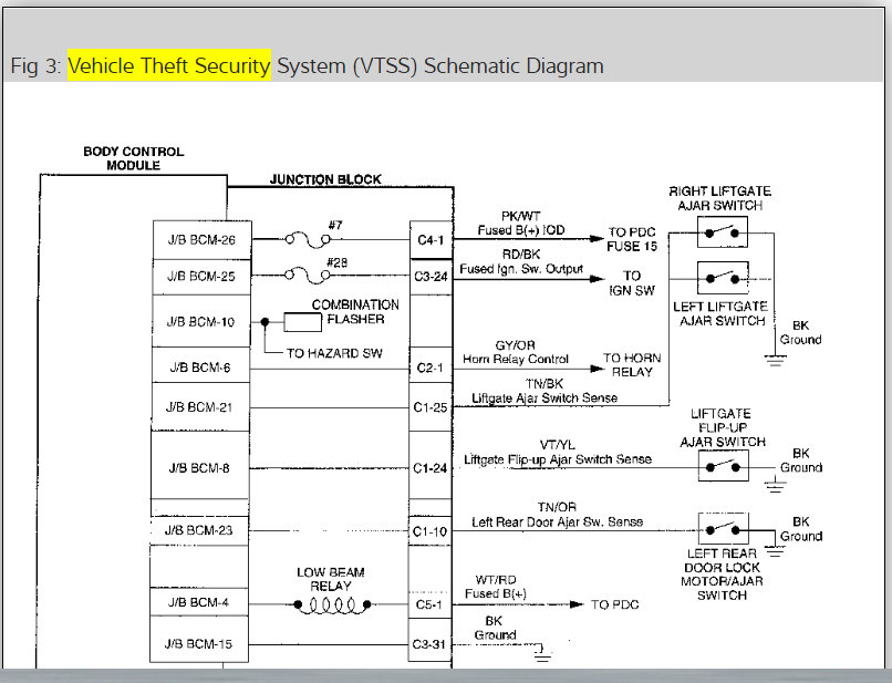

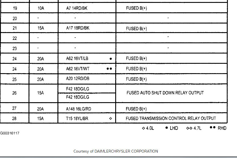

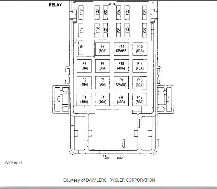

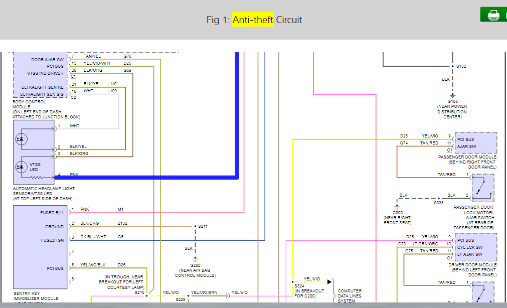

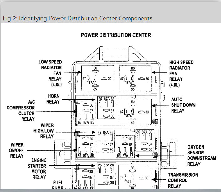

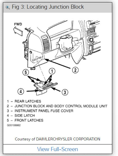

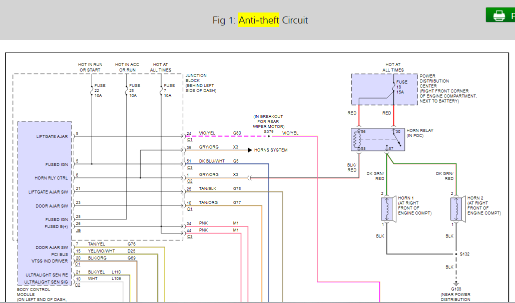

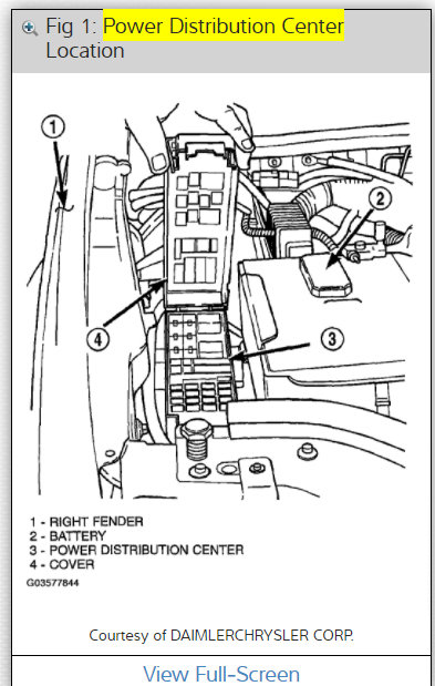

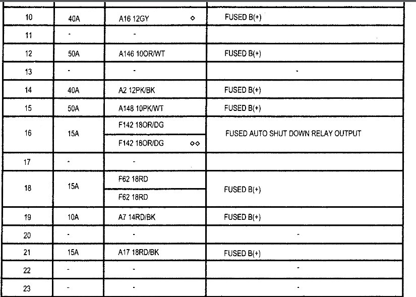

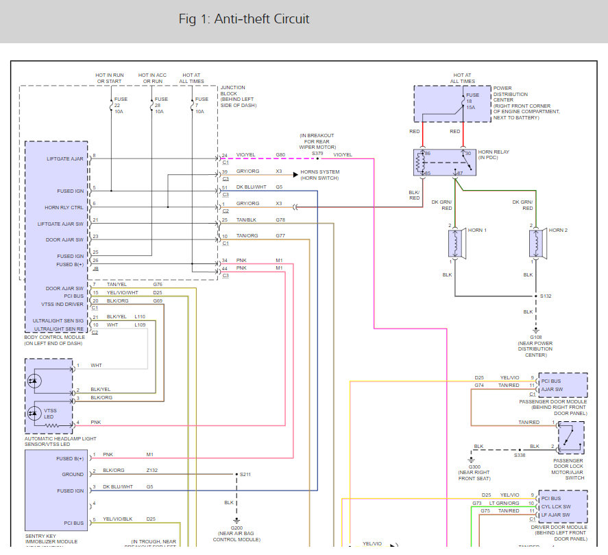

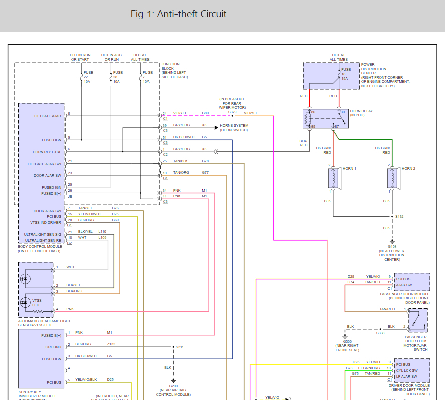

INTOTHEOCEAN30

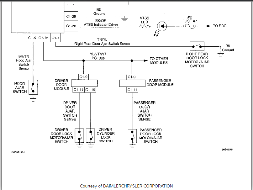

I have not had any problems out of my key or Jeep and then yesterday I went to put the key in and start it, and it will not start. The light on the dash with the key with a line through it is on. It is not trying to turn over or engage at all. However, my lights work inside and out as well as the alarm. Any ideas?
Sep 2, 2020 at 12:11 PM (Merged)
Yep, it sounds like the RF chip has gone bad in the key in which case I would use the spare or the system is out of sync and it just needs a hard reboot. Here is a guide that will help us get started:
INTOTHEOCEAN30
I tried all of the possible fixes listed, including ones not applicable to my make, with no success. The fob works fine, sets the alarm, locks the doors. But still when I insert the key into the ignition I just get the no key light and it does not even attempt to turn over. I have all my dash lights, windows will roll up and down, I can use the overhead too. There is no clicking or anything like that just as an FYI. Any other suggestions?

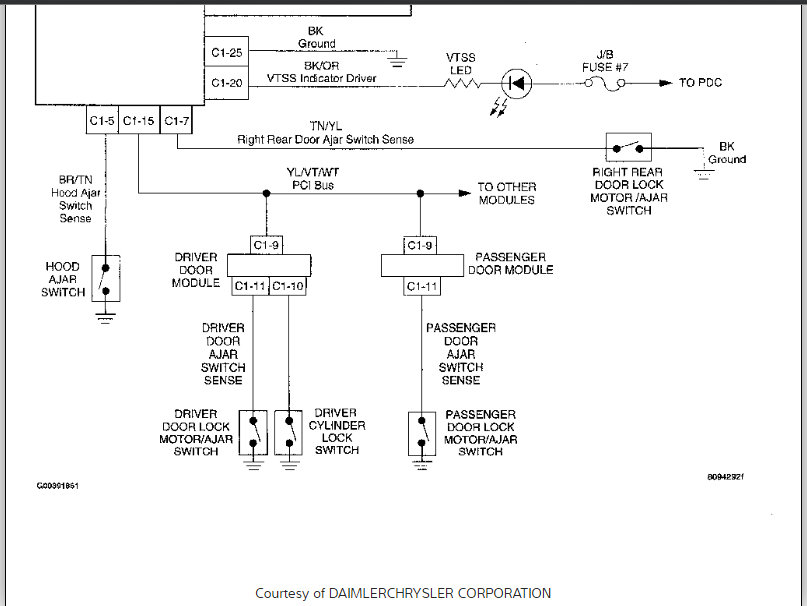

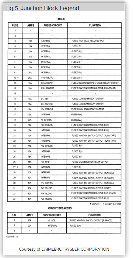

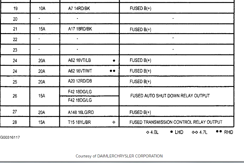

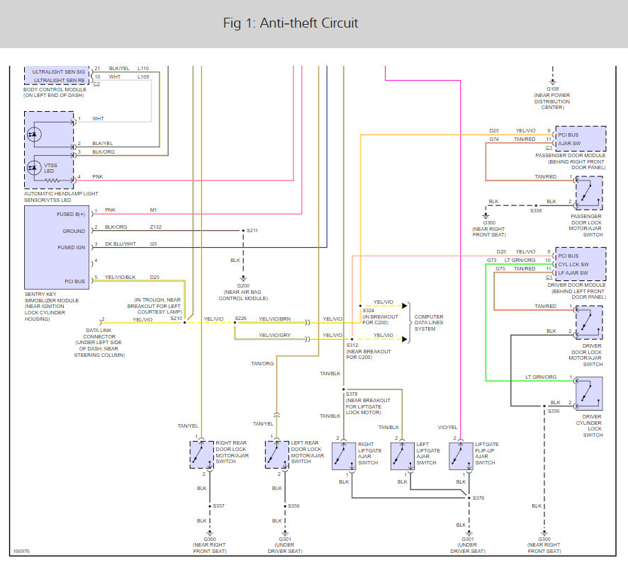

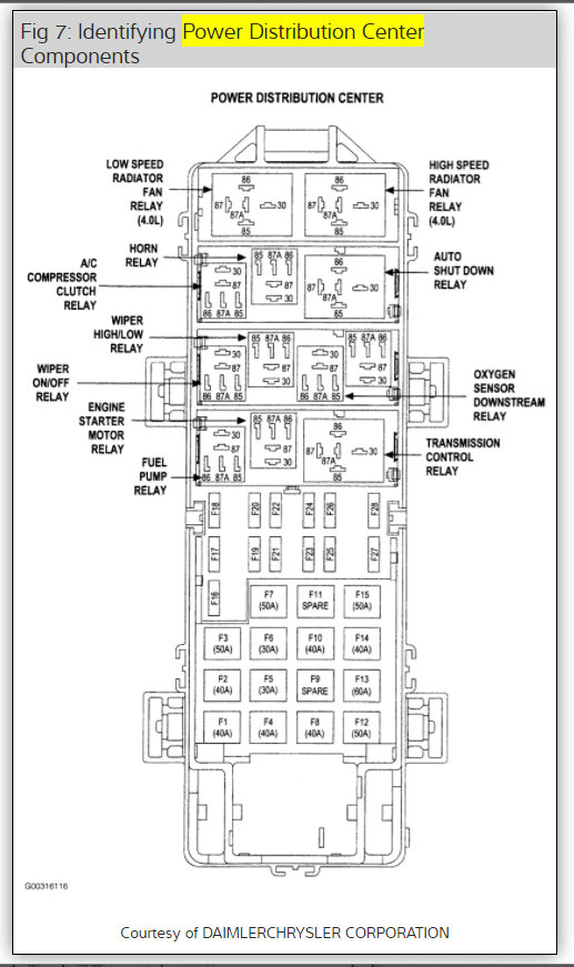

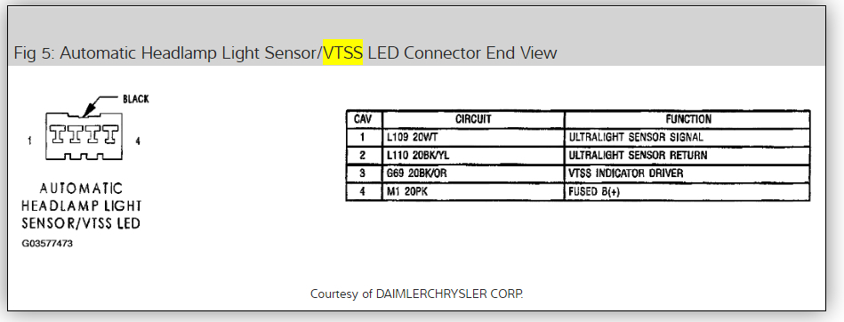

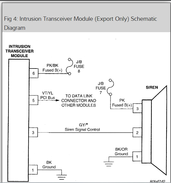

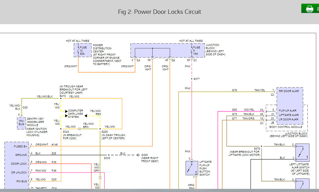

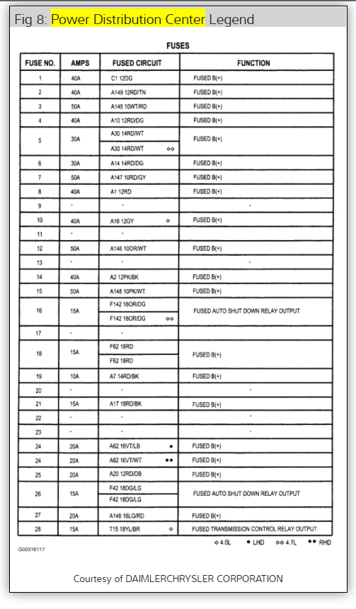

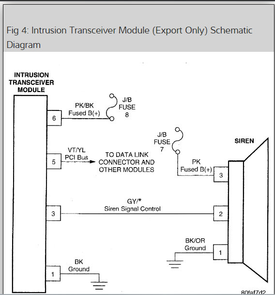

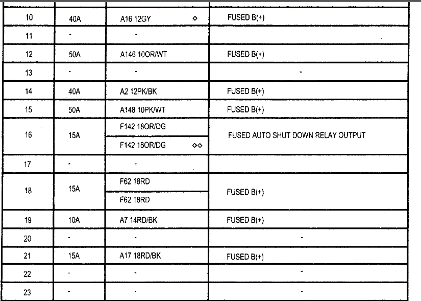

Okay, the system is run by four fuses (22, 28, 7 and 18) if one goes out the system will not deactivate. Three fuses are in the interior fuse panel one is under the hood PDC. Here is a guide to help you test the fuse and the fuse locations with the security system wring diagrams so you can see how the system works:
Check out the diagrams (below). Please run this test and get back to us.
