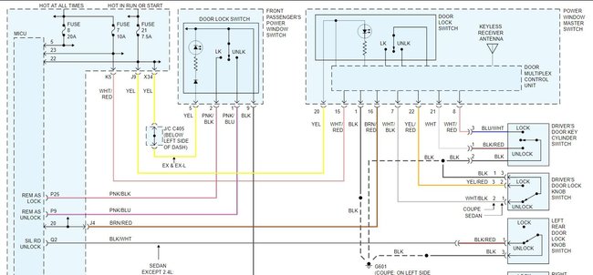

Do the door lock switches work inside the car? The system is split into two parts, the door locks use a different control module than the remote start so at least you know the problem isn't the remote fob itself. The first thing to look at would be the fuses that power the door multiplex module in the drivers door as it is the controller for the locks. Those are fuses number 7, 8 and 21. Next verify if you can lock and unlock all doors from each switch. If the switches all work but still no remote control the multiplex unit is likely the problem, it is part of the power window/lock switch in the drivers door. Testing beyond that point requires a dealer level scan tool to tell you what the module is receiving from the remote.

In that case the problem is likely in the module. However, I would still check the fuses, the wiring doesn't specify if the fuses power different parts of the module but I suspect they do. If you have more than one fob you may want to test it as well, just in case it is a button or circuit issue in the fob just to the lock/unlock switch. Not real likely but it's easier to test that than taking the door apart. Then you also need to program the system again once that is replaced which takes a dealer level scan tool.
