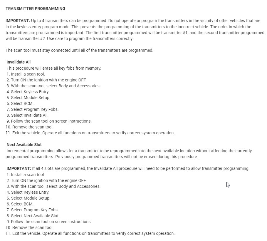

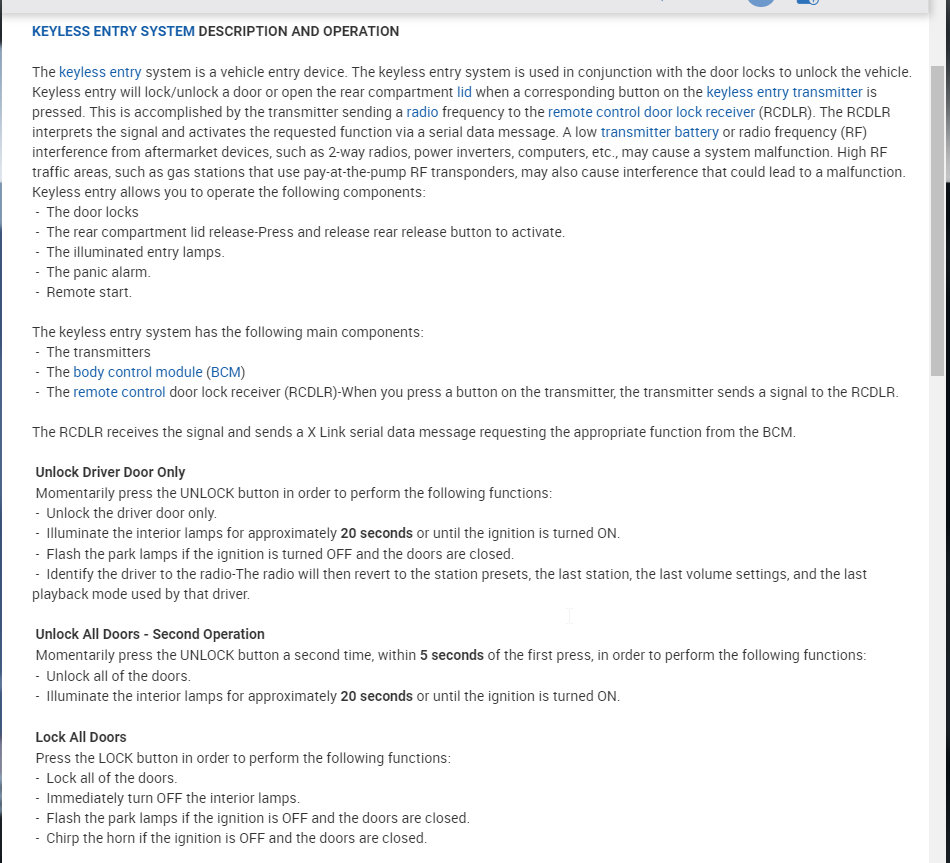

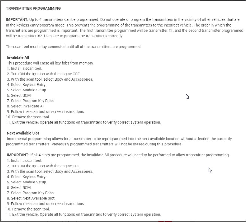

Yes. More than likely the module is the failure. However, you should have some codes to go along with that. I would suggest checking the code first because if you replace that module it requires programming.

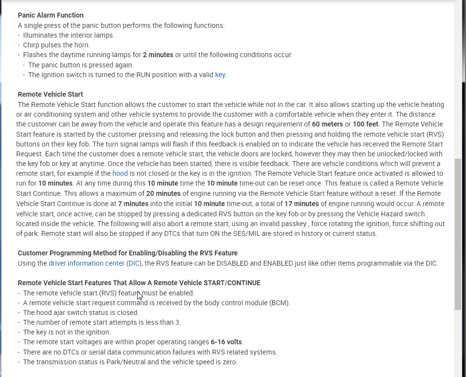

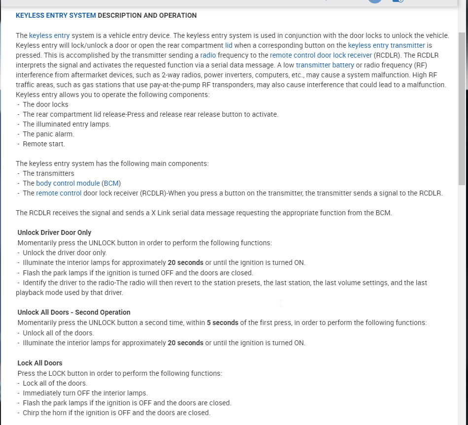

I attached all the detail about this for your review. If you have a code let me know what it is and I can get you the testing info just to confirm.

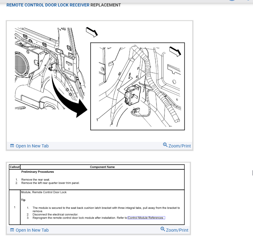

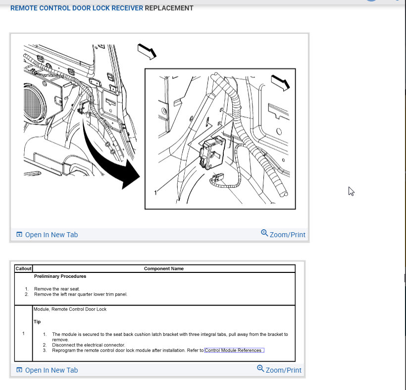

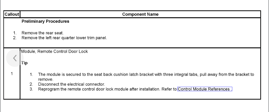

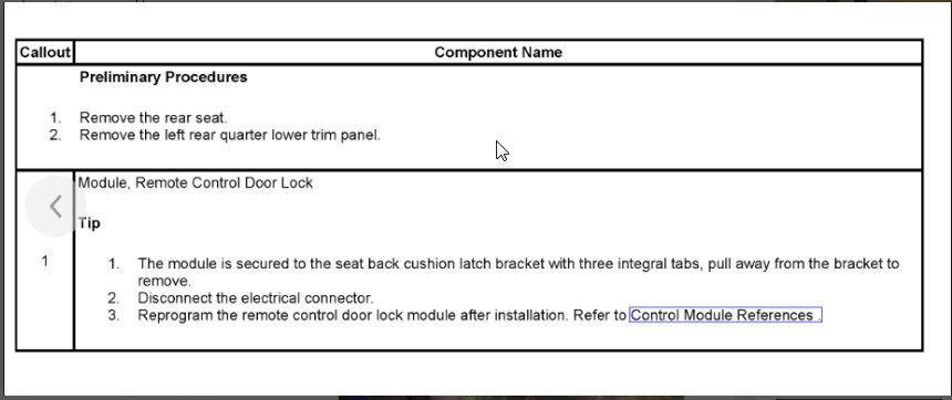

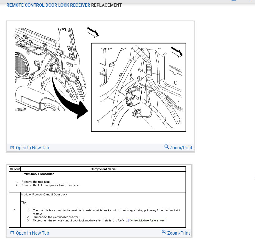

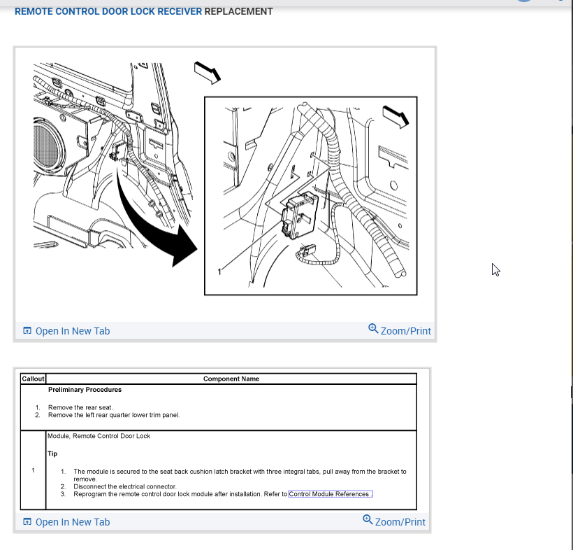

You use a scan tool to check for codes in the body controller. I attached the replacement process.
