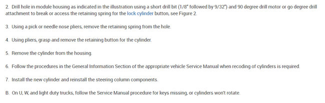

The key has a hole in it chip is missing. How much it cost to fix? And how do i go about fixing it? I think I need to replace the tumbler?
Sep 28, 2017 at 7:51 PM

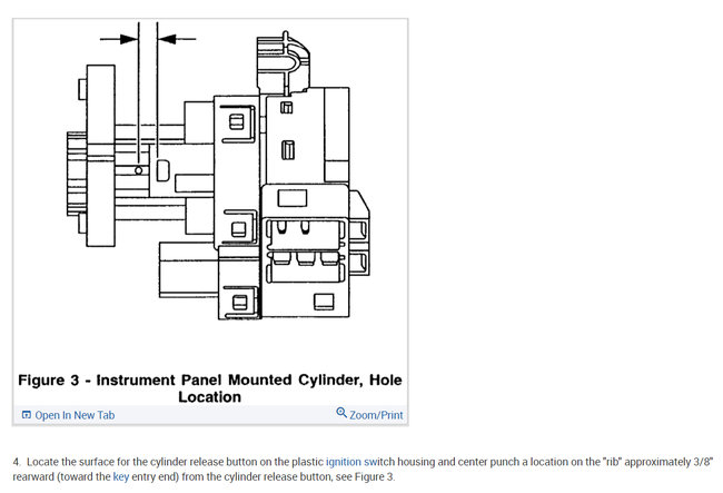

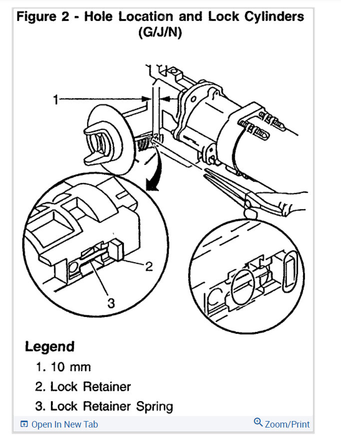

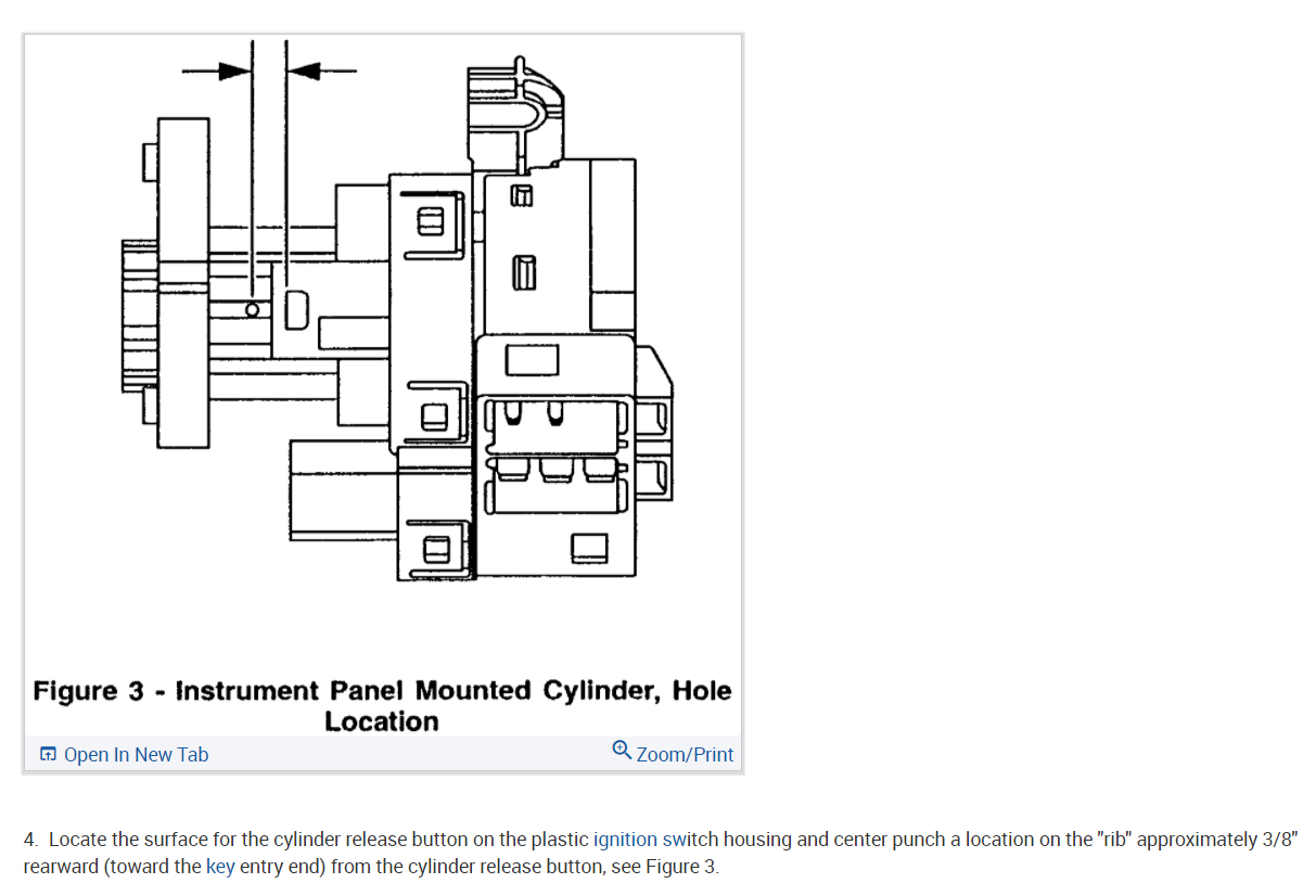

You will need to go to a shop or the dealer and the cost should be about $140.00 to have them make a key and program it for you then you can use these instructions to replace it. Check out the diagrams (Below). Please let us know if you need anything else to get the problem fixed.

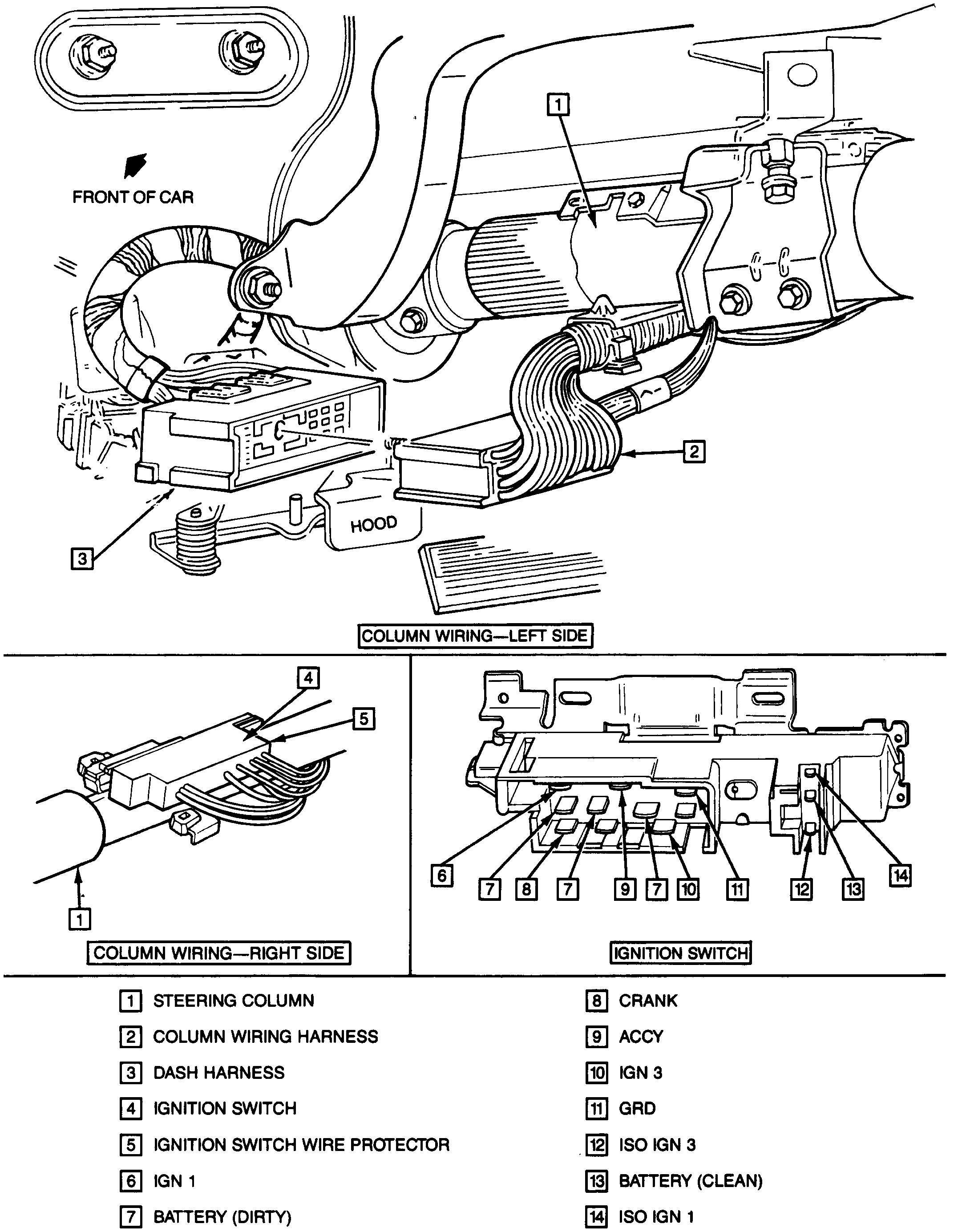

KIRKLAND77
Theirs a single black wire coming from the ignition switch. Theirs no other wires with this single wire. I was thinking it has something to do with the vats system but really not sure. Can you guys tell me what this wire is for and where do it go?
Nov 11, 2020 at 4:45 PM (Merged)
Could it be a ground?

KIRKLAND77
Its not a ground it should be with a white wire it runs with the factory wire harness.

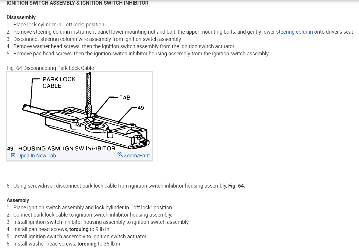

DEVILLDOG
How do you change the ignition switch?
BLUELIGHTNIN6
  • 16,542 POSTS
You need ignition switch itself (located in steering column) or the ignition lock cylinder (where the key inserts) ? Let me know and I will post the proper replacement procedures.

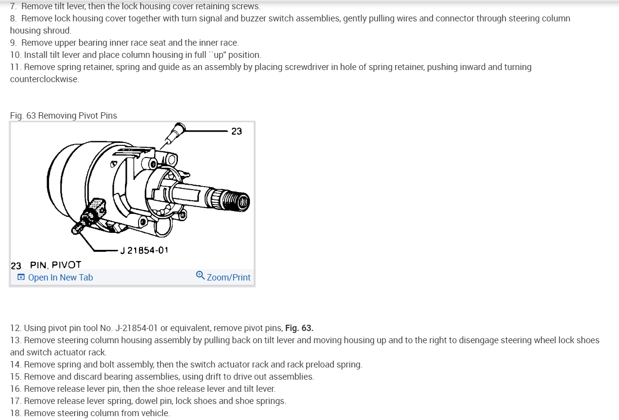

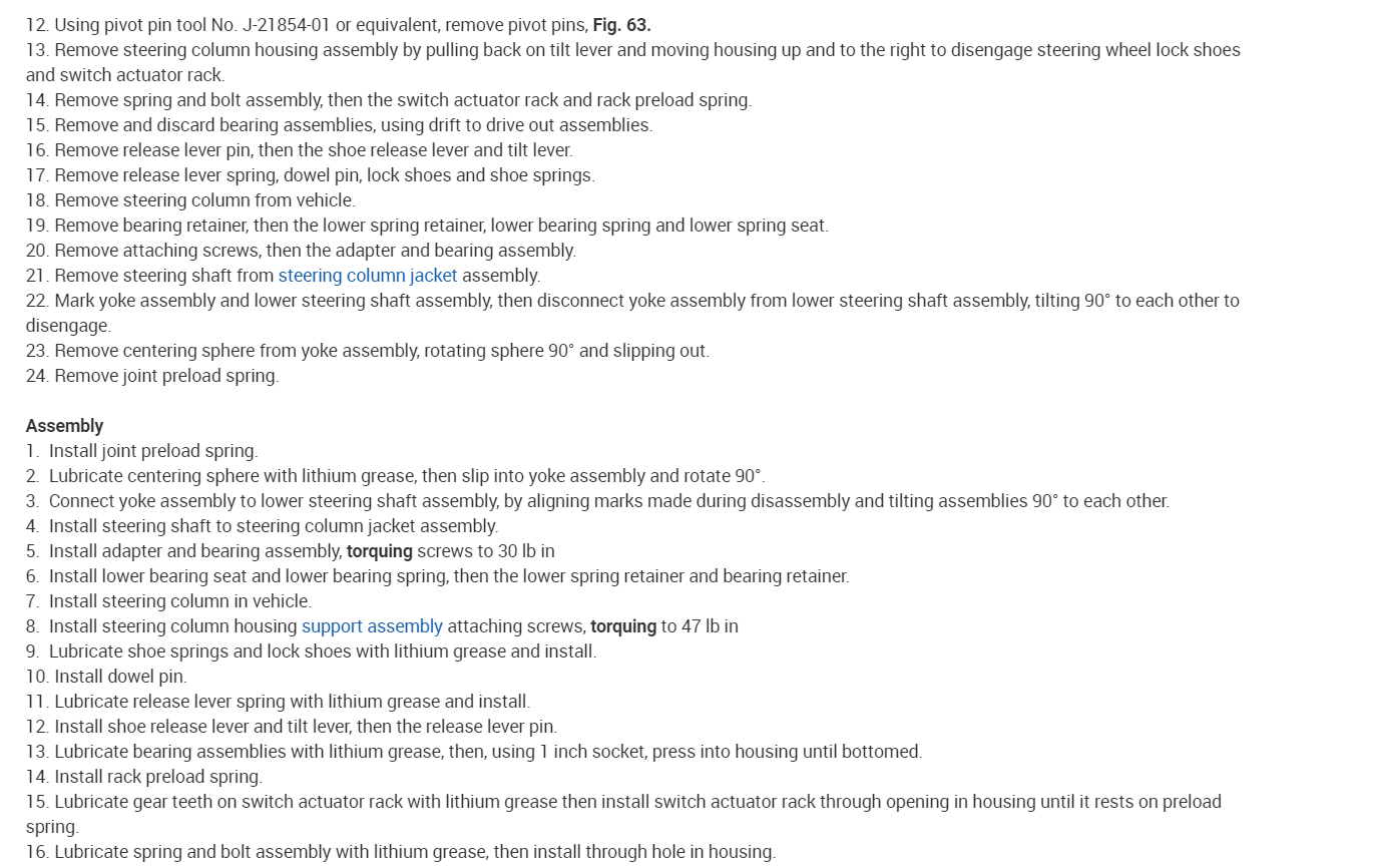

DONKKEY13

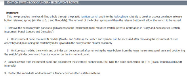

How would I just remove the lock where the key goes in the ignition cause the ignition will not turn to the off position so the car will shut off it is a 1989 Buick Riviera have 5 dollars for this issue

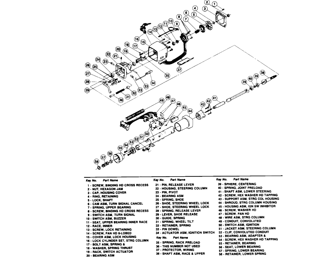

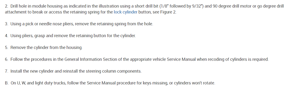

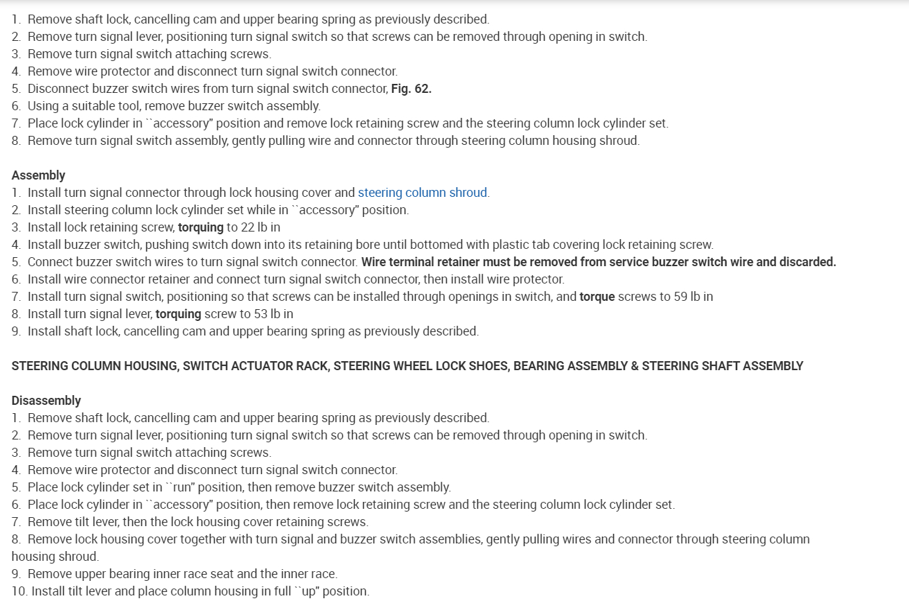

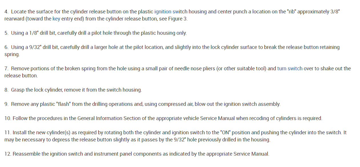

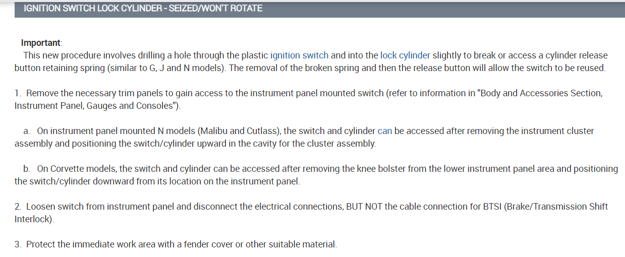

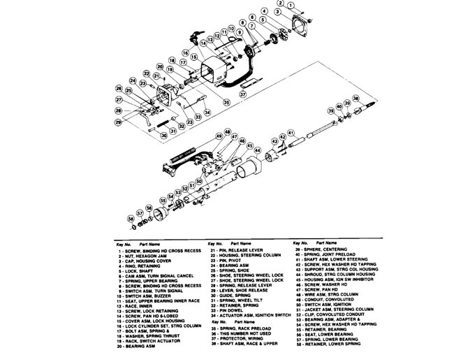

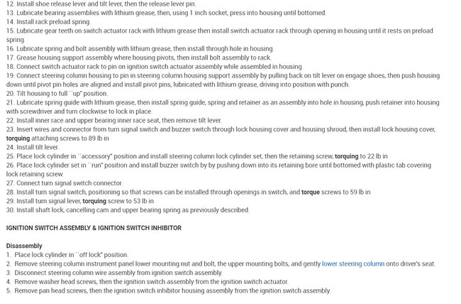

You will need a new lock and key here are the instructions on how to change the ignition lock and turn out. Check out the diagrams (Below). Please let us know if you need anything else to get the problem fixed.

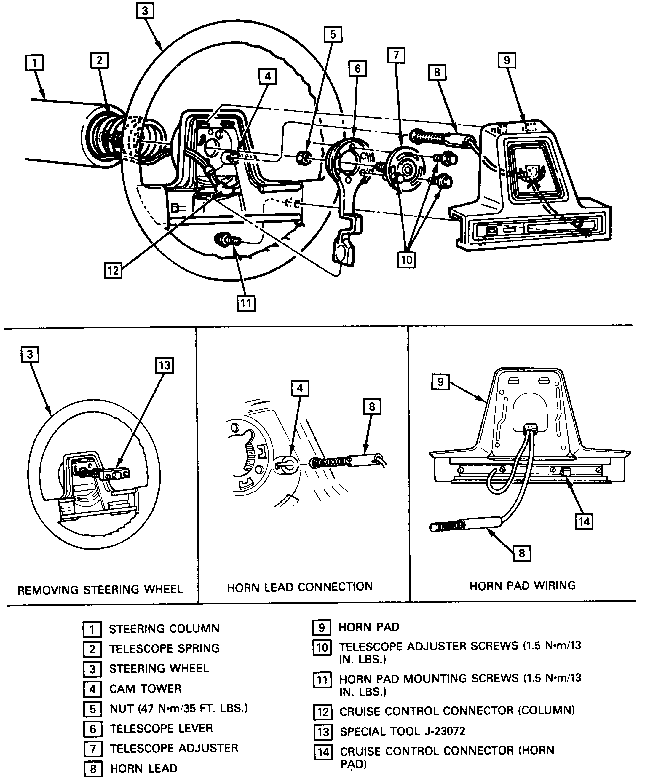

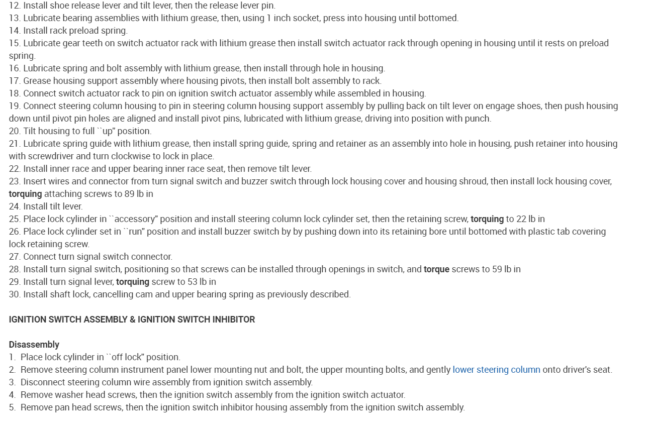

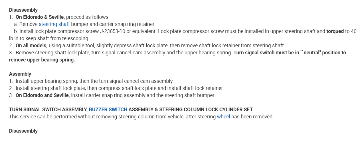

IAN CARPENTER
On 1989 Buick Riviera, Do I need to remove the steering wheel to replace the ignition tumbler/cylinder or is there a tool to remove it?

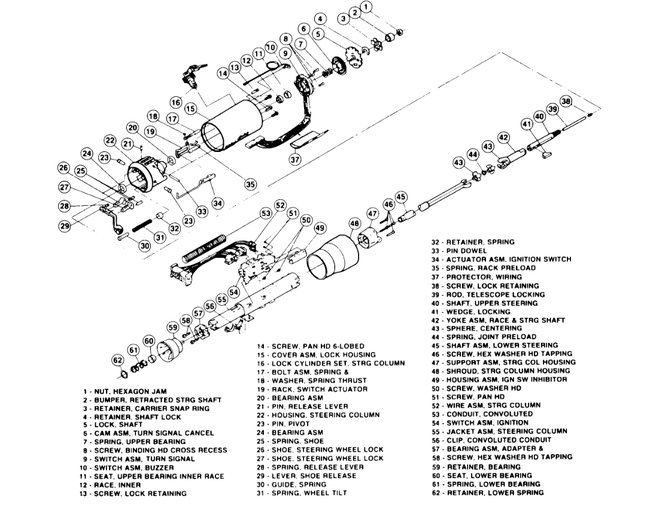

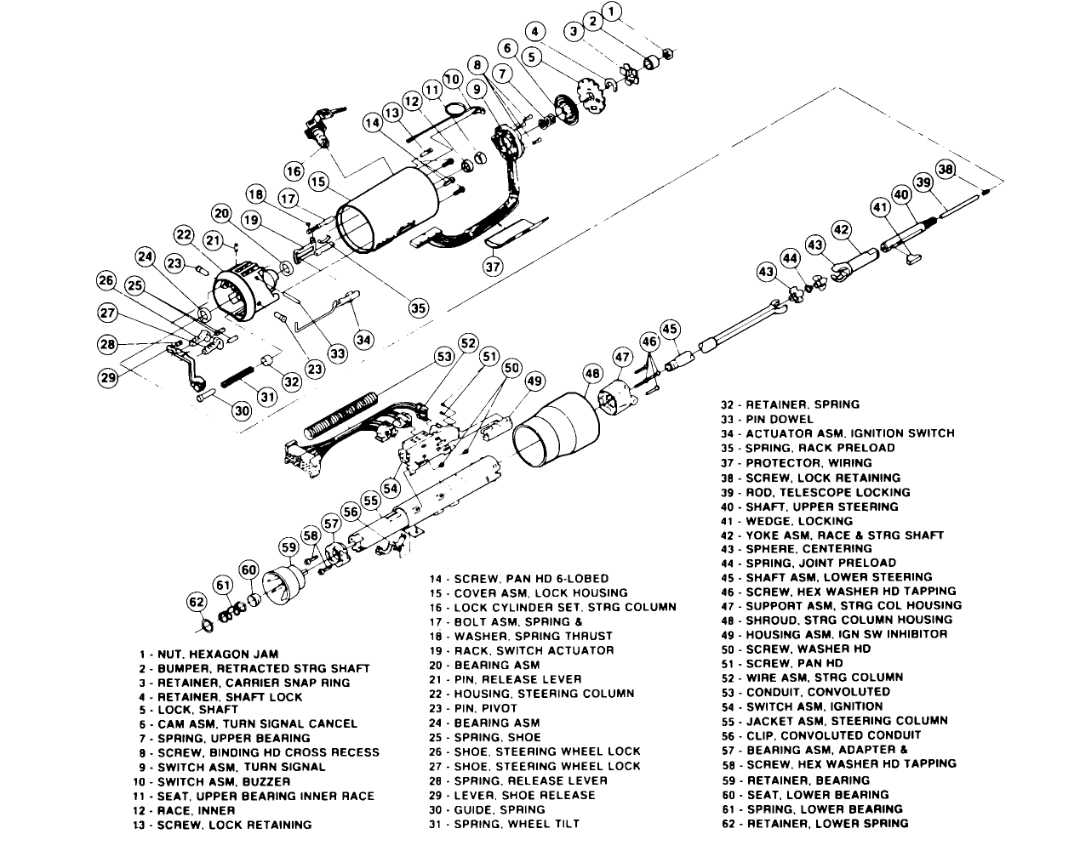

If you are replacing the switch and not the lock cylinder, here are the directions. Also, yes it needs removed.
1989 Buick Riviera V6-231 3.8L VIN C SFI
Ignition Switch
Vehicle Steering and Suspension Steering Steering Column Service and Repair Removal and Replacement Ignition Switch
IGNITION SWITCH
WARNING Before preforming this procedure, disarm airbag as outlined under Airbag Arming and Disarming. Failure to do so may result in accidental deployment of airbag, possibly causing personal injury.
Steering Wheel And Horn Pad
pic 1
Ignition Switches And Column Wiring
pic 2
REMOVE OR DISCONNECT
The ignition switch is hardwired. The wiring harness with the column harness connector must be replaced with the ignition switch. DO NOT splice the new switch to the existing column wiring harness.
1. Left hand sound insulator.
2. Instrument panel steering column cover.
3. Ignition switch wire protector.
4. Screws holding switch to column.
5. Ignition and turn signal switch column harness connectors from dash connector.
6. Turn signal switch harness connector from column harness connector.
7. Ignition switch assembly, including switch, harness, and connector.
