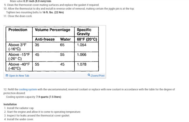

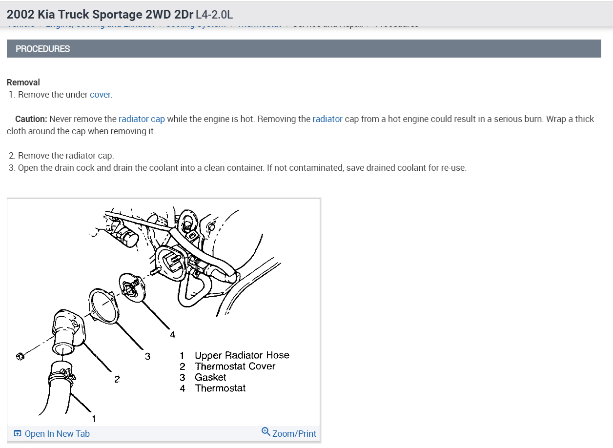

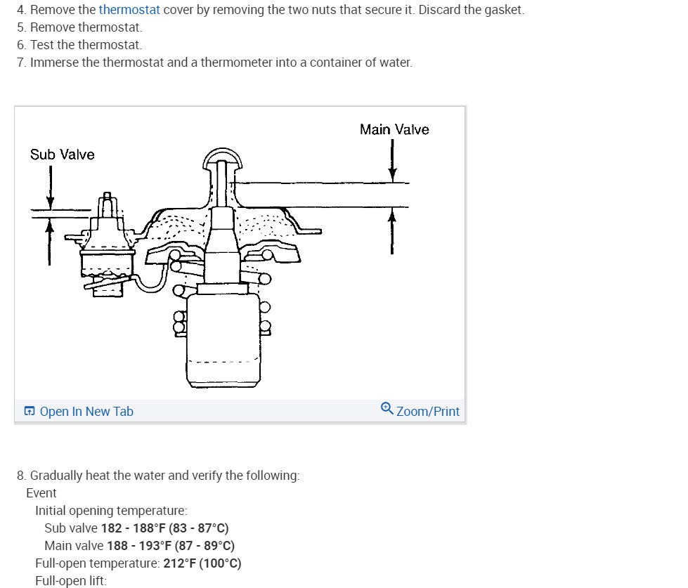

This happens when the engine cooling system thermostat goes out and is stuck open.
Here is a generic guide to help you step by step with instructions in the diagrams below to show you how on your car:
Clear the codes once completed, check out the images (below). Please let us know what happens.
