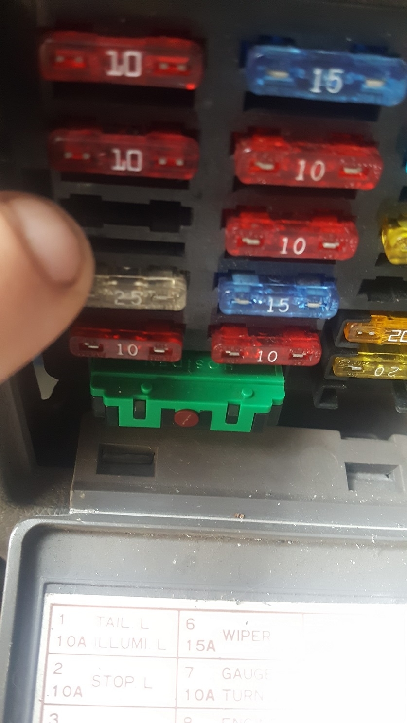

The #3 fuse, labelled "Room L" in the fuse box under the left side of the dash? The 10 watt fuse keeps blowing. I bough a 15 for it yesterday and while it lasted a little longer, it ended up blowing too.
It is the fuse for my radio, interior lights and for the dinging sound you hear when you have left your keys in the ignition.
I checked the grounding on the stereo and the one coming off the battery, both look fine, but that is all I know how to do, I am at an impasse here. Anyone else have this experience or know what else I could check?
