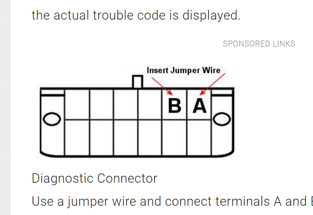

It sounds like you lost spark to the plugs. I suspect it may be related to the ignition control module in the distributor. To confirm, we need to check for diagnostic trouble codes. This vehicle has an OBD1 system and it doesn't require a scan tool to retrieve codes. All that is needed is a short jumper wire or even a paper clip. Do this first and let me know what you find.
https://www.2carpros.com/articles/buick-cadillac-chevy-gmc-oldsmobile-pontiac-gm-1983-1995-obd1-code-definitions-and-retrieval-method
I have a feeling you will retrieve a code 42. However, check first and then we will know what directions to move.

The link above explains how it's done. All you need to do is jump pins A and B on the DLC under the dash. See pic 1.
Let me know if that helps.
