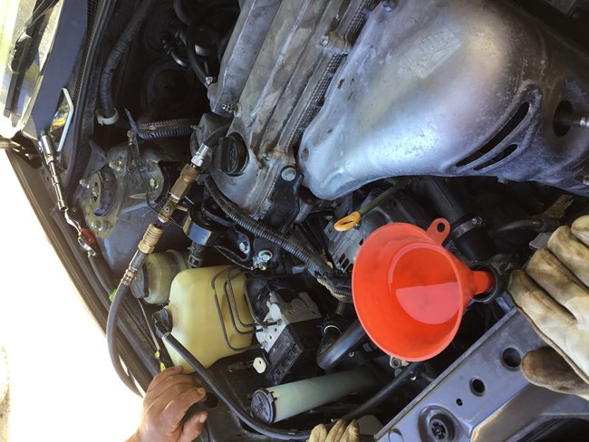

I changed the thermostat and bleed the air. the engine still overheats and blows coolant out of the reservoir. engine has a rattling sound when low idle. i started seeing coolant on ground.
Jan 25, 2021 at 10:28 AM (Merged)
Have you checked to make sure the water pump isn't leaking? Also, with the engine cold, if you remove the radiator cap and start the engine, does coolant shoot out?

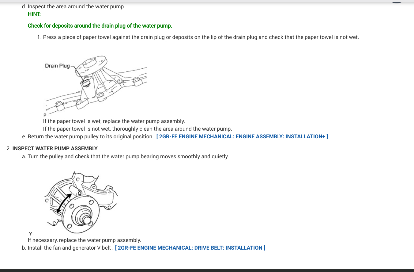

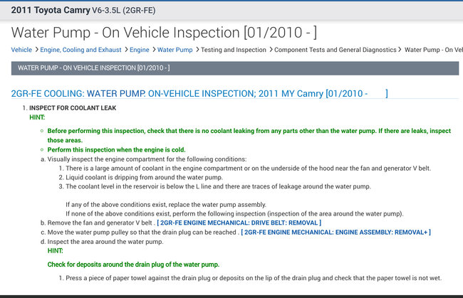

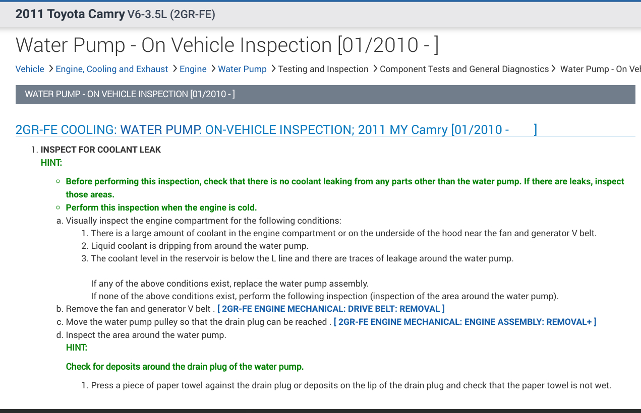

Based on your description, I really feel it is related to the water pump. They can make noise when the bearing inside goes bad and they can leak. The pump is above and to the right of the crankshaft pulley. See pic 1. I circled it in the pic. Check for leaks, see if there is any side to side play in the pulley, and make sure the belt is tight.
Also, I want you to take a look through this link. See if any of the symptoms mentioned mirror what you are experiencing.
Let me know so I can better direct you.
