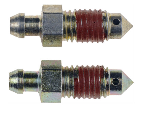

How to use a speed bleeder:
https://youtu.be/fEBE_NqLXJc
