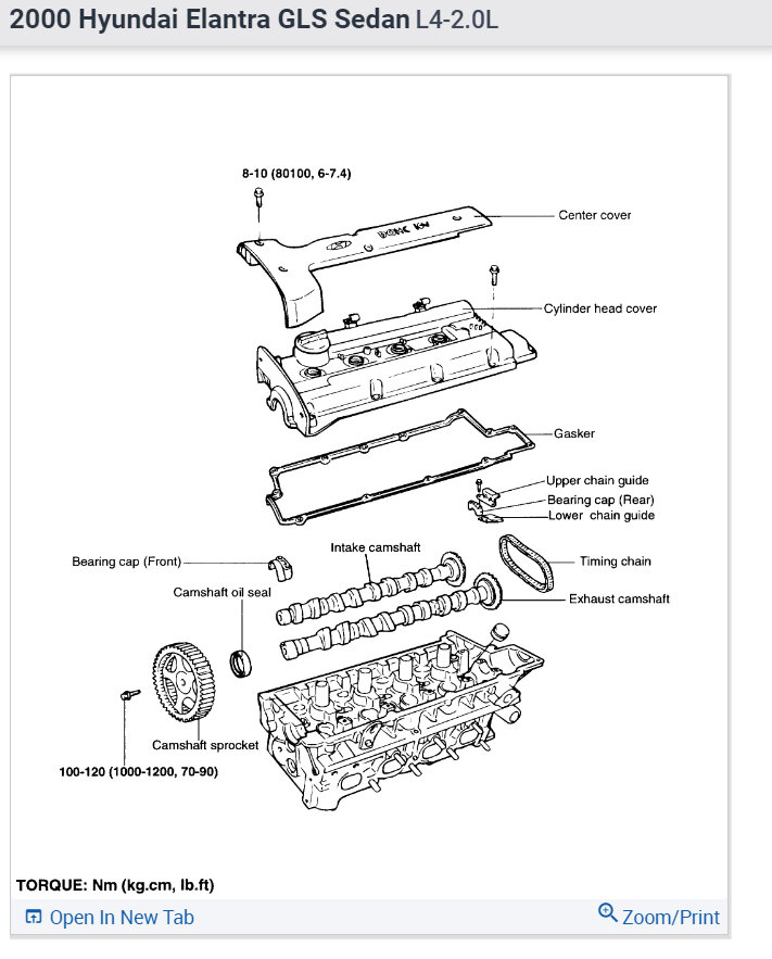

If you can send me process and torque specs for valve cover gasket and lower gasket by manifold. Also believe leaking by oil pan. Oil pan gasket may need replacement.

Here is a generic guide to help you step by step with instructions in the diagrams below on how to change the valve cover gasket on your car:
https://www.2carpros.com/articles/replace-valve-cover-gasket
Cylinder Head Cover Bolt 8 - 10 Nm
Check out the images (below). Please let us know if you need anything else to get the problem fixed.
