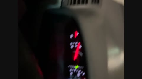

This is one of the videos. You may hear better with headphones on.

I did hear a noise. To me, it sounds like a bearing. Does it change in volume or intensity when turning? Did you have any problems when installing the new wheel bearings?
Did you have the vehicle aligned?
