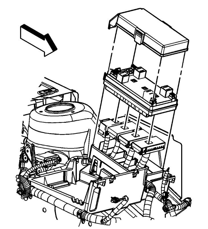

The C 1 through 4 blocks are the connectors to the bottom of the main fuse block.
Disconnect the battery then remove all of the fuses and relays from the block, then you un-clip it from the battery tray. Next you release the clips that hold the cover on over the 4 bottom connectors and loosen the 4 bolts that go down the middle of the block. With those loose you remove the connector locks from the side of the block and remove the connectors. If one of the connectors itself is damaged, those are part of the harness and replacement is to cut and splice the wires, or if you have the tools to release the pins you can remove only the damaged ones and replace those.

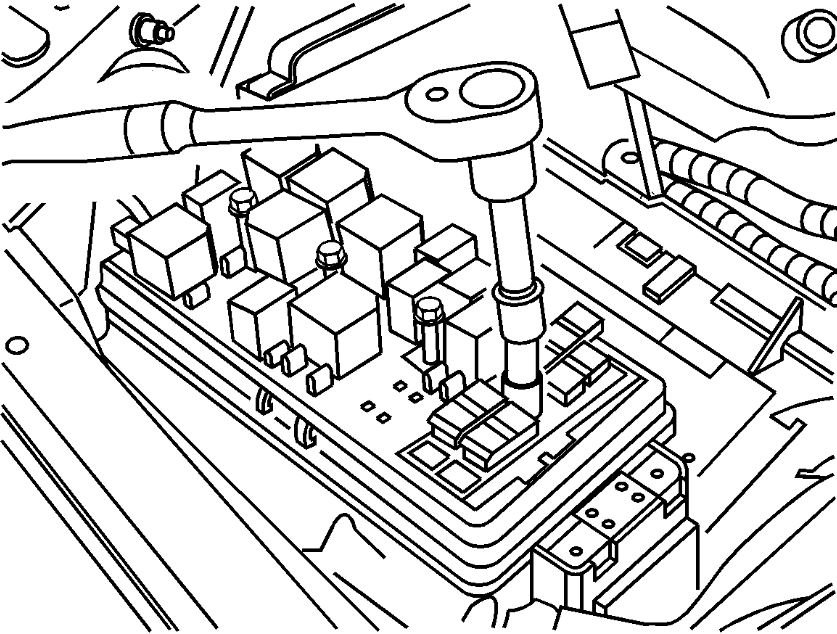

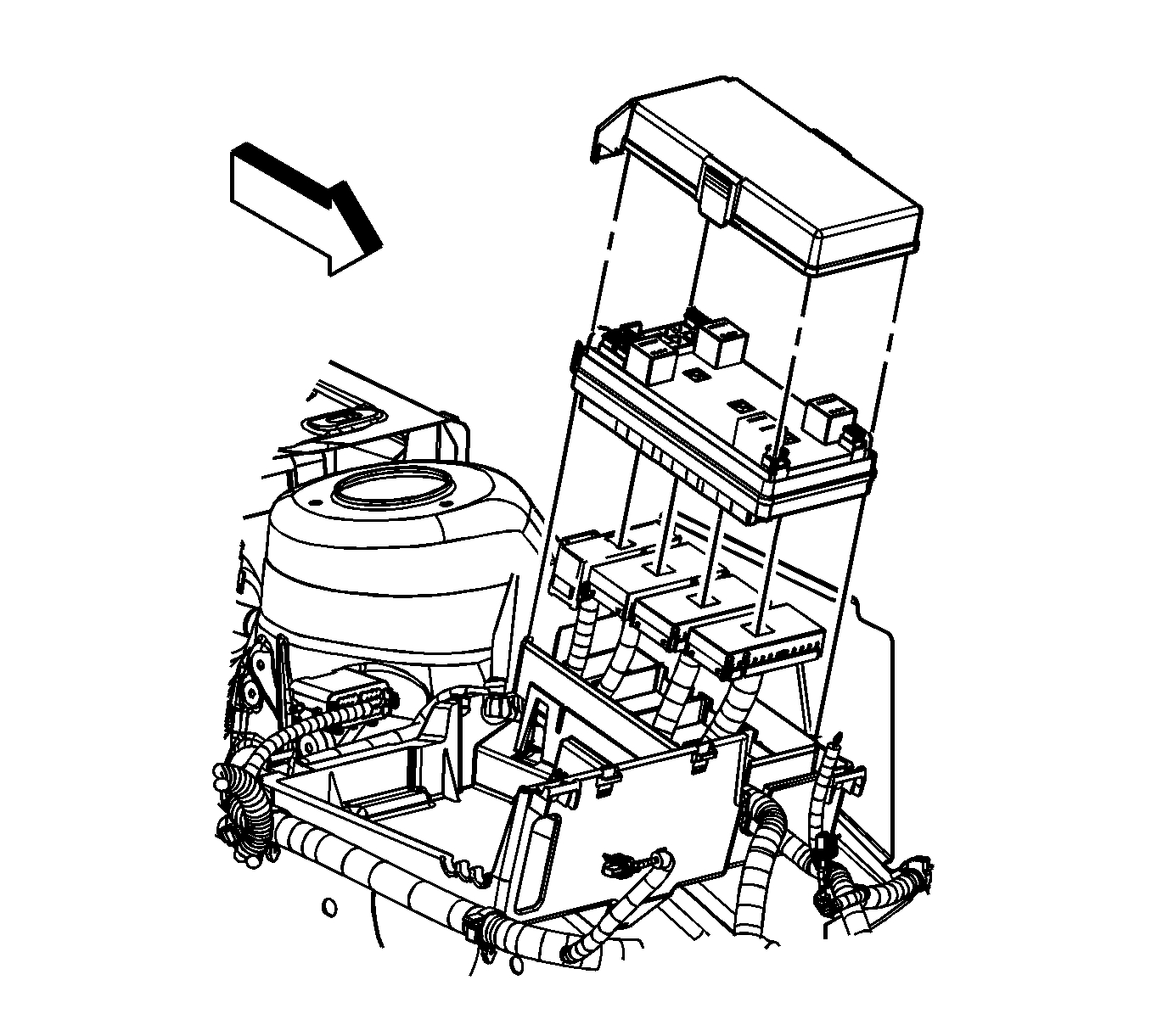

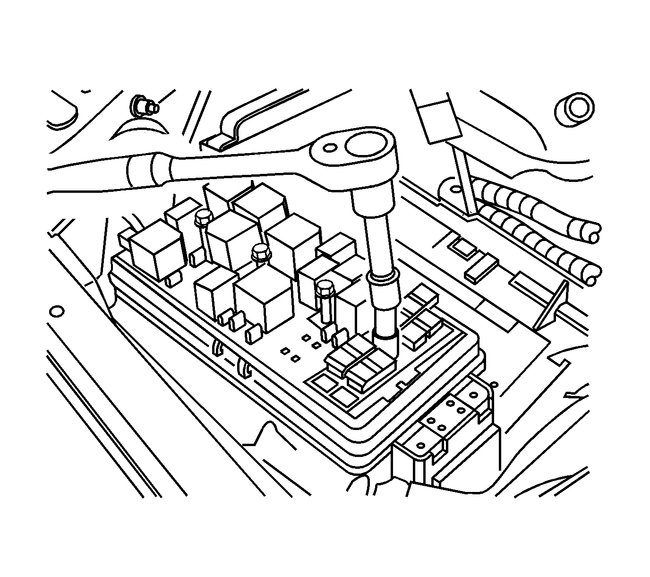

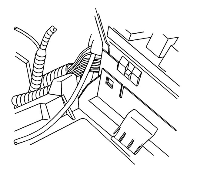

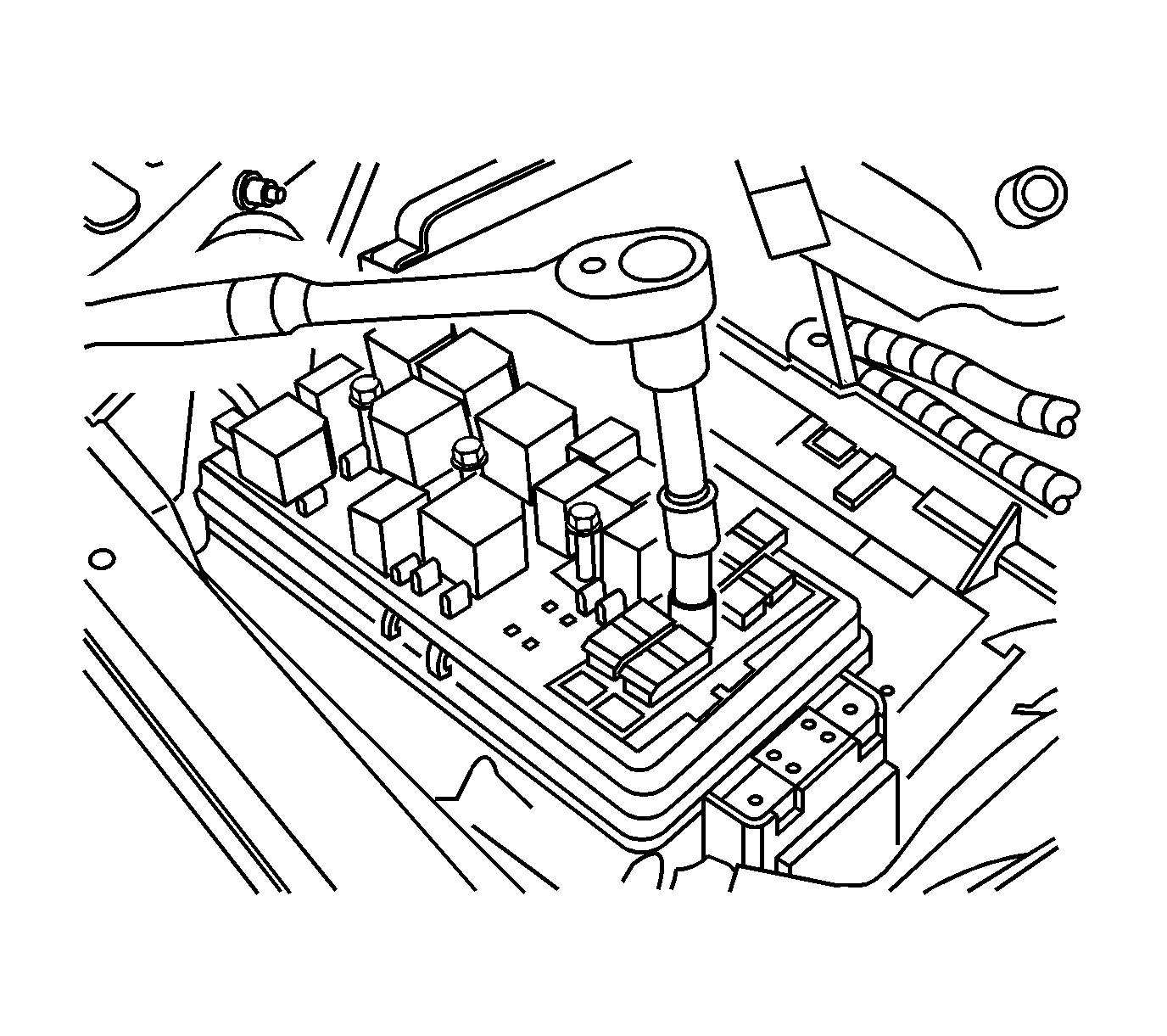

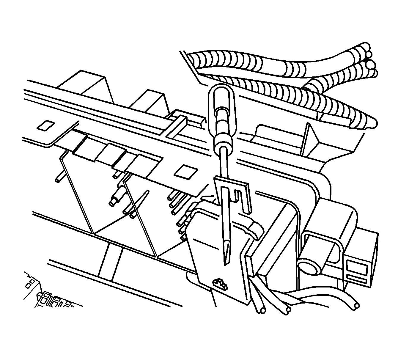

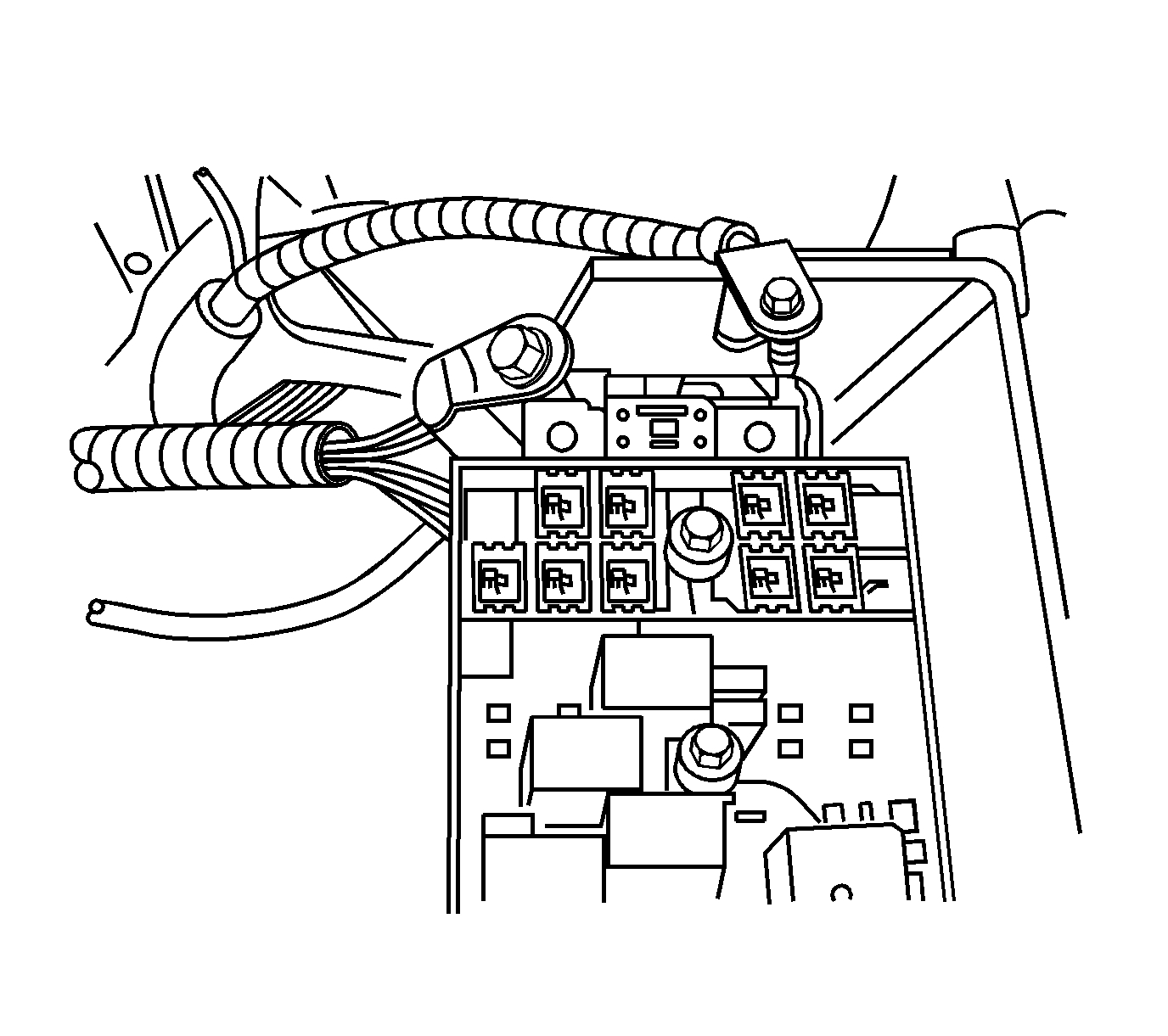

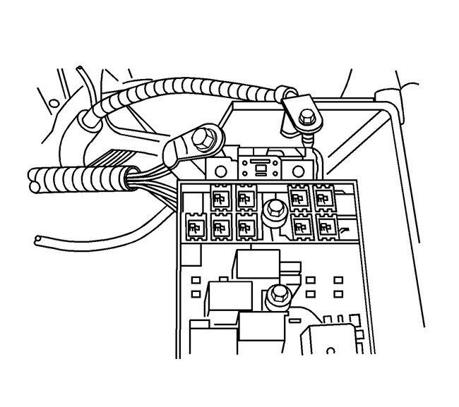

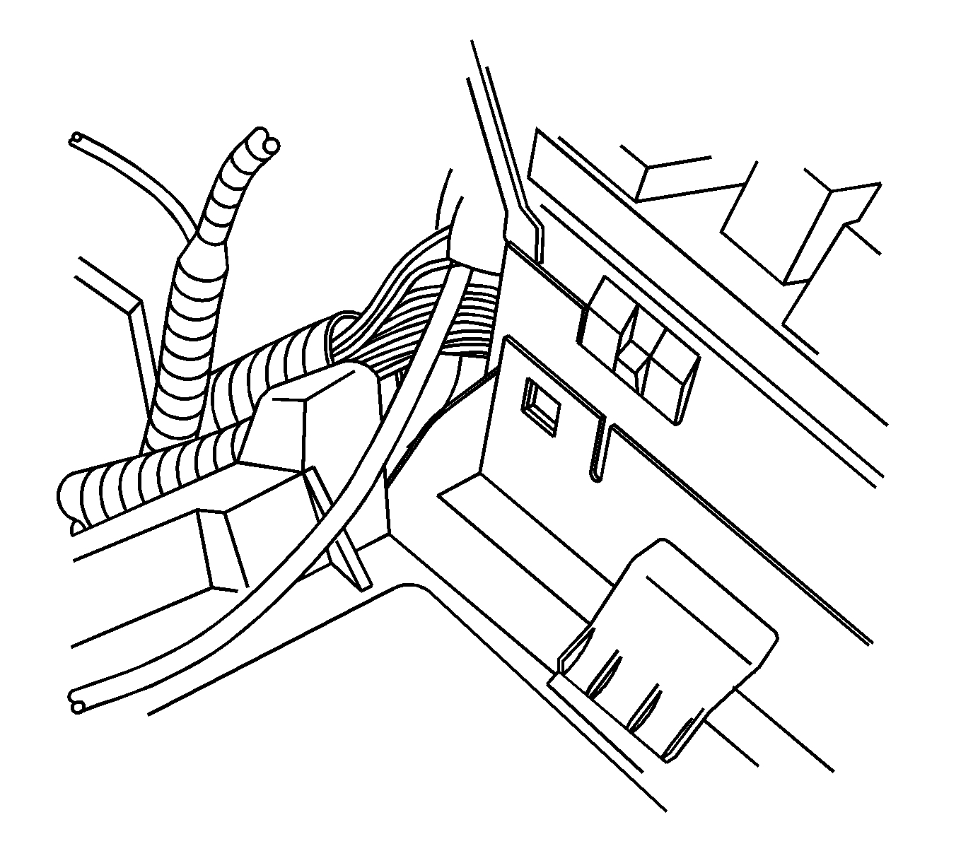

Take a look through these directions and let me know if they help. The attached pictures correlate with the directions.
_________________________
2006 Pontiac G6 V6-3.9L VIN 1
Procedures
Vehicle Power and Ground Distribution Fuse Block Service and Repair Procedures
PROCEDURES
UNDERHOOD ELECTRICAL CENTER OR JUNCTION BLOCK REPLACEMENT
REMOVAL PROCEDURE
pic 1
1. Remove the battery.
pic 2
2. Remove the fasteners retaining the positive battery cable leads to the underhood electrical center, then reposition the cable lead away from the electrical center.
3. Remove the electrical center cover.
4. Remove all of the fuses and the relays.
pic 3
5. Use a flat-bladed tool to disengage the 4 tabs that secure the electrical center to the battery tray.
pic 4
6. Use a flat-bladed tool to remove the connector cover from the electrical center.
pic 5

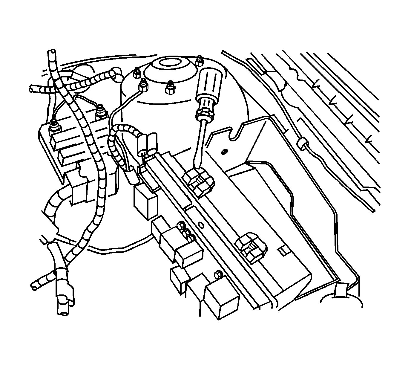

7. Loosen the 4 bolts across the top of the electrical center.

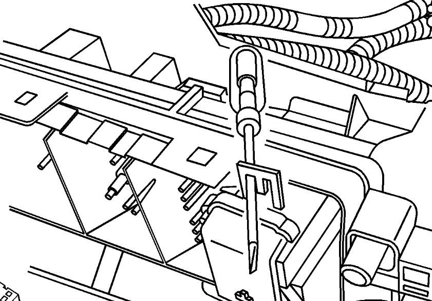

pic 6
8. Use a flat-bladed tool to remove the locking pins from the body harness connector.
9. Disconnect the body harness connector.
10. Disconnect the remaining wiring harness connectors from the junction block.
INSTALLATION PROCEDURE
pic 7
1. With the electrical center turned upside down, install the electrical center harness connectors into the electrical center.
pic 8
2. Install the locking pin to the power supply connector.
3. Install the bolts retaining the engine, instrument panel (I/P), and forward lamp wiring harness connectors to the junction block.
NOTE: Refer to Fastener Notice in Cautions in Notices.
Tighten the electrical center junction block bolts to 7 N.m (62 lb in).
pic 9
4. Install the electrical center connector cover.
5. Turn the electrical center right side up.
6. Install the electrical center to the battery tray by pushing the electrical center into the retainer tab.
7. Install all of the fuses and the relays.
8. Install the positive battery cable lead to the stud on underhood electrical center, then install the positive battery cable lead retaining nut.
Tighten the positive battery cable lead retaining nut to 10 N.m (89 lb in).
9. Install the electrical center cover.
10. Install the battery.

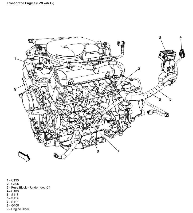

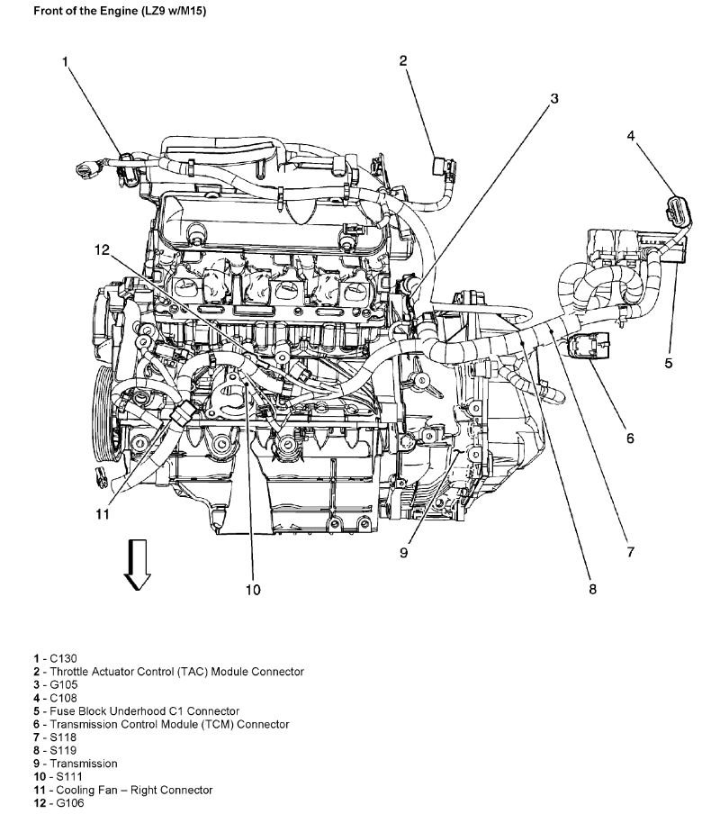

So, the C4, 2, 3 and 1 are not removable. If I traced the harness from these blocks, will they lead to connectors that can be removed from the rest of the engine harness? Is the engine harness not divided by connectors? I see connectors C108, C104, C130 and the Cam shaft Connector. Will disconnecting them isolate the harness to the junction block? I also see Splice points S118 and 119. But I have little clues at this stage whether that will do it. Is there anyway to evade cutting the harnesses or replacing the wires to the C blocks?

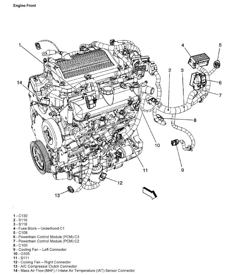

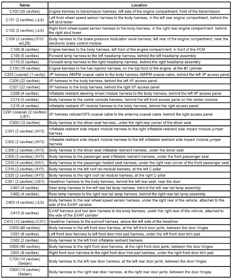

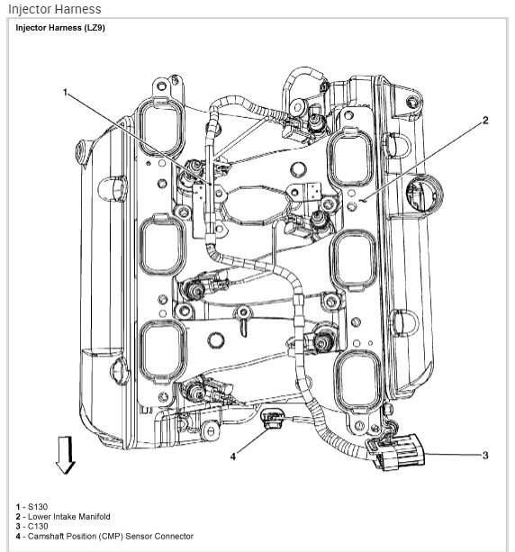

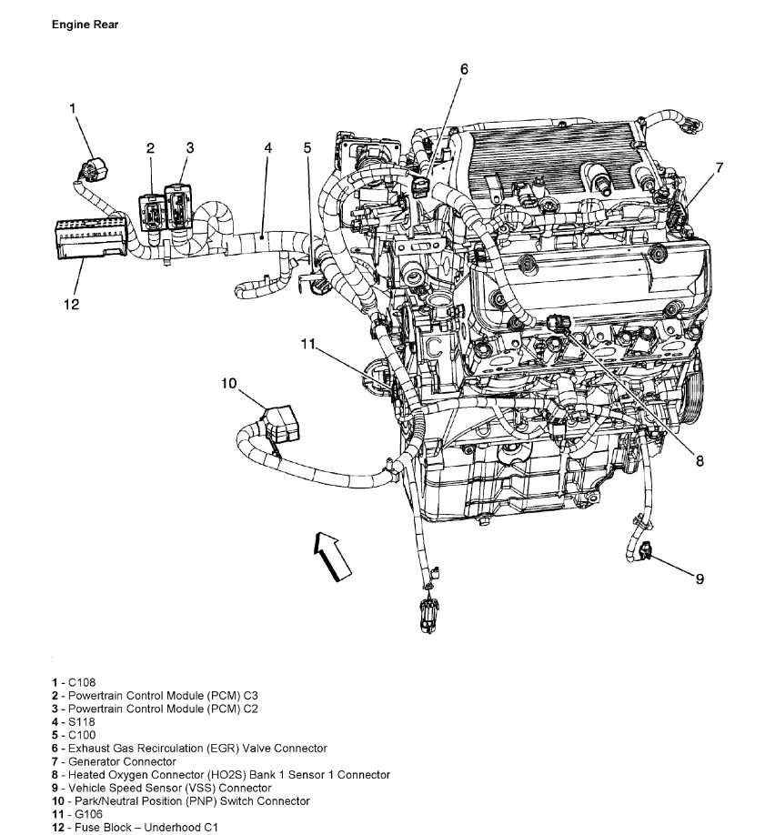

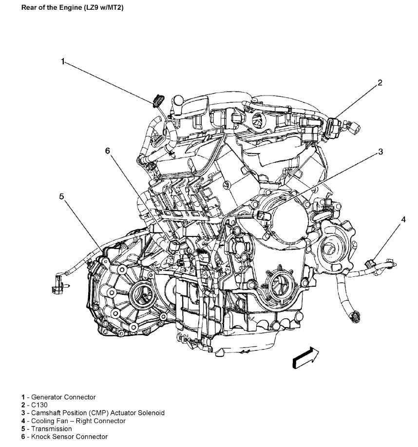

The issue you are going to have is that many of the connectors are not single harness parts. There may be 5 wires from C2, 2 from C4 and 6 from the ECU plus a power from somewhere else. Your best option would likely be to find a replacement harness from a salvage yard and splice the bad wires. IE say there are 30 connectors in C1. You de-pin all 25 of the good ones and swap them over to the same locations in the replacement. Then cut and splice the remaining 5. It would be faster and you wouldn't end up with unknowns from the used harness.

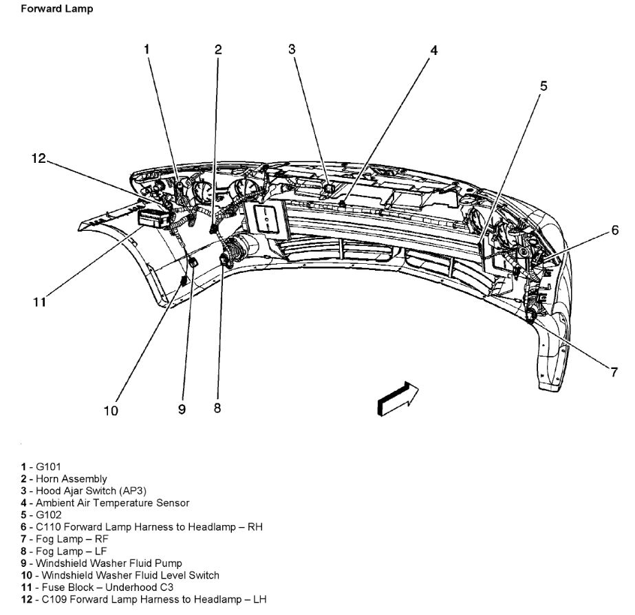

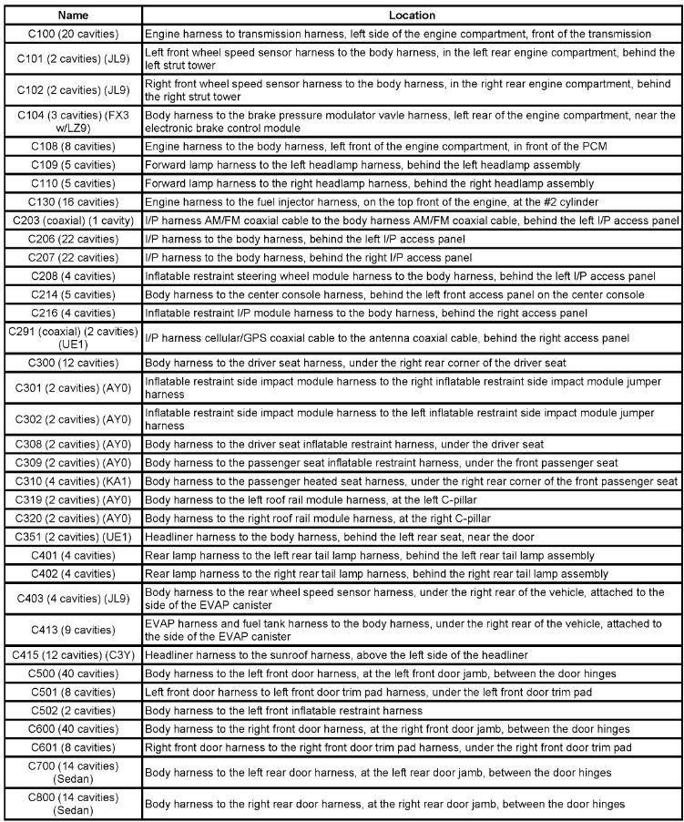

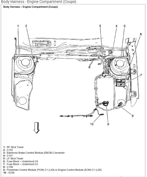

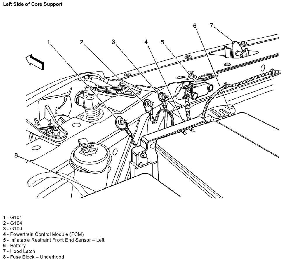

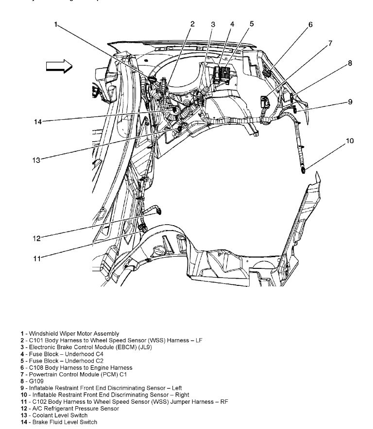

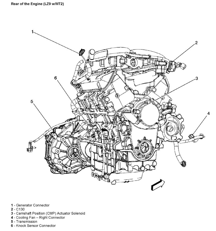

I added the connector locations that GM shows, however they do not show many of the smaller branches. Some of the smaller harness pieces can be left with the engine like the injector harness from C130, But you still have the entire front light harness from C2 to deal with. The grounds in the 100's are in the engine compartment area.
Feb 5, 2020 at 11:09 AM

After examining the junction box and harnesses on other g6 cars, i found that the c1 and c3 blocks can be replaced (intact) without cutting and splicing when their harnesses are traced through the engine bay and disconnecting several sensors and major connectors (108/130/104) etc. However, i found the c2 and c4 blocks whose harnesses are running along, under and behind the strut tower and into the cabin (through the firewall) leading their way along the lower trim area of the driver door (the area above the rocker panel) and branching off to the rear cabin and the other branch turning right around and under the driver seat towards the center console making its way to the BCM (front right of center console). At this point, i am still attempting to see if there is a way to disconnect (without cutting) the c2 and c 4 harness i just described. If all fails, i will suffice with replacing the c1 and c3 connectors along with their harnesses. It is disappointing to look at this mess without connectors. It is not a good a thing to cut and splice when connectors could've been placed in multiple locations.

C1 should be all engine related, C3 is mostly front end and power for things like ABS and such.
C2 and C4 power the dash and body harnesses as you found.
If you are replacing them, I hope you test every circuit and connector on the replacements before installation. Wouldn't be good to get them all installed and discover the car won't start or you get a CEL from a bad connection.
Be sure the C1 and 3 harnesses you get come from cars with the exact same options, there are at least 3 different engine harness styles.

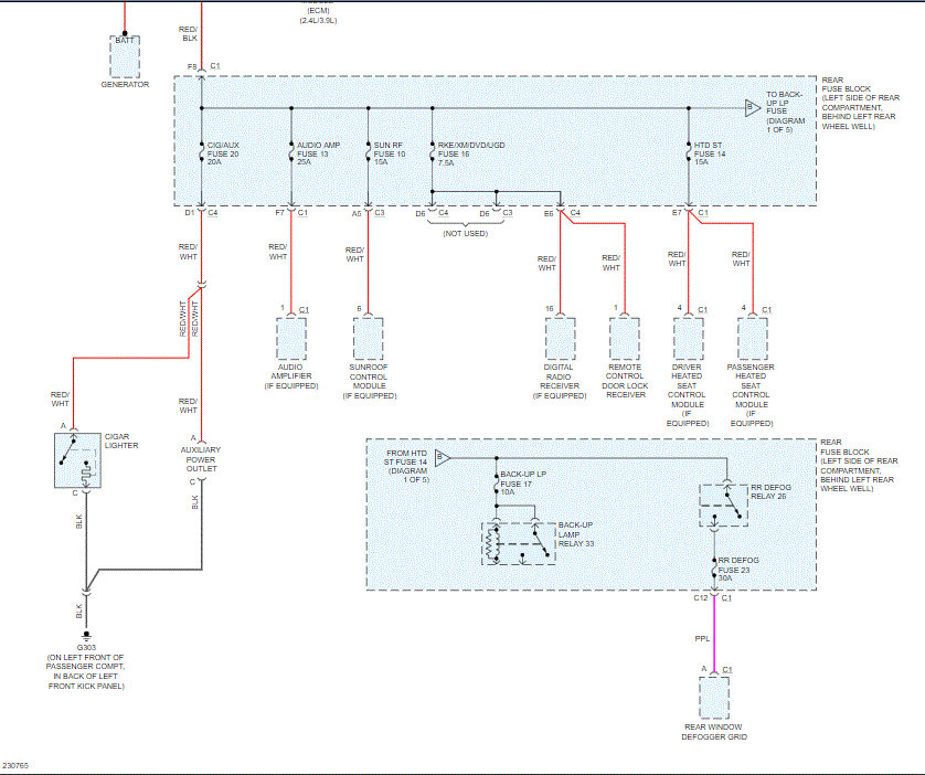

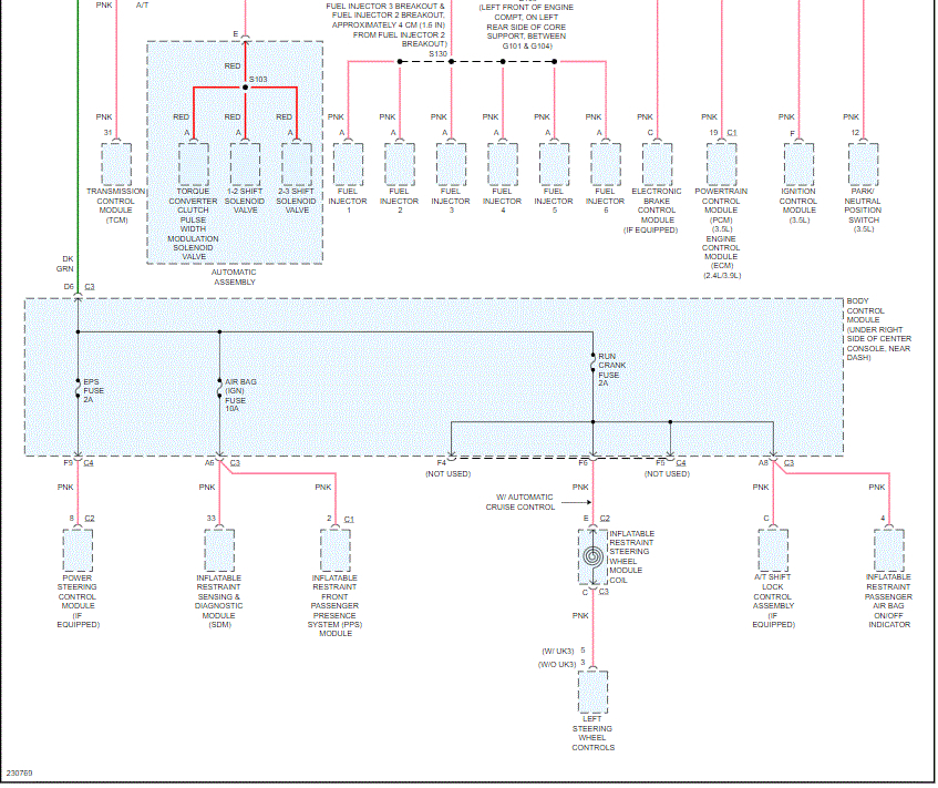

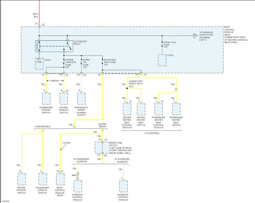

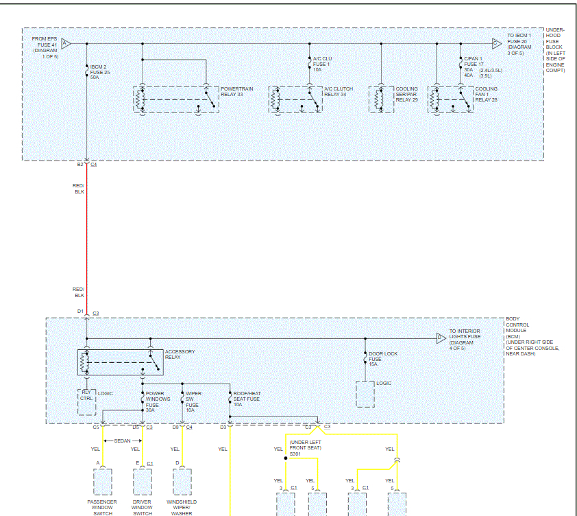

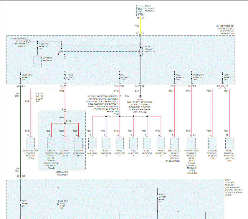

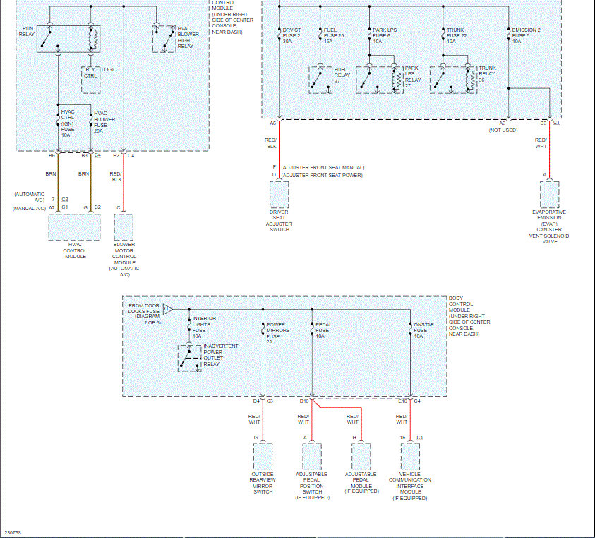

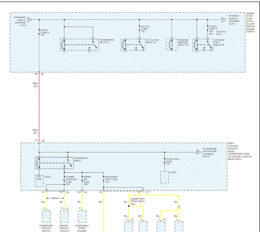

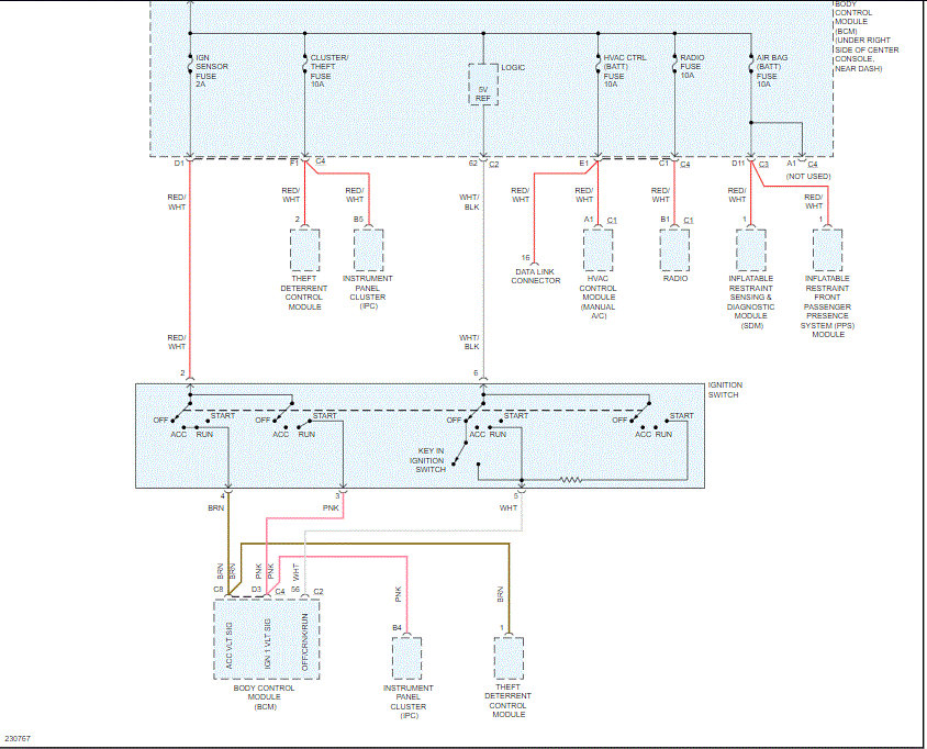

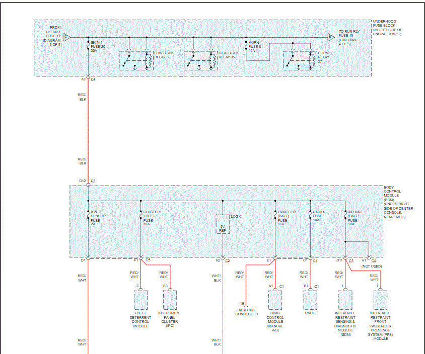

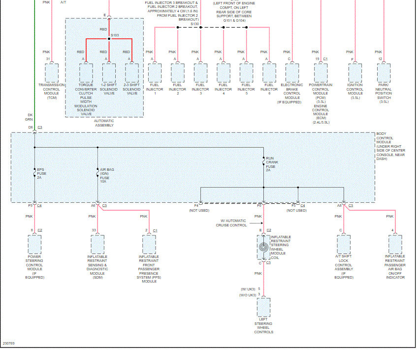

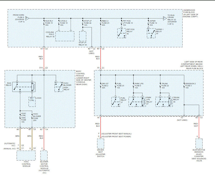

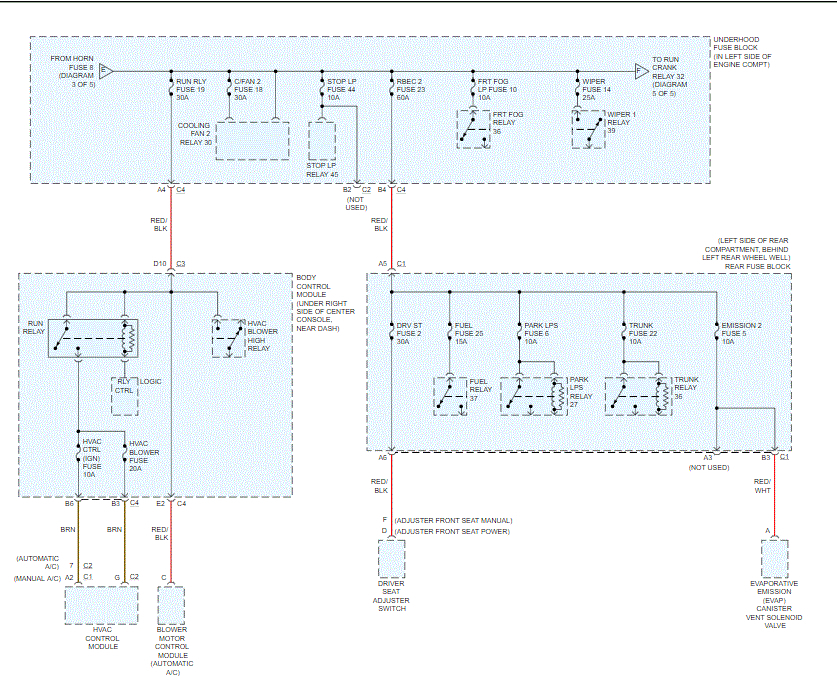

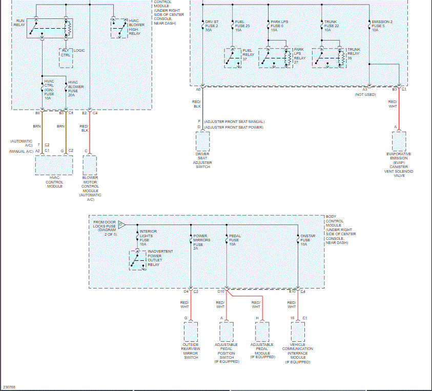

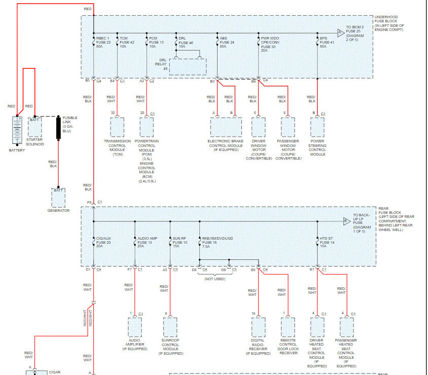

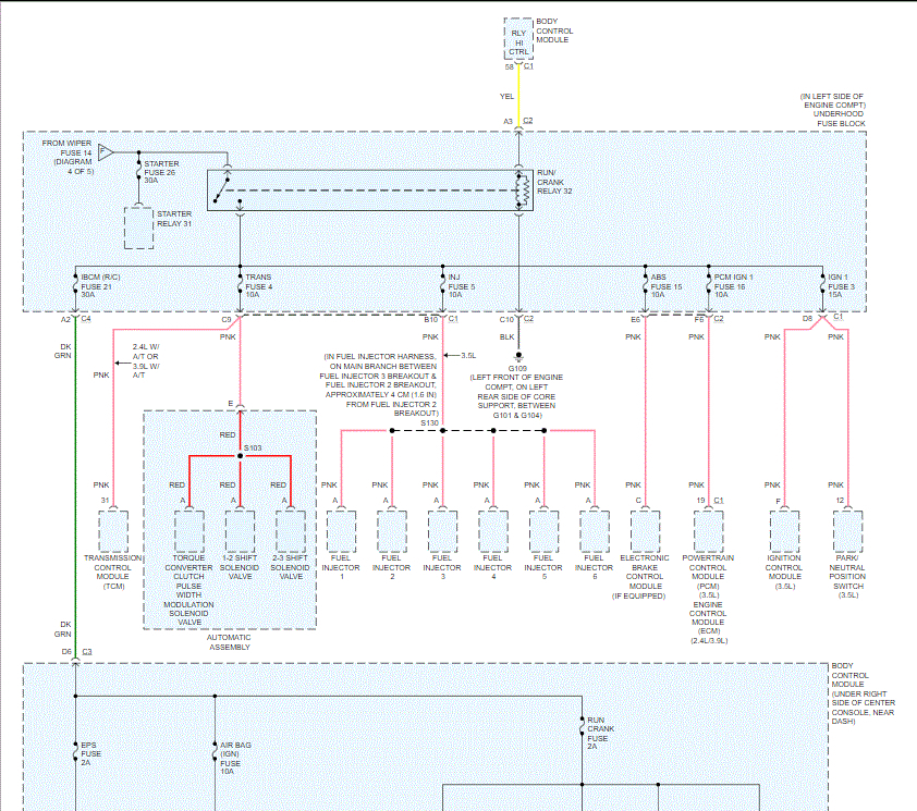

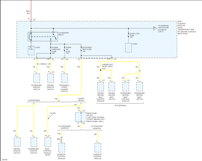

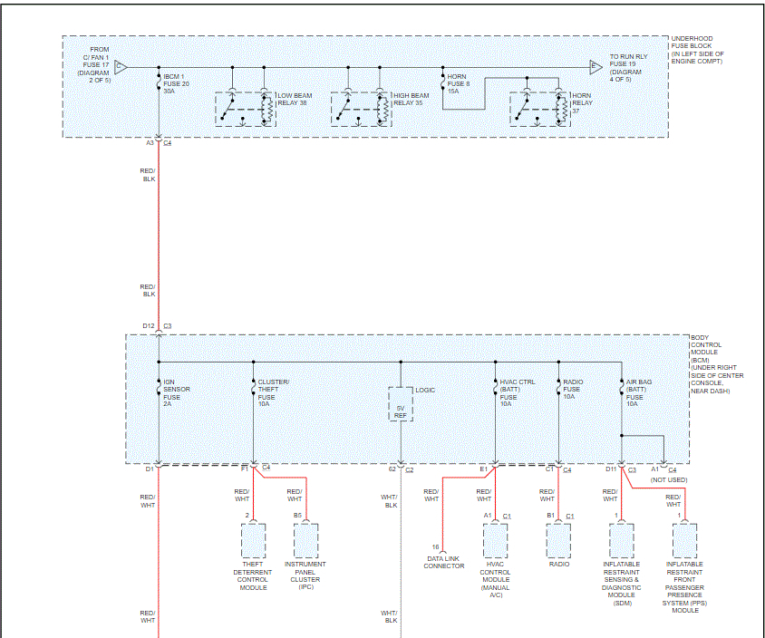

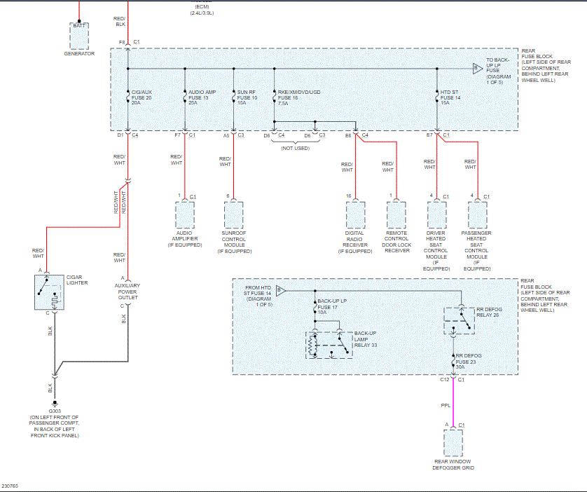

I don't know what point you are at, but I thought is may be helpful if I provided the power distribution schematics for the vehicle. Now there are five pages of schematics related to just power distribution. To make it readable, I had cut them each into two parts. I did overlap them and keep them in order so you can follow them. See if this helps.
Let us know
Feb 7, 2020 at 5:58 PM

C2 and C4 do have some connections inside the vehicle, mainly at the interior fuse panels and dash however you would need to gut the interior and remove the dash and HVAC unit to get to all of the smaller ones that run inside. They have some connections like grounds and power that bypass those main pieces.
What you may want to do is sign up for one of the sites like the Mitchell DIY or Alldata DIY sites and look at all of the OEM wiring diagrams. Those generally show the connections better than the redrawn color versions. Just be prepared, unlike the redrawn ones the OEM is broken down into individual systems, they don't show a composite. So you need to note which connectors are where and what other wiring runs to them.
There was a great free service for them but because a lot of folks started using it they shut it down!
