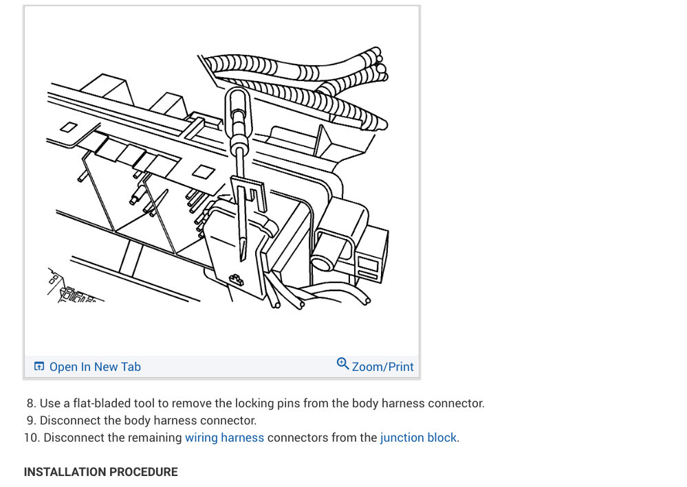

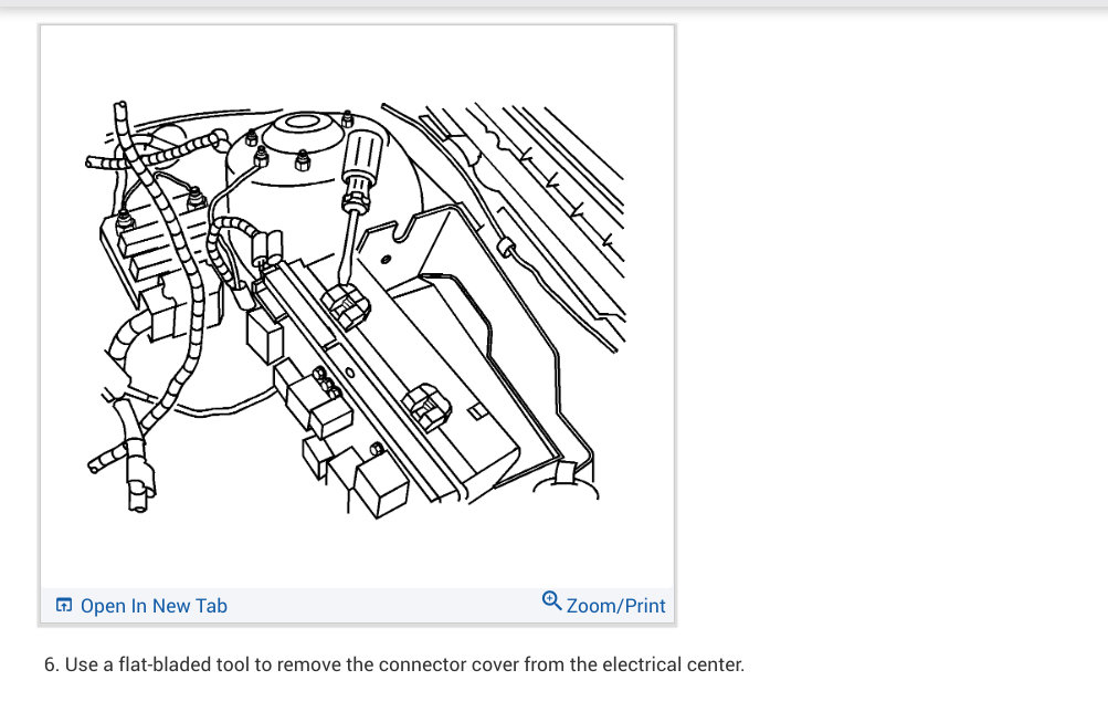

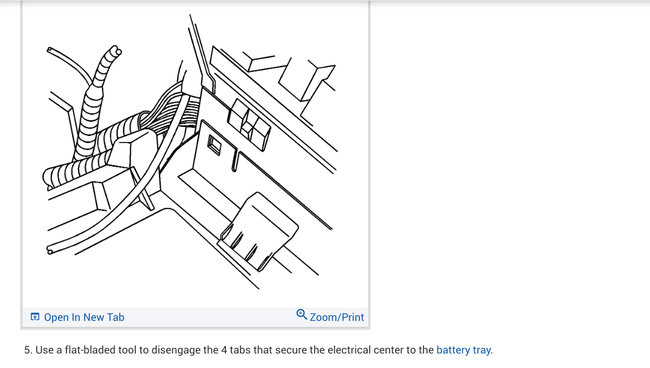

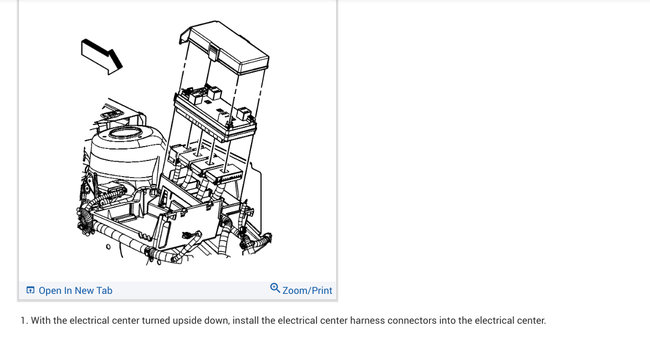

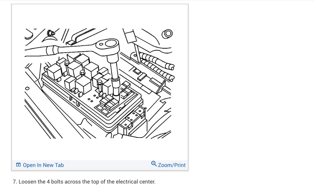

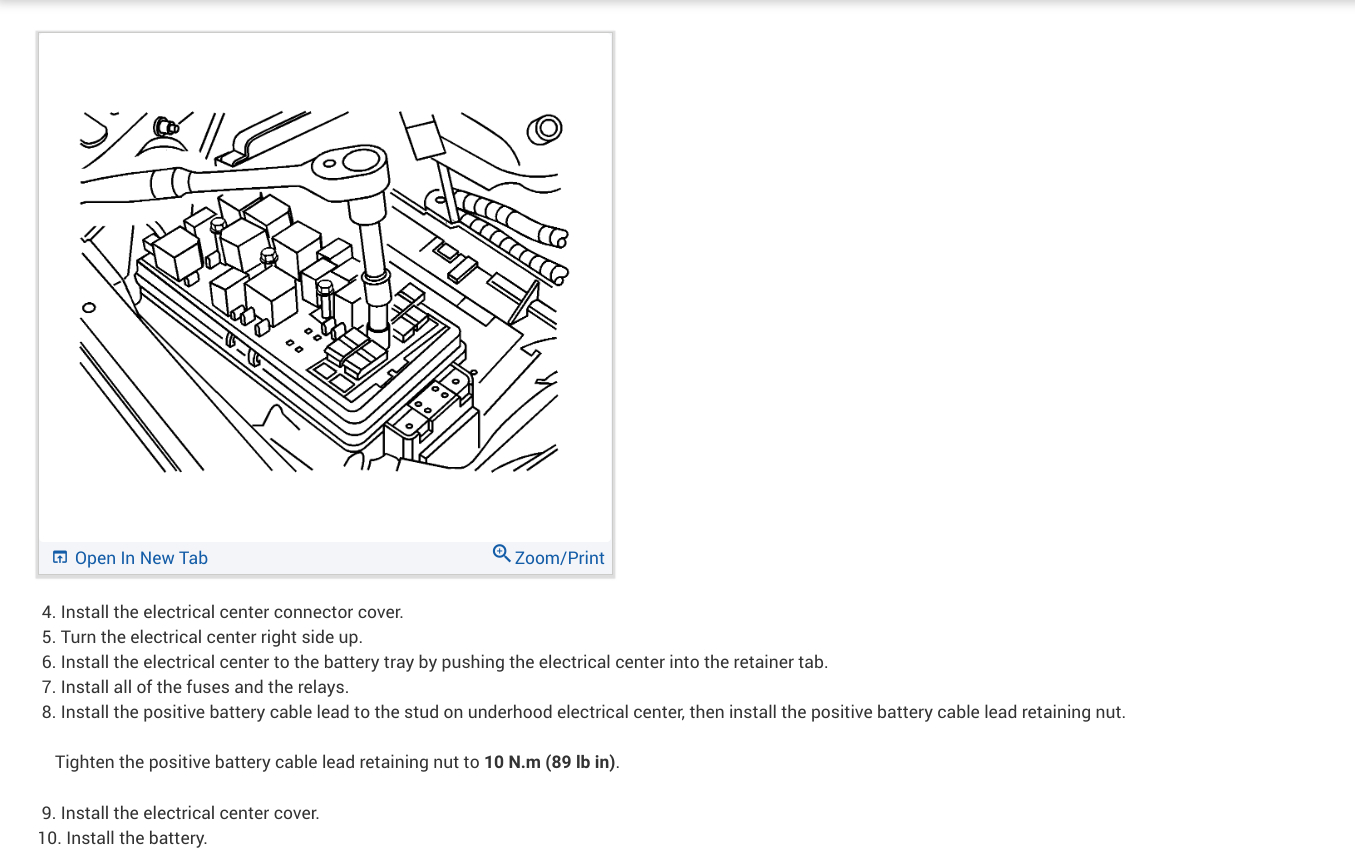

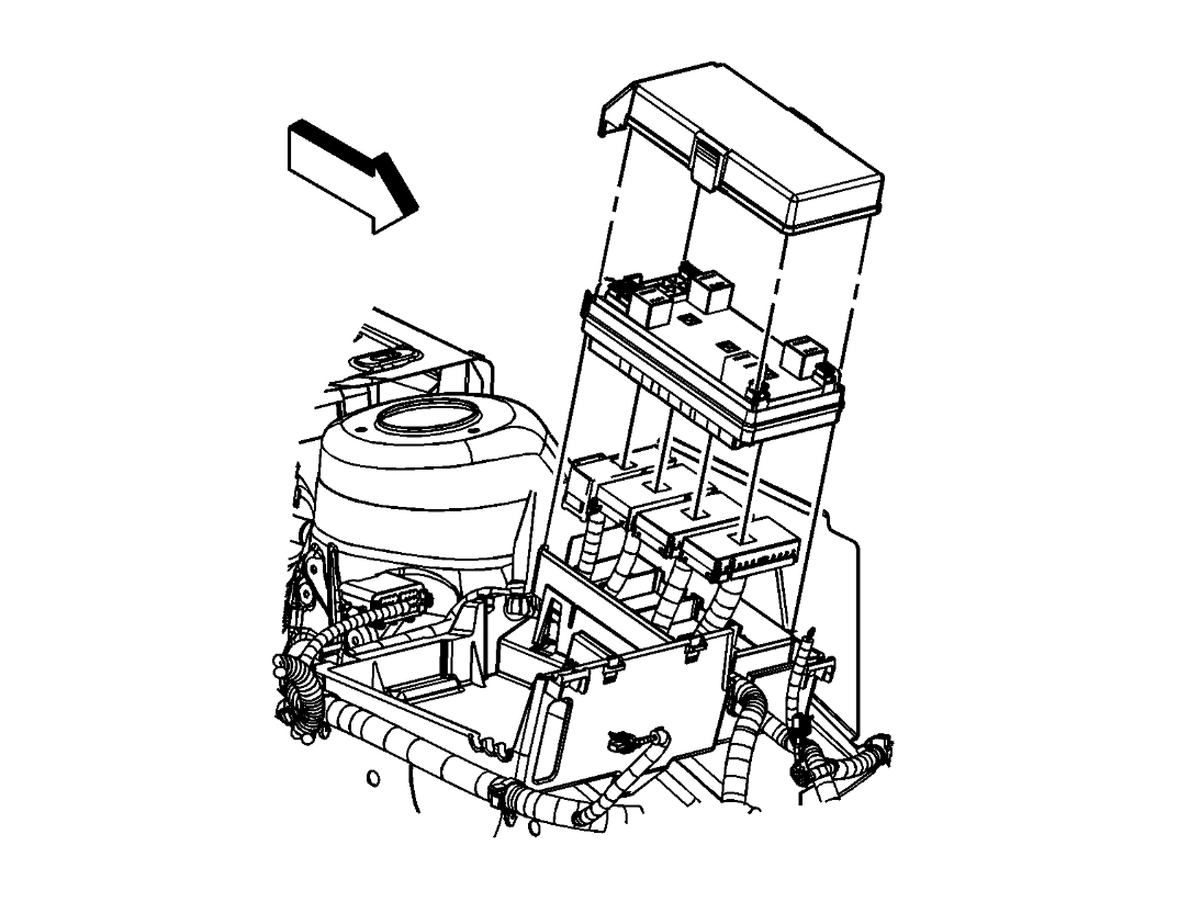

After extensive testing, I noticed multiple loose (and about to fail) relays and fuses in the block in the engine compartment. Putting the ignition key in the on position and touching certain fuses and relays caused intermittent loss of power to multiple systems (mainly the cranking, starting and ignition). I have access to another block from a compatible G6. Should I proceed with the "transplant?" And will I need reprogramming of any sort? Other issues?
