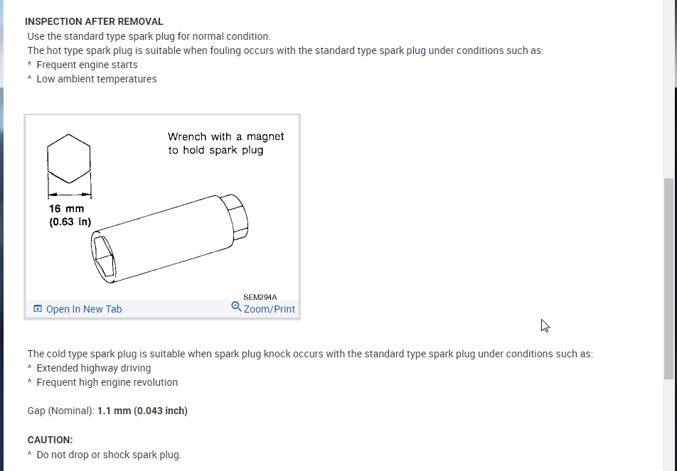

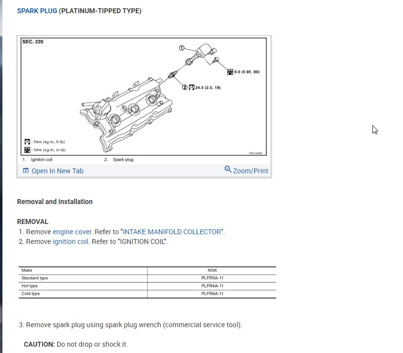

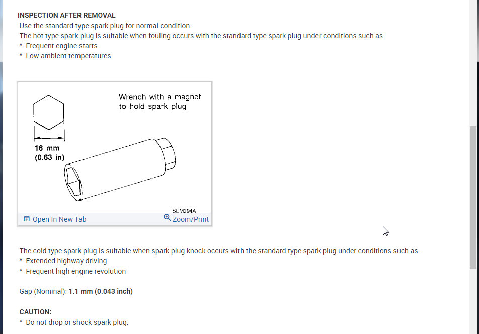

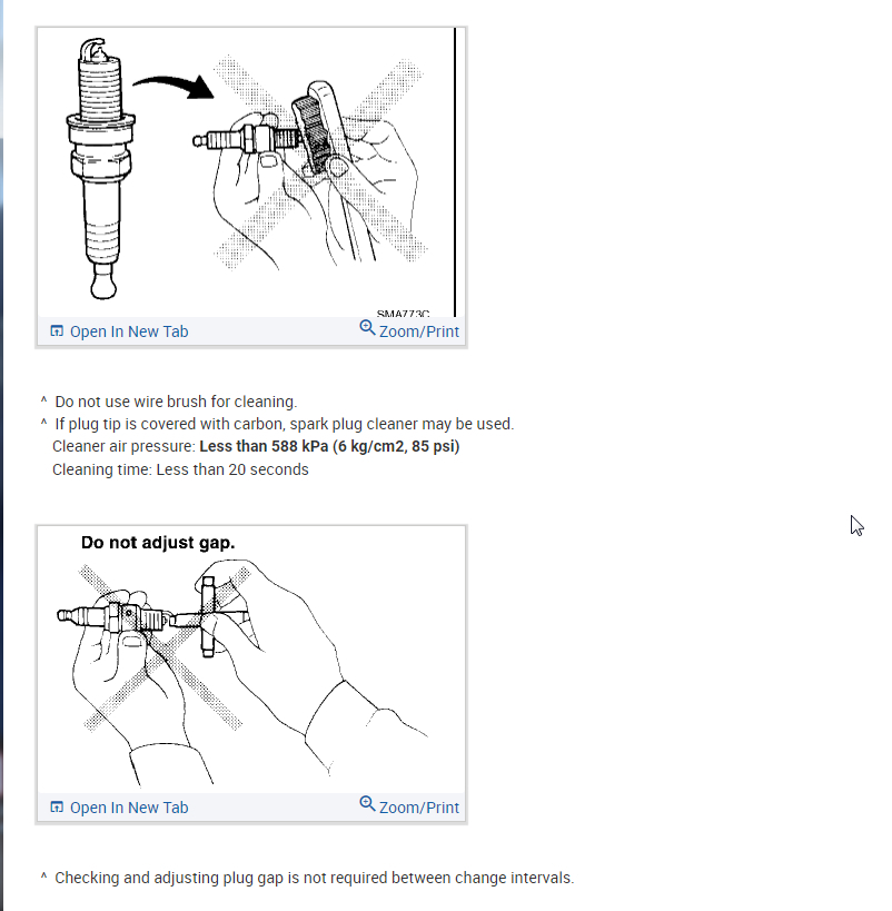

This could just be spark plugs or injectors but we need to do some inspections first. Here are some guides that will help with misfire issues:
https://youtu.be/e3YCZa2Ygpo
https://youtu.be/QTE8k06MzwQ
If you are going to buy this vehicle but it has misfires, I would not buy it unless they allow a compression check to make sure the engine is sound. If it is not then it could be very costly.
Here is a guide that will help with misfires:
I attached the process below on how to change the plugs if that proves out to be the issue.
Let us know if you have questions. Thanks
