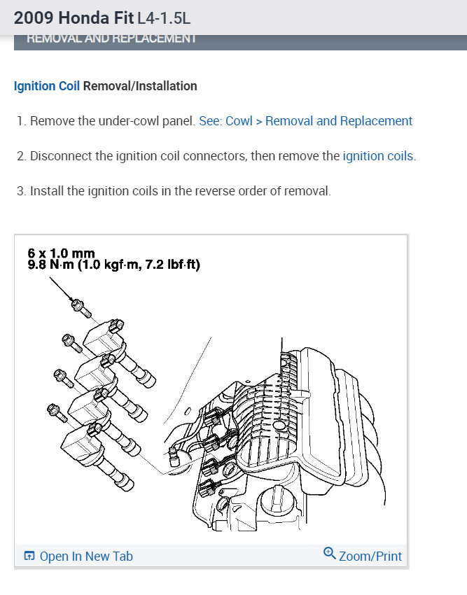

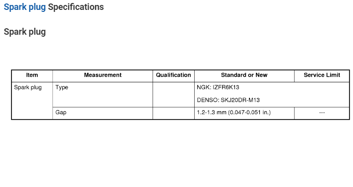

This happens when the engine is misfiring, have you performed a tune up lately?
Here are some guides to help us:
https://www.2carpros.com/articles/how-to-tune-up-a-car-engine
Here is how the job is done on your car in the images below. I would install new ignition coils as well. Check out the images (below). Let us know what happens and please upload pictures or videos of the problem so we can see what's going on.
