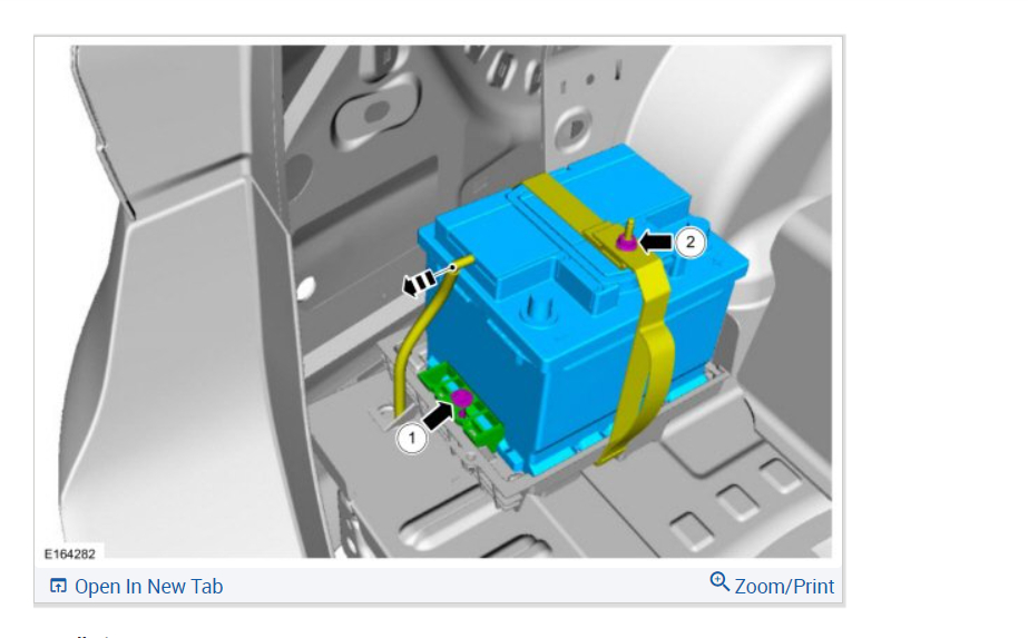

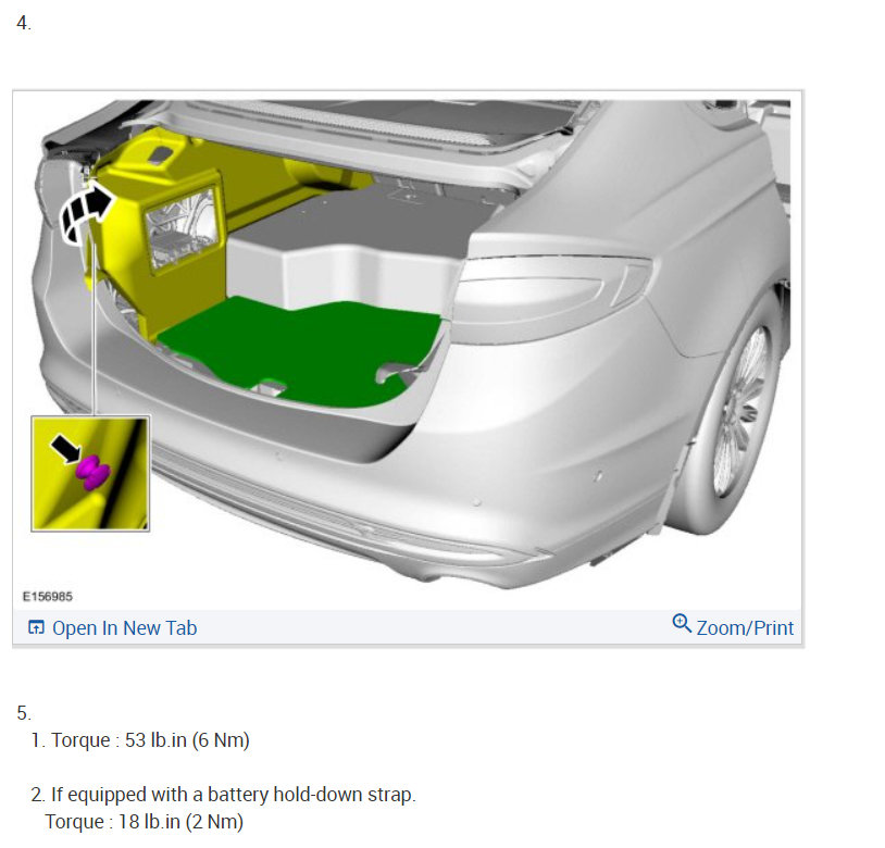

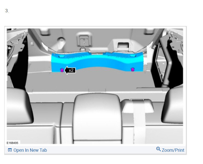

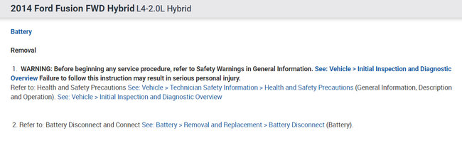

Can my car listed above be jump started by a 2017 Chevrolet Silverado?
May 20, 2021 at 9:01 AM
Should be able to. this video will help with the battery location in the diagrams below:
