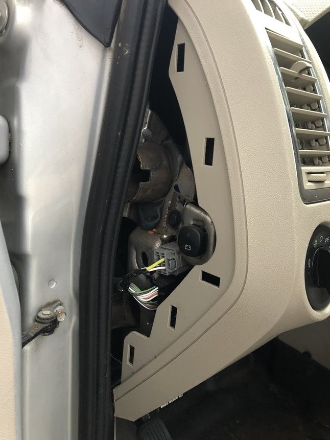

Good day,
This button is for helping of low voltage battery, am I right?
How and in which situation it can be used?

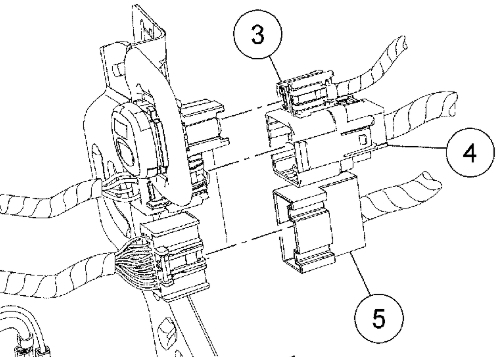

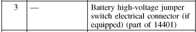

That is called the battery high-voltage jumper switch. I've attached two pictures below.Do you need to know how to use or its function? Hope this helps and thanks for using 2CarPros.
