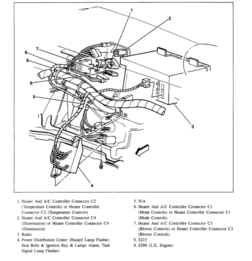

Blinkers work when they want to.
May 20, 2021 at 2:51 PM

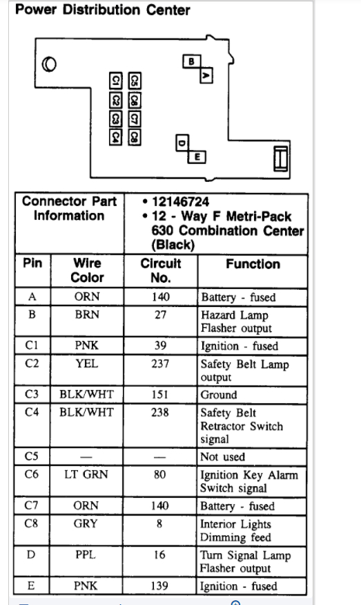

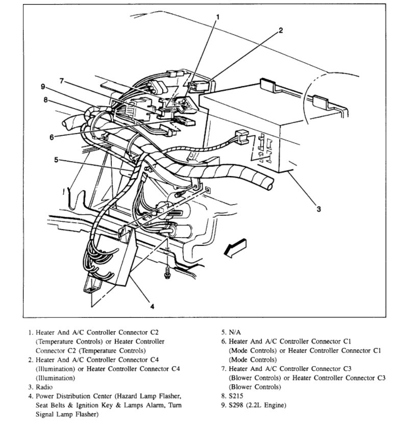

This is common when the flasher goes out. here is the location so you can change it out. Check out the diagrams (below). Let us know what happens and please upload pictures or videos of the problem. The Turn Signal Flasher is located in the Power Distribution Center. The Power Distribution Center is located behind the lower center of Instrument Panel.
