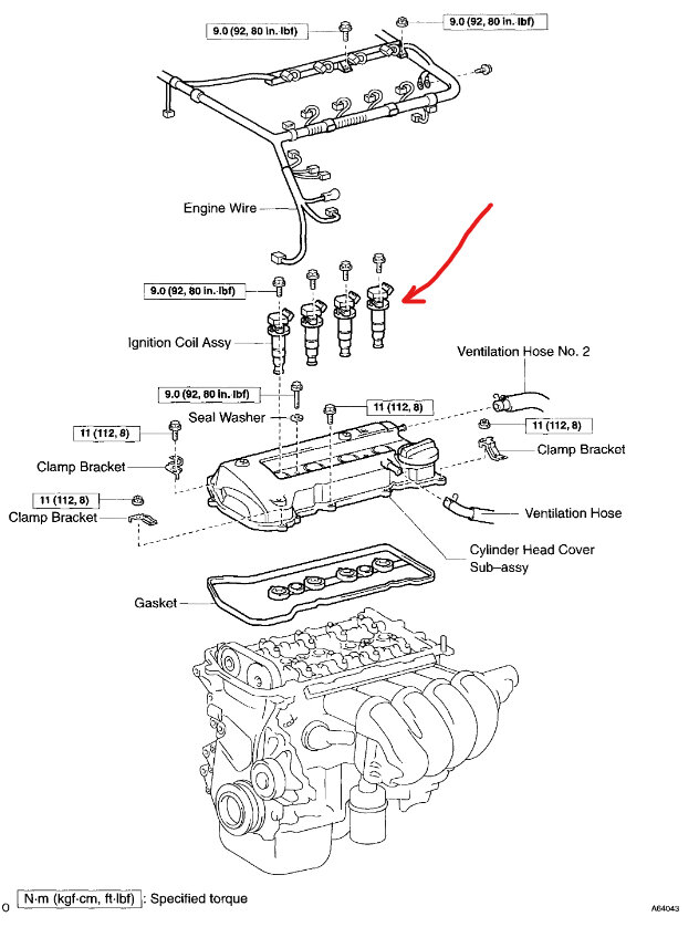

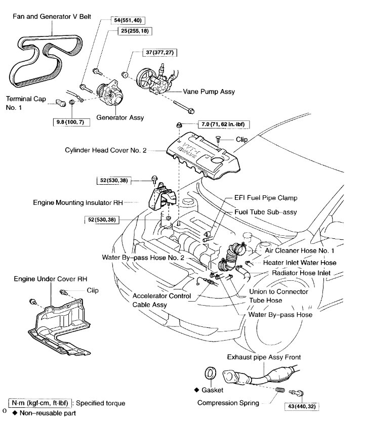

The jerking can be an engine misfire, I would run the codes to see which ones are stored, I can tell you a cracked spark plug or bad ignition coils is common for an engine misfire. These guides can help please go over them.
and
https://www.2carpros.com/articles/engine-misfires-or-runs-rough
RECOMMENDED SPARK PLUGS:
. .................... SK16R11 (DENSO made)
. .................... IFR5A11 (NGK made)
Check out the images (below). Please upload pictures or videos in your response of any problems so we can see what to help you with.
