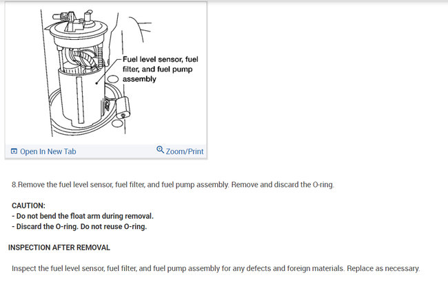

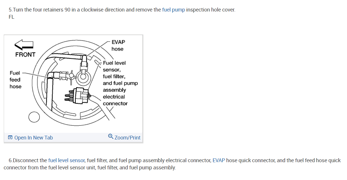

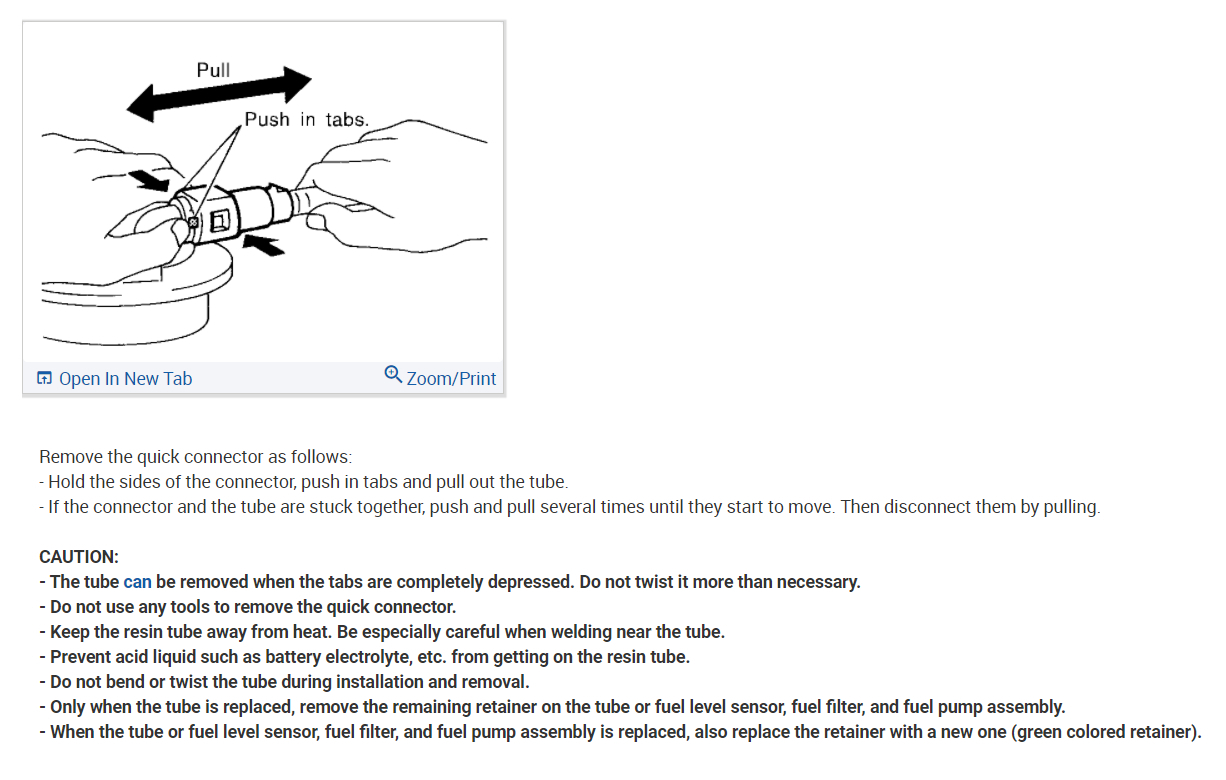

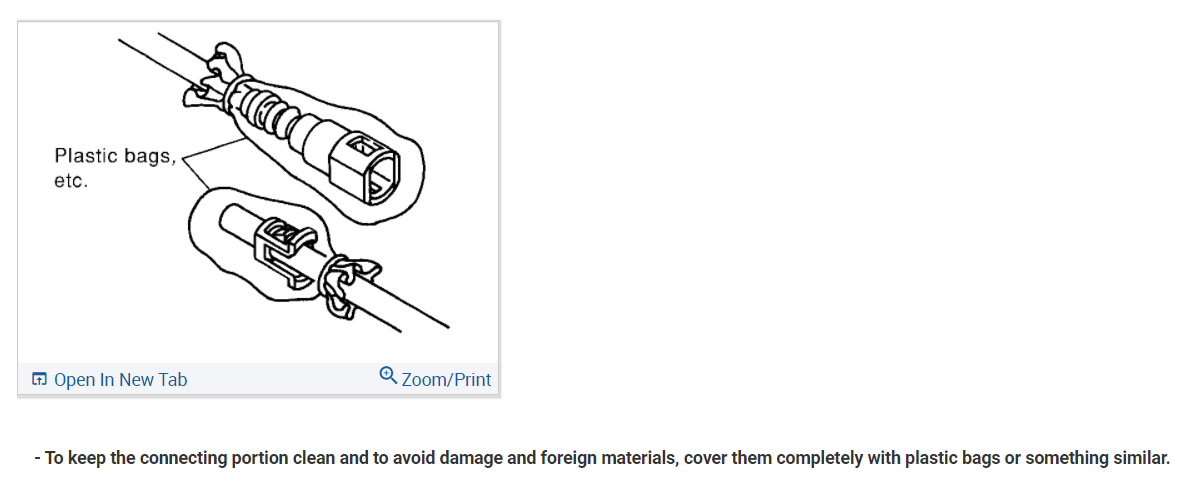

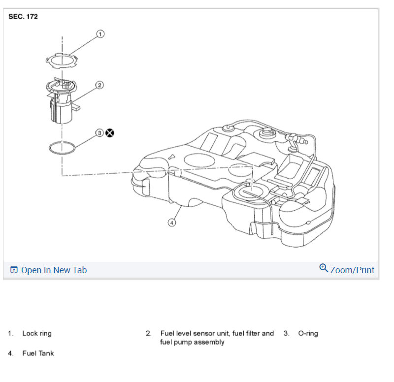

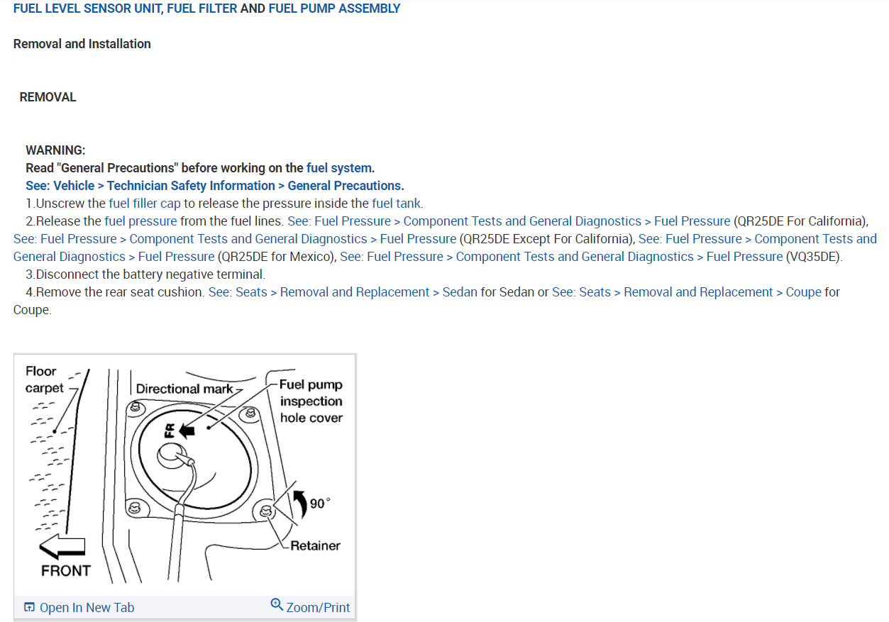

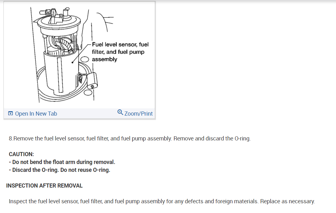

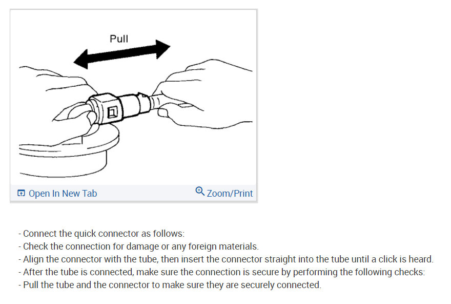

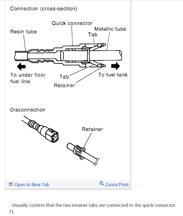

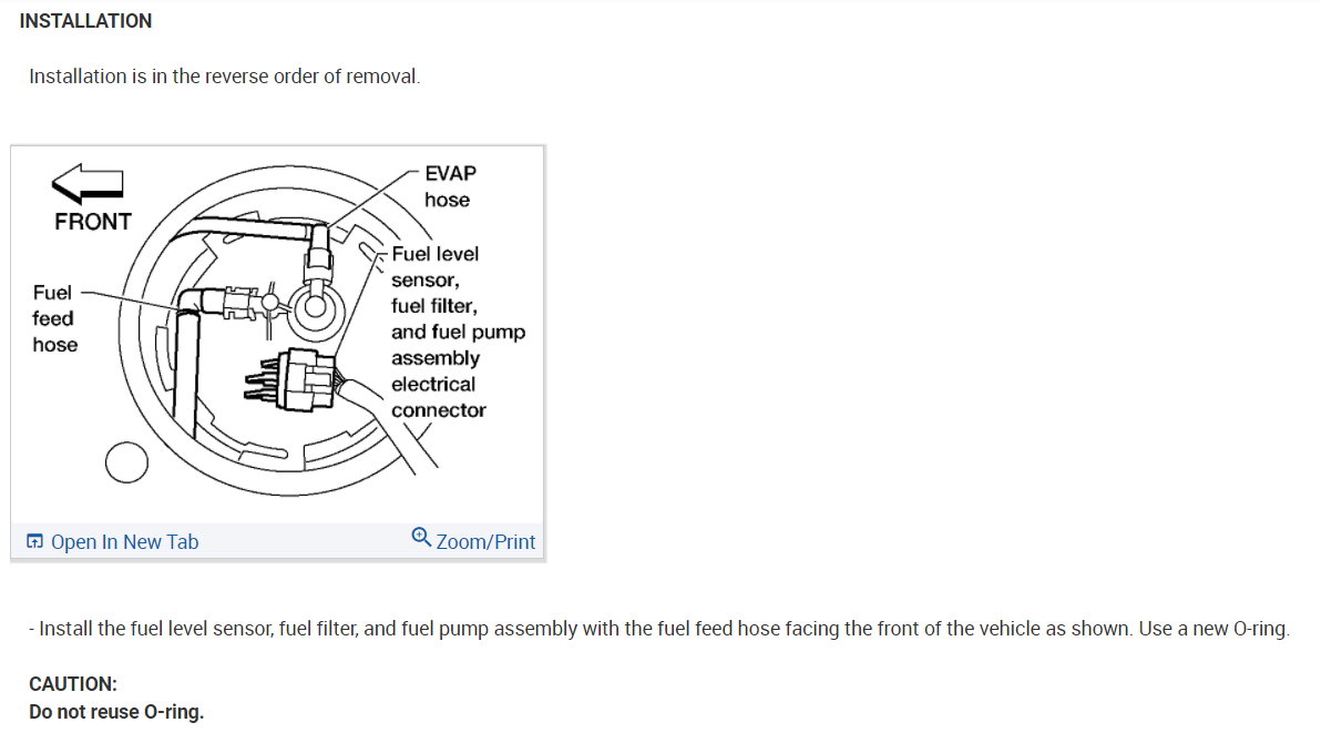

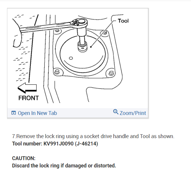

Here is a guide to help you step by step with instructions in the diagrams below to show you how on your car. For your car the fuel pump can be accessed through a tap door so you don't need to drop the tank :)
This video shows the job being done on a similar car but the process is the same.
https://youtu.be/h_VHxBmecj8
Check out the diagrams (Below). Let us know what happens and please upload pictures or videos of the problem.

Hey steve thank you for your replay. I finally found a new pump and it fixed the problem thank you.
