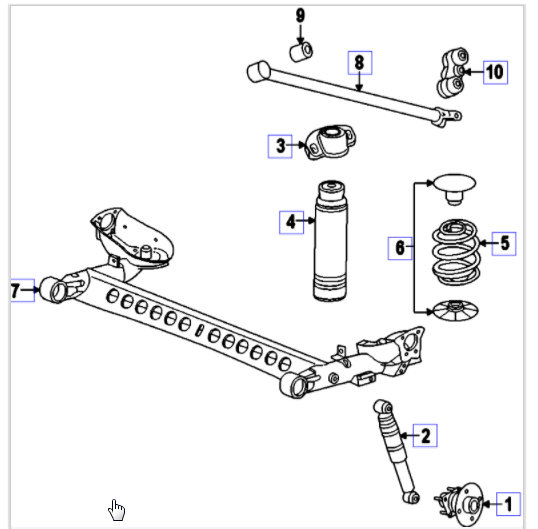

Also, you could lift the rear end and spin the wheels by hand and see if they are spinning straight. If not, then we have something bent.
Below is a diagram of what the suspension components are so you can see if anything is bent.
