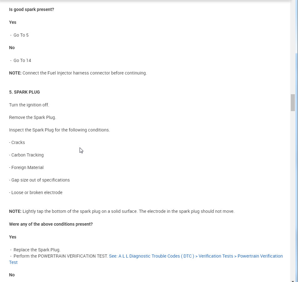

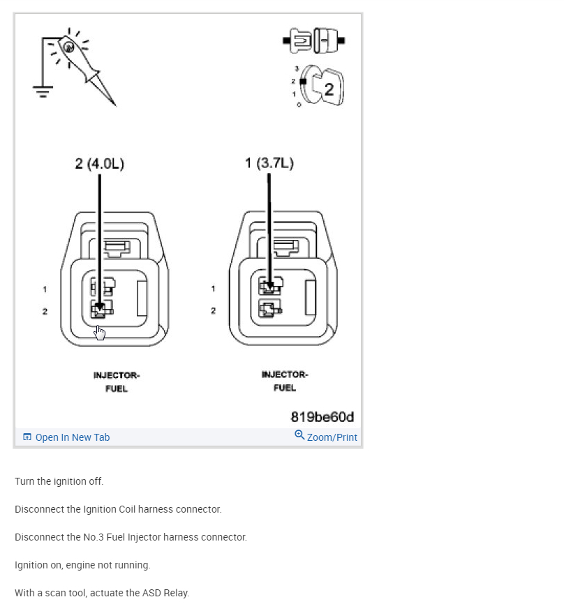

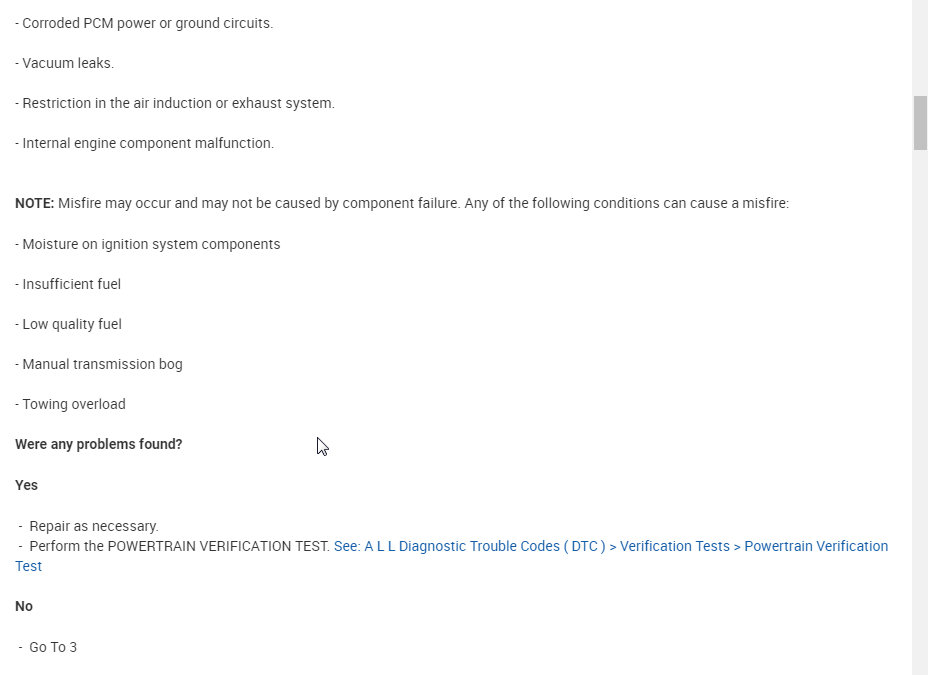

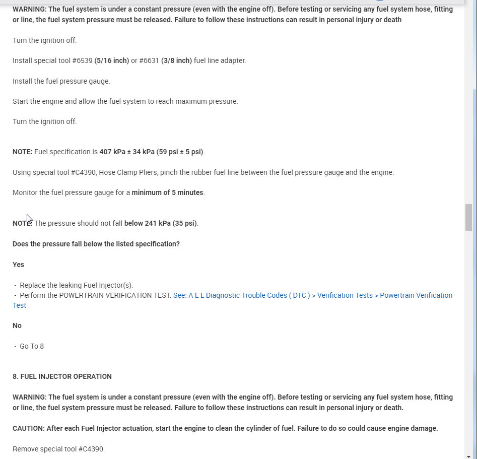

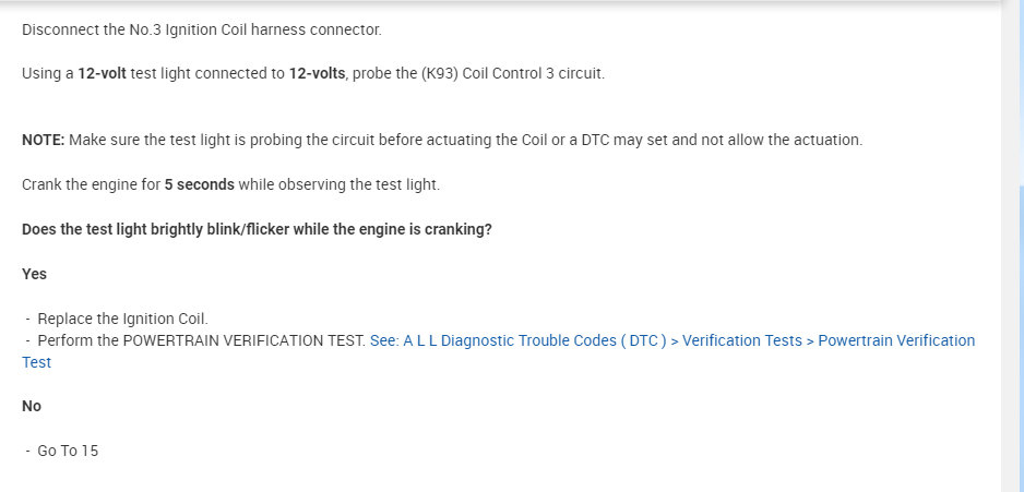

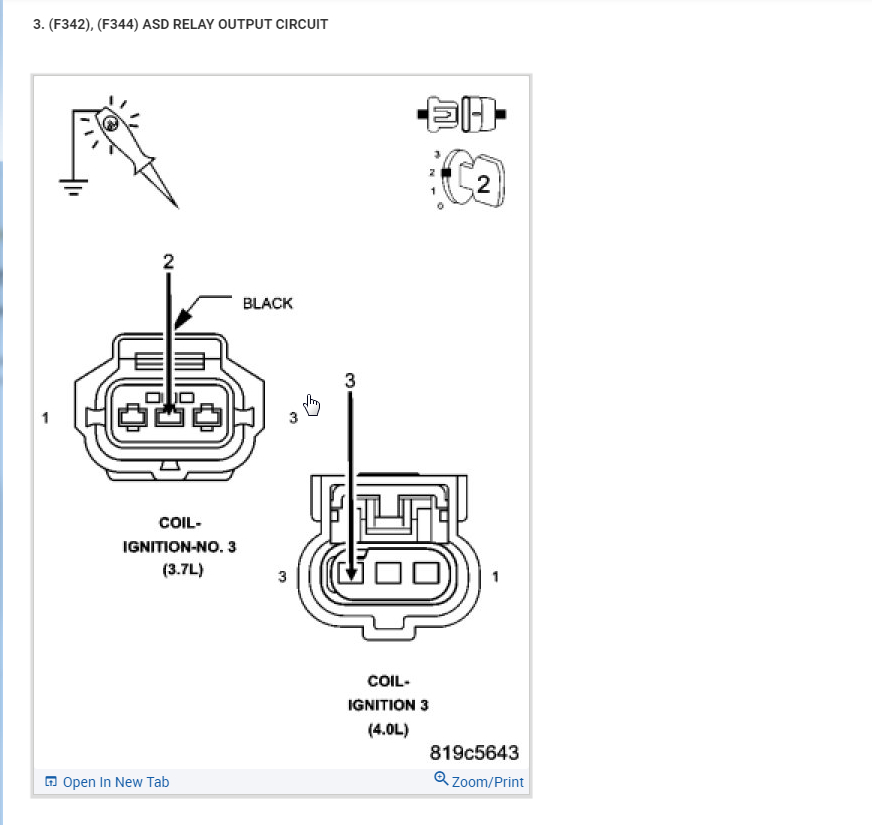

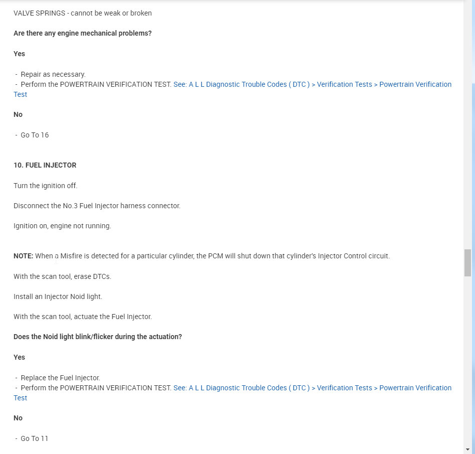

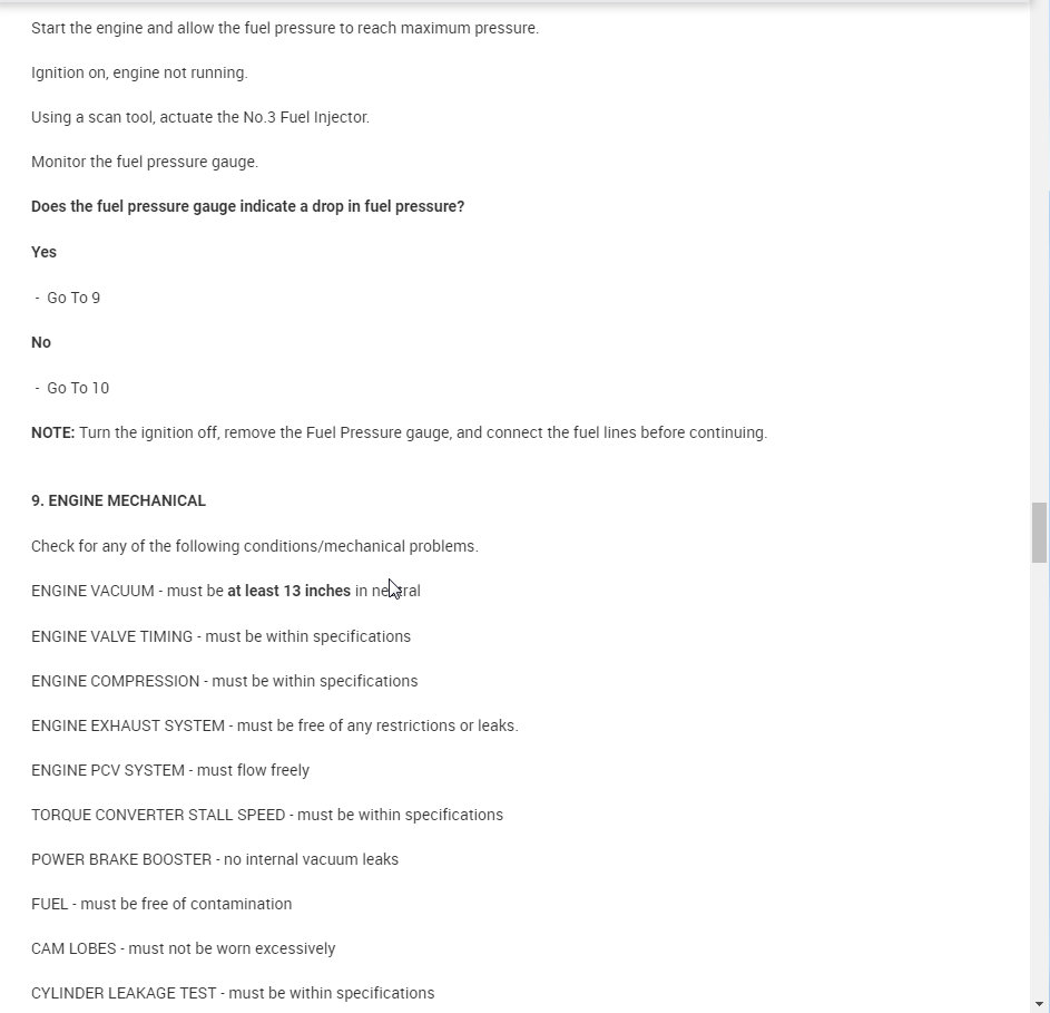

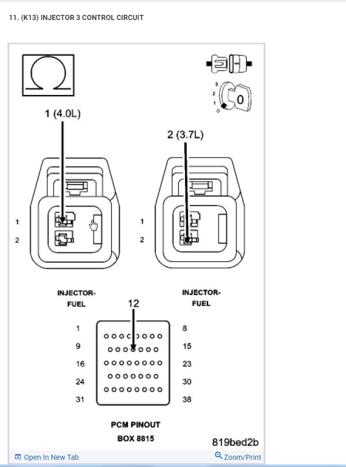

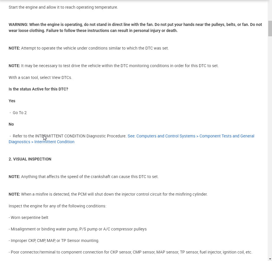

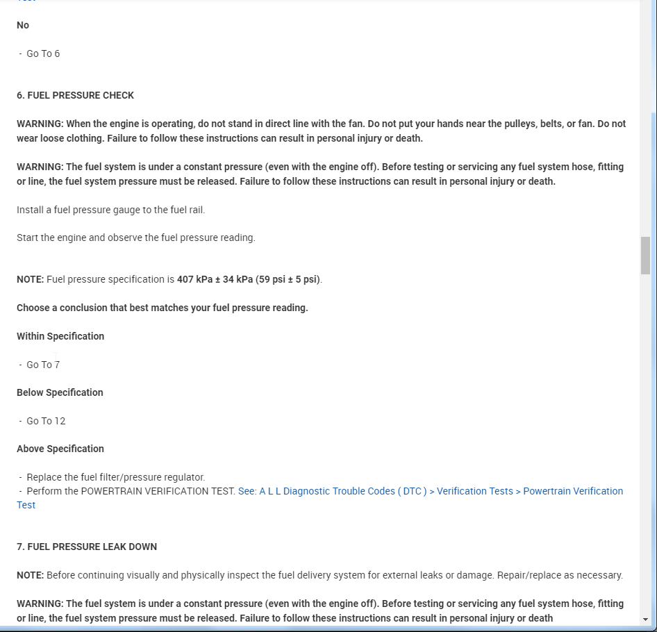

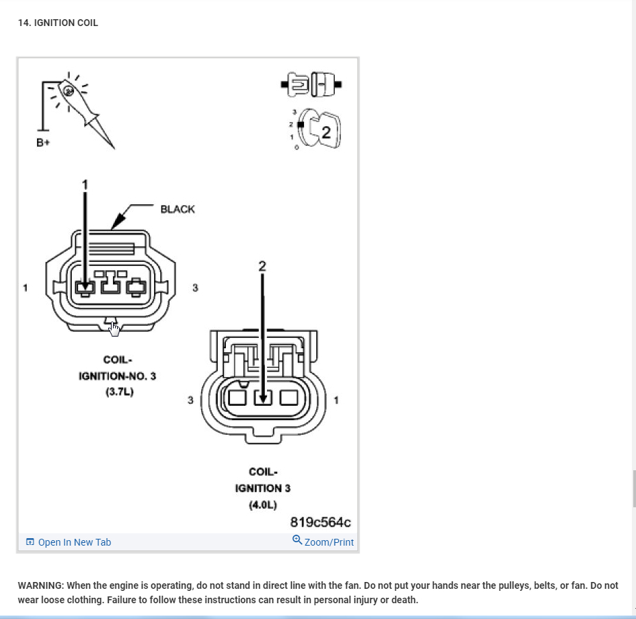

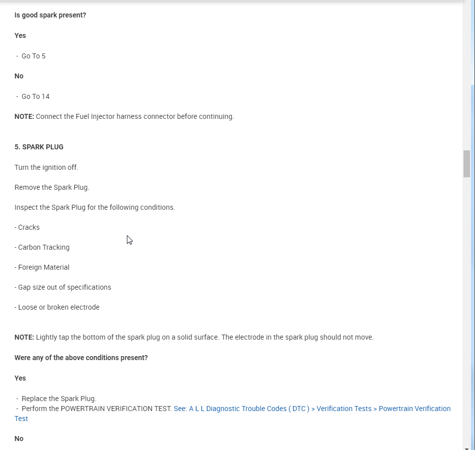

Tuning ruff and jerking as it goes down the road. The service engine light is on and the etc light stays on. Replaced the Crankshaft sensor in May. The # 3 Cylinder on the diagnostic test from the auto parts store shows that it’s misfiring. I replace the plug in the coil pack already.
