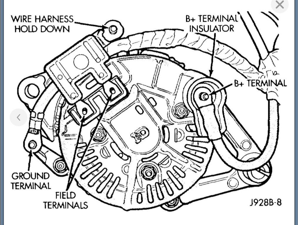

I have a 1994 jeep wrangler yj. I am having a brain fart and can not remember the locations on the wires on my alternator. That is where the wires connect to the alternator.
Thanks in advance,
