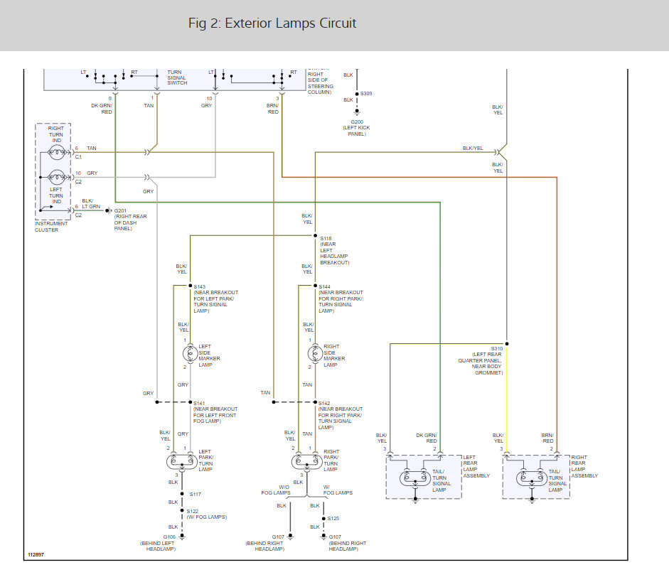

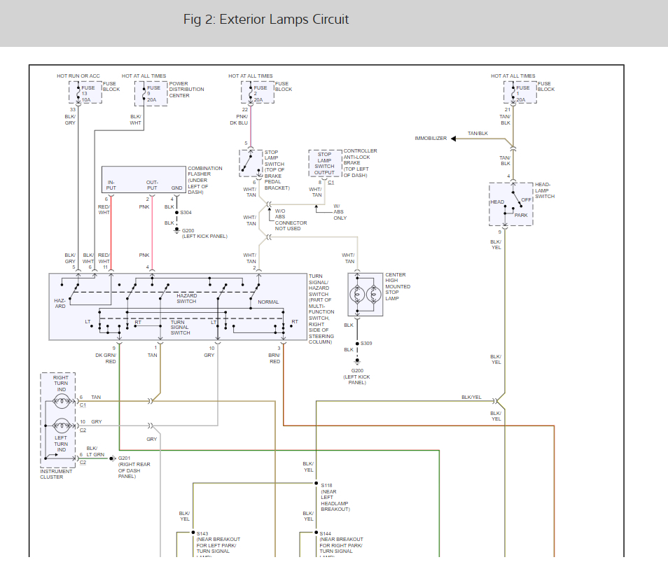

it sounds like the turn signal switch is bad but to be sure here are the blinker wiring diagrams and a guide to help test it.
Check out the diagrams (Below). Please let us know what you find. We are interested to see what it is.
