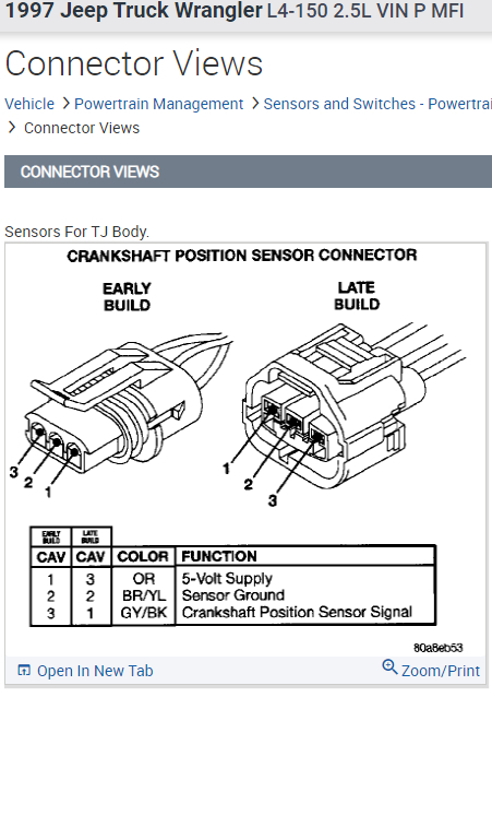

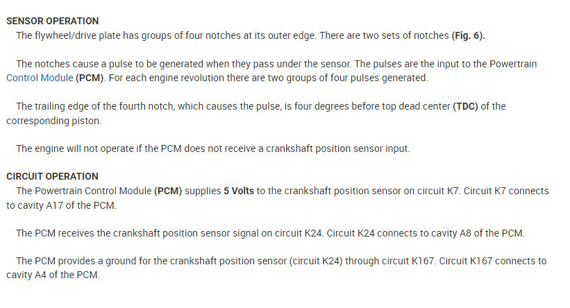

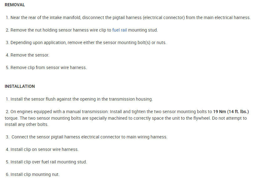

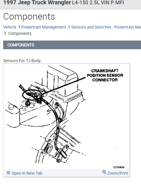

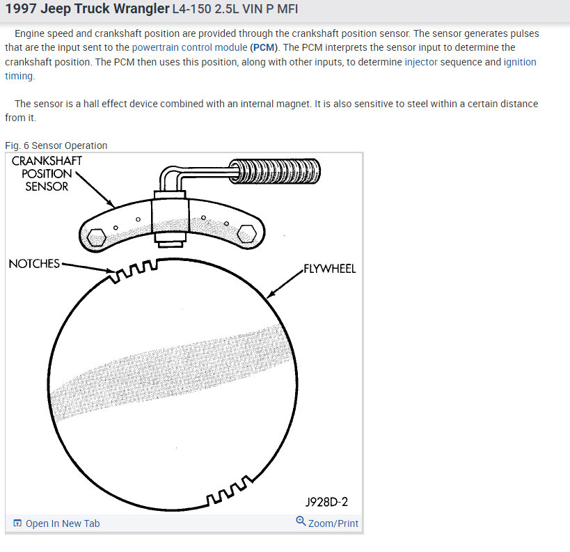

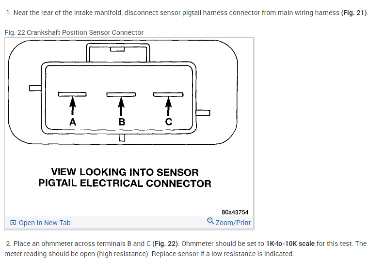

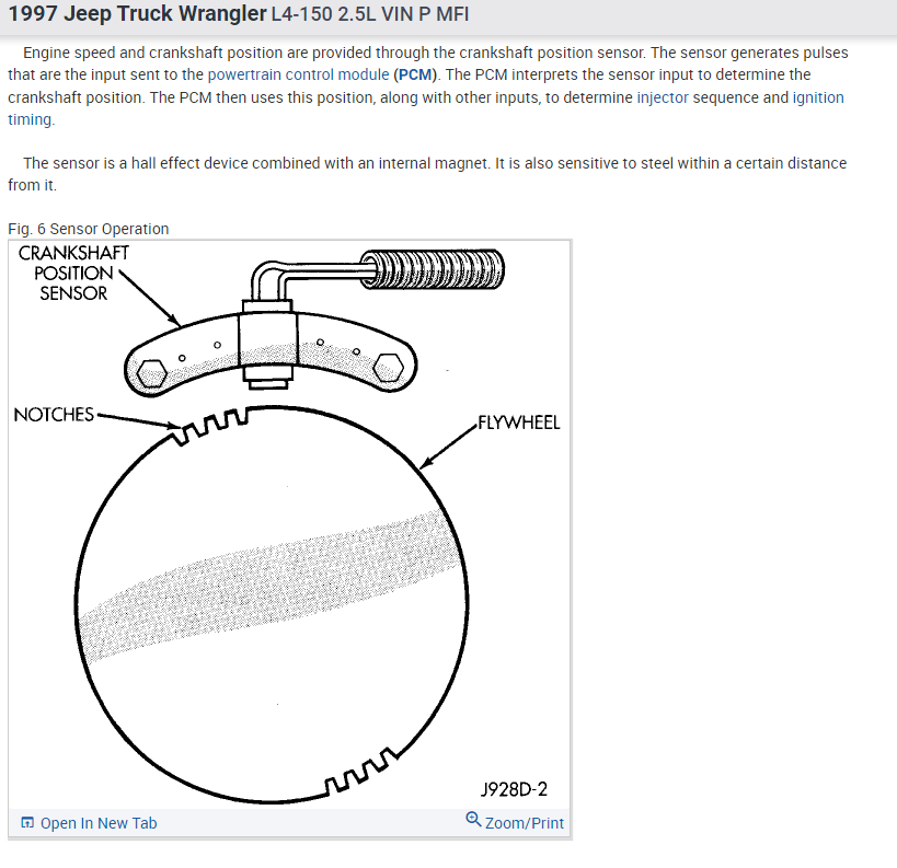

Typically an engine will stall for a faulty crank sensor. Because a crankshaft position sensor is related to engine speed when they fail it may not trigger a CEL light. So it is not unusual for your vehicle not to give a trouble code.
You might find these articles helpful:
https://www.2carpros.com/articles/how-a-crank-shaft-angle-sensor-works

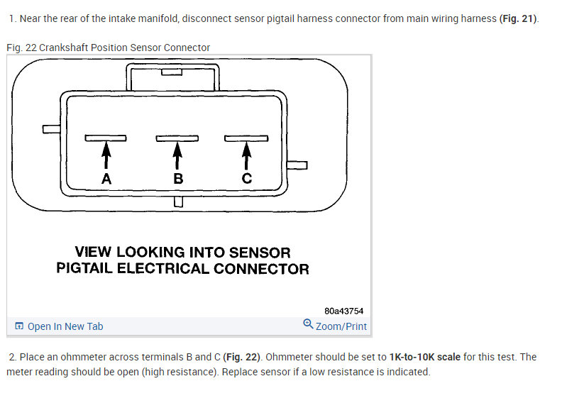

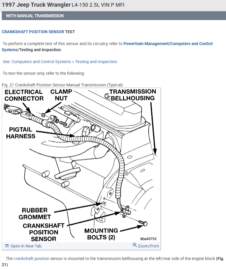

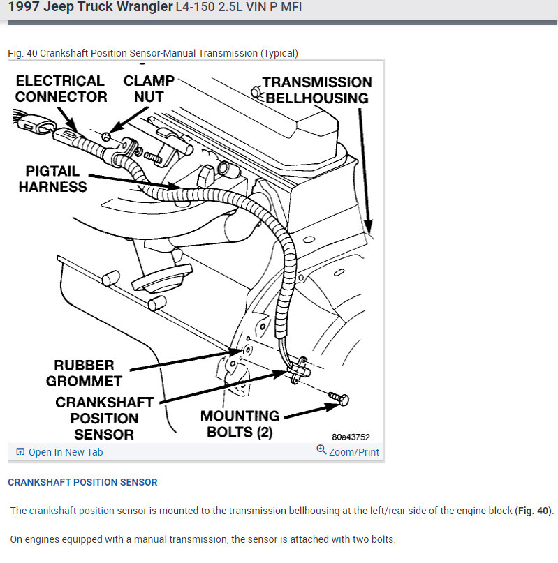

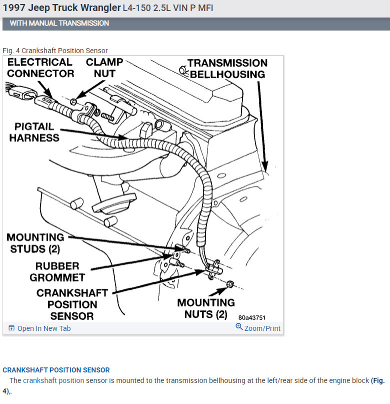

I have also included the replacement and diagnostics of the crank position sensor for your reference.
