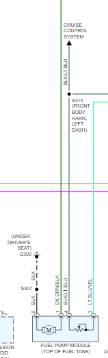

It sounds like you might be having an intermittent wiring issue like a short in the fuel pump circuit. I've attached a tutorial showing how to test wiring.

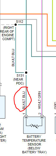

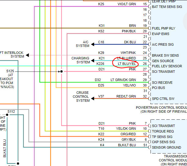

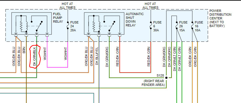

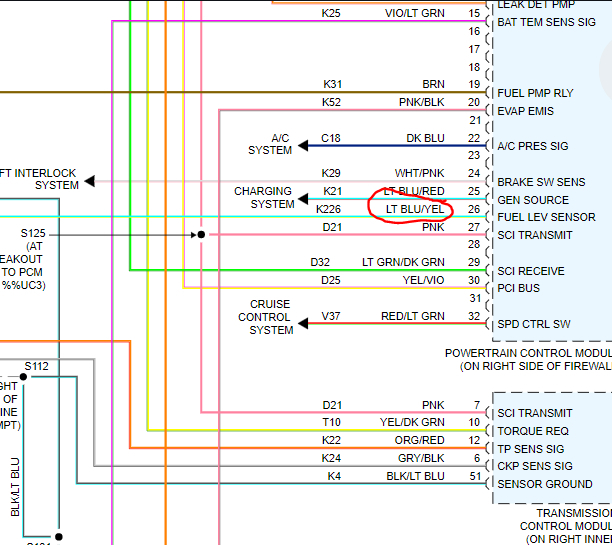

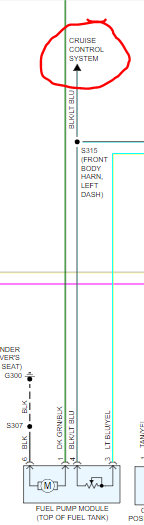

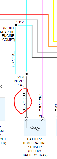

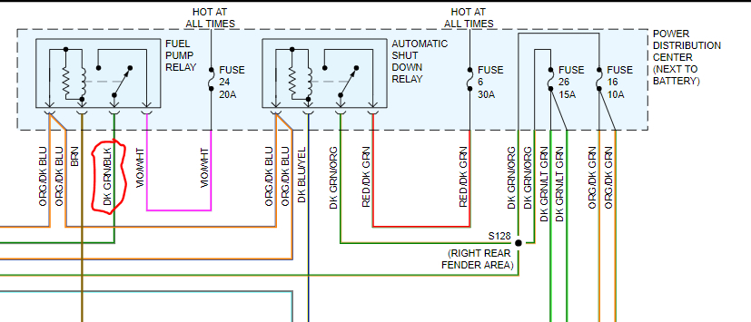

There are four wires in the fuel pump circuit. A black-ground, A dark green- black that goes to the power distribution box, A black-light blue that goes to the cruise control and battery temperature sensor, And a light blue-yellow that goes to the PCM- powertrain control module. I've attached the wiring diagram below and circled the wires in red. I would check to see if any of these wires are melted, shorted, rubbing, or in any other way causing this weird condition. Also be sure to check the ground. You might also want to test the fuel pump relay. Here is a tutorial showing how to test a relay:

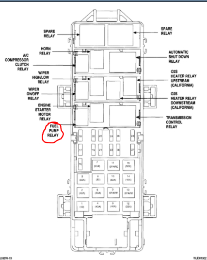

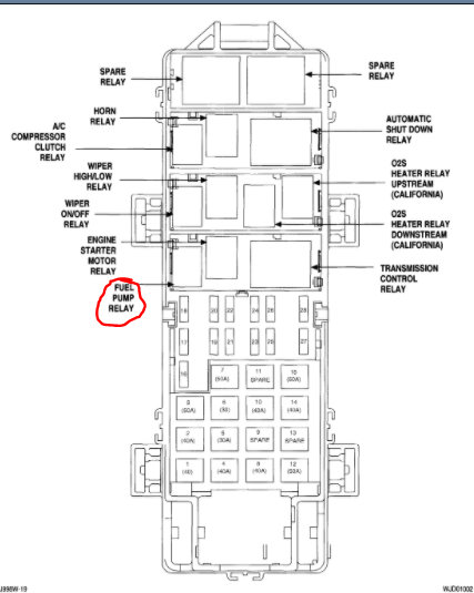

I've also attached a picture of the fuel pump relay which is located in the power distribution box under the hood. Get back to us if you have any further questions on this issue. Hope this helps and thanks for using 2CarPros.

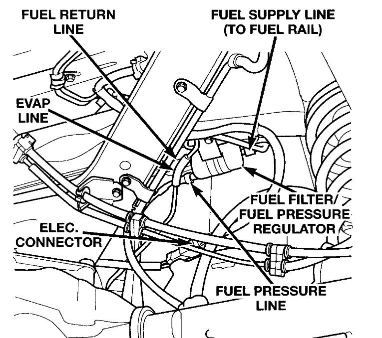

The 99 is the version with the fuel pressure regulator in the filter if I recall. I think you have a bad fuel pump and disconnecting the line is releasing the small amount of pressure it is creating and lets the pump run again. The pump could be turning just enough to create flow that will let the engine run but not enough to keep it running reliably. That would explain the zero PSI reading and not hearing the pump as well. A way to check that would be to remove the fuel pressure line that comes from the pump to the fuel filter, That would be the one that goes over the fuel line connection on the filter on the side with two ports. The other one that plugs into the filter is the return line. With that line off, connect the pressure gauge to that line, then turn on the key. This should show you the dead head fuel pump pressure so don't let it run very long. Just long enough to get a pressure reading, which should be only a second if the pump is good. You should see a minimum of 50 PSI but it should be higher. The regulator is supposed to allow the pressure at the engine to run at 50 PSI but the pump should put out much more almost instantly. I suspect you will see either very low pressure or it will build very slowly if the pump is bad.

You will need to adapt one or go to one of the parts stores that loans tools and see if they have one of the master kits that has a bunch of adapters to fit it. That or get one of the hose end repair fittings that fit into the line like the end of the filter then you could use hose clamps and a short section of fuel line.
