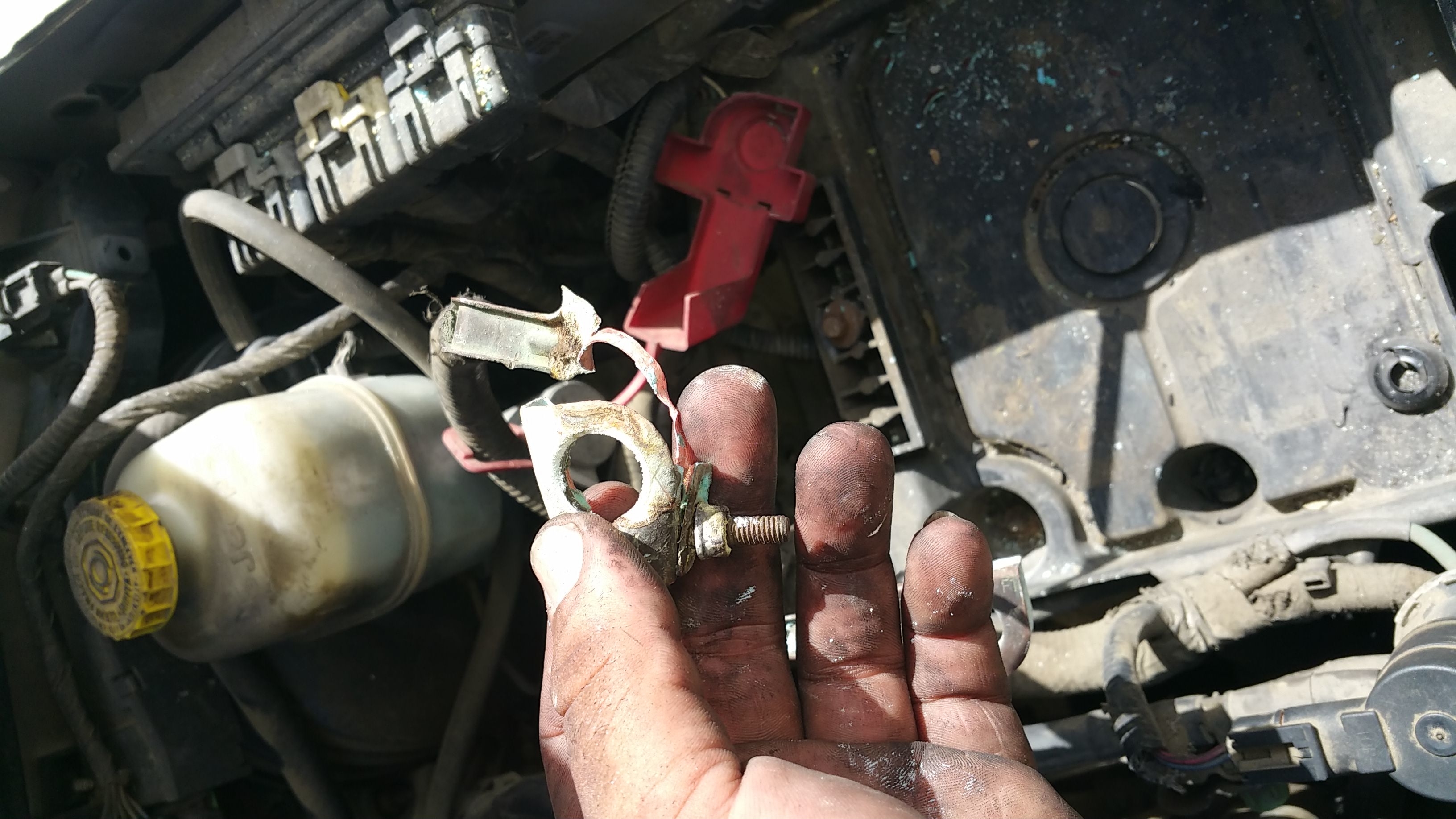

Hi, firstly thank you for your reply. I bought a replacement pump that went inside the gas tank, the top piece that connects all. The hoses etc., I reused (not sure if that is the strainer ), I also changed the filter on the tank. About the battery running dead I have had a voltmeter in the Jeep for a few months now it has always read 12 volts an up, but yesterday I disconnected the battery to see if any wires at the bottom maybe touching. I also cleaned the throttle body and sensors, while putting the battery back on the terminal just fell apart in my hand (see picture). My hope is that the terminal was not giving enough power, when I go over speed bumps so how it knocks the terminal loose? I am going the change the terminal and also do that relearn technique for the computer you provided? I will post my results.
Aug 13, 2018 at 4:56 AM
