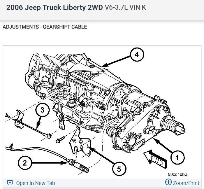

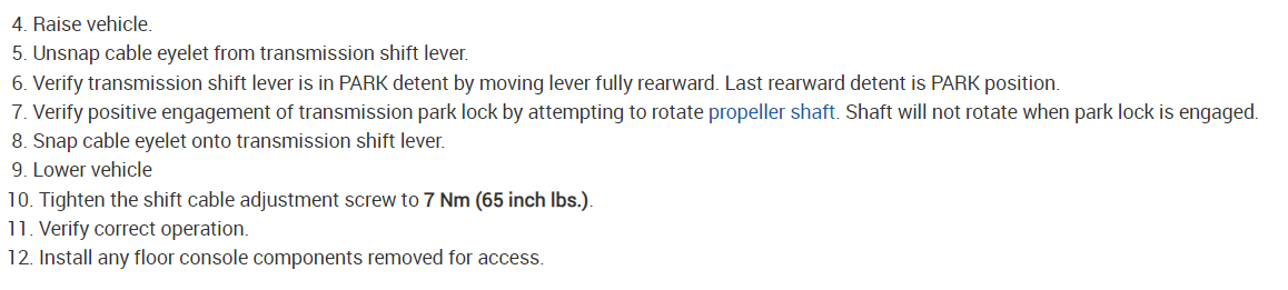

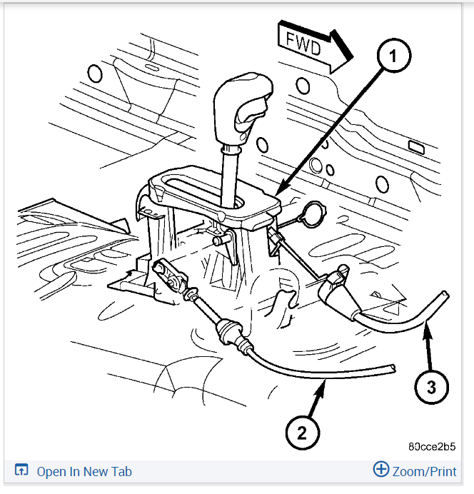

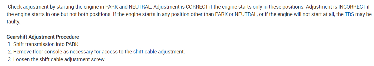

This happens when the shifter is not adjusted correctly which makes the key think the car is still in gear. Here is how to adjust the shift cable to help fix the problem. Check out the images (below). Let us know if you need anything else.
