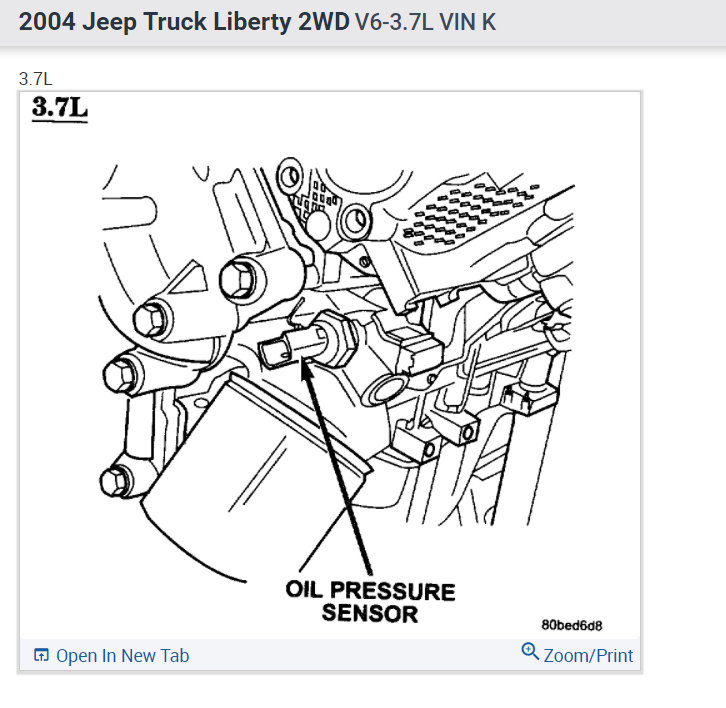

the oil light comes on intermittently and not sure why.it is full of oil and i always use synthetic oil.do you think it's a sensor?

the oil pressure sensor is down by the oil filter. Check out the diagrams (below). Please let us know if you need anything else to get the problem fixed.

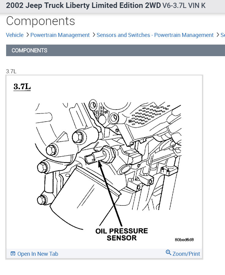

Where is the oil pressure sensor located on a 2002 Jeep Liberty 3.7L? What is involved with replacing it?

Its on lower left front of engine above oil filter-unplug it then remove the sensor. Check out the diagrams (Below). Please let us know if you need anything else to get the problem fixed.

the oil lihgt comes on while driven and at a stop. but then again the light will not come on at all.could it be the senser.if so where it would be located.

the engine oil pressure sensor is located on the lower left front of engine,above the oil filter. you may want to check the oil pressure with a mechanical oil pressure gauge, if it really is low then could be a failing oil pump.
