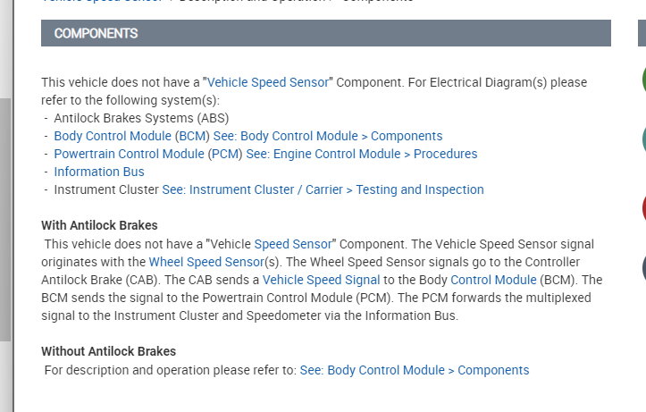

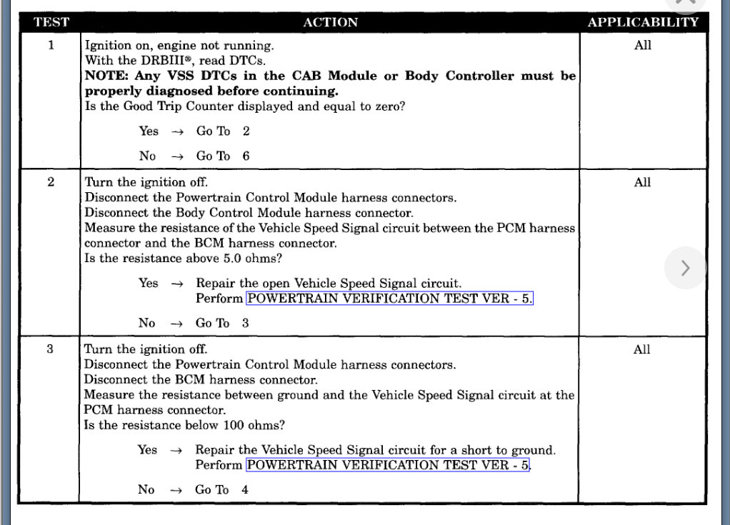

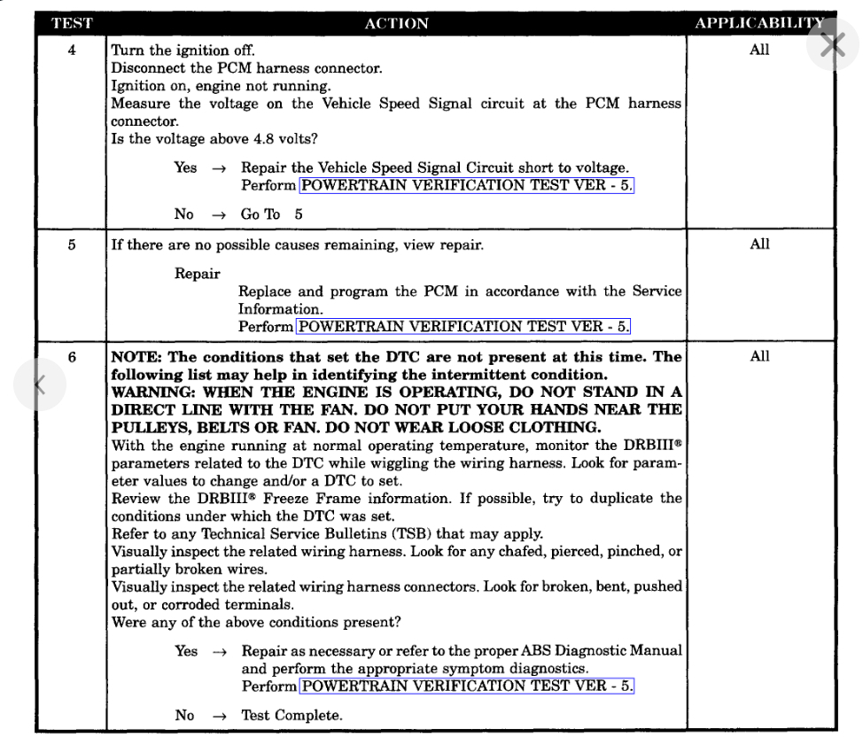

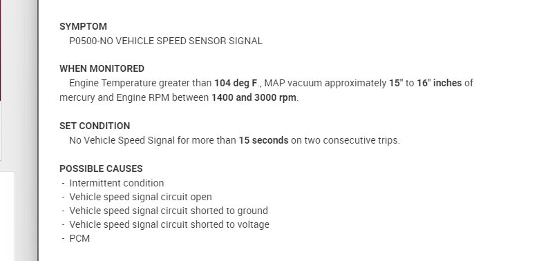

This code is not going to be a sensor issue because it is more than likely you have antilock brakes, so there is no speed sensor. The BCM gets all the wheel speed signals and then it calculates the vehicle speed using these sensors. It is more likely a circuit issue or even a PCM issue.
So, what I would recommend is we run through the testing that is attached below and let me know if you have questions on this.
Please see all the info below on this and let me know what you find. Thanks
