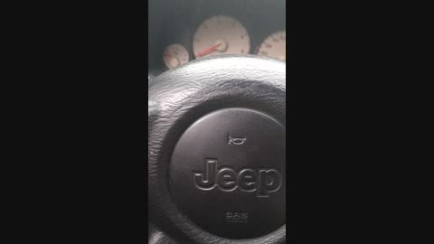

KAILEY
  • 6 POSTS
This is what happens when starting:
Sep 24, 2018 at 3:44 PM
It should be 100%. Let it charge up all the way.
Those are the fault codes for the check engine light.
Your mechanic based his guess on codes that he saw. Those are the codes I need.
