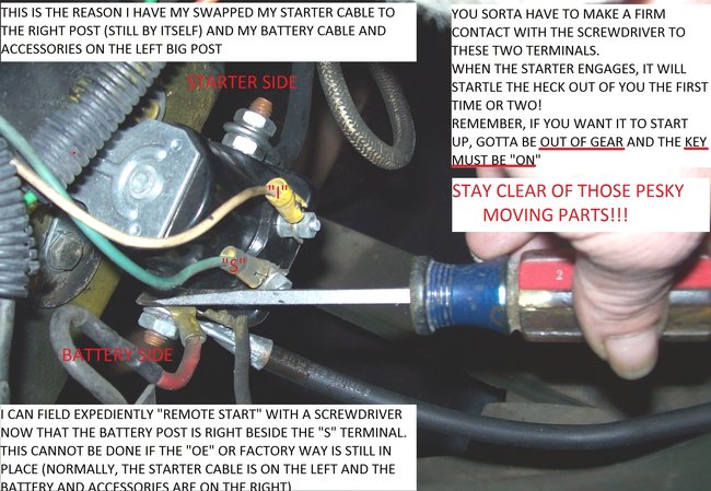

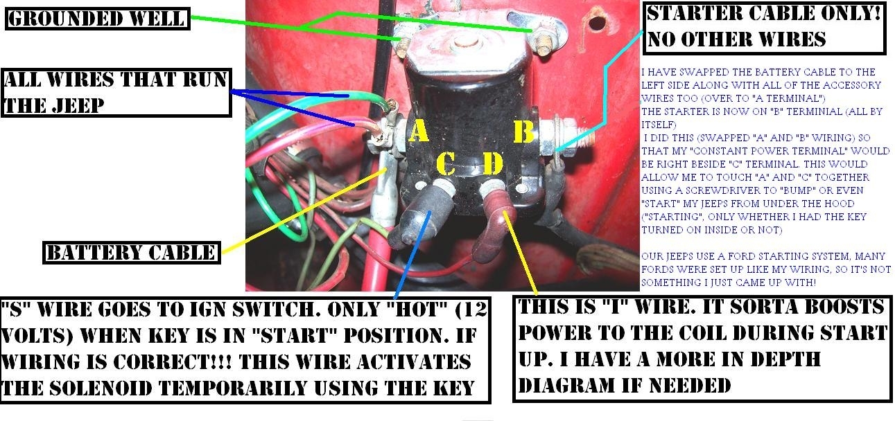

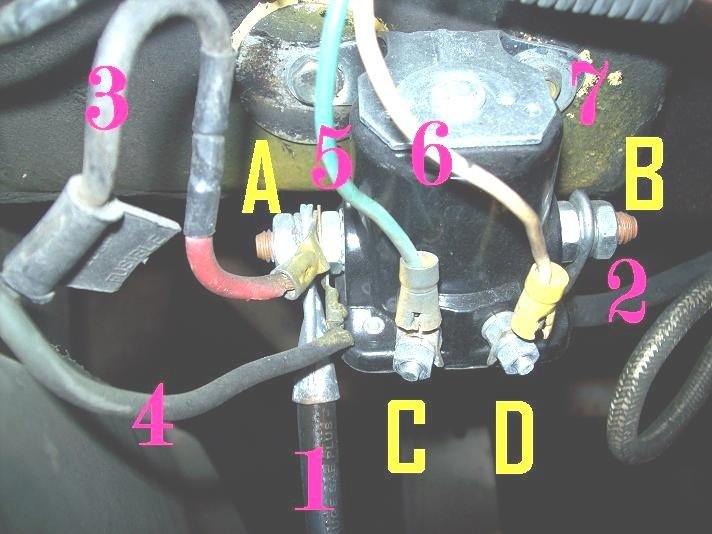

OK, LET'S LOOK AT THE SOLENOID AREA WIRING
YOUR POSITIVE BATTERY CABLE IS ON ONE POST OF THE SOLENOID AND ALL OF THE WIRES THAT RUN THE JEEP ARE STACKED ON RIGHT BESIDE IT
ON THE OTHER BIG POST IS THE STARTER WIRE ONLY
BACK TO THE POSITIVE POST!
SEVERAL SMALLER WIRES AGAINST THE POSITIVE BATTERY CABLE HAVE WHAT WE CALL
"FUSIBLE LINKS"
THEY ARE A BASICALLY A WIRE FUSE
THEY WILL PROBABLY BE THE BEGINNING OF THE WIRE(S) AND ONLY RUN A FEW INCHES BEFORE TURNING INTO A REGULAR WIRE
YOU HAVE SEEN 'EM MANY TIMES AND THOUGHT IT WAS JUST A WIRE
LIKE I SAID, THEY ARE ONLY A FEW INCHES LONG!
WHEN THEY "BURN UP", THEY WILL BE USUALLY ONE OF THREE SITUATIONS
BURNED IN TWO
BUBBLY OR FAT SQUISHY INSULATION
LOOKS FINE, BUT IF YOU SORTA PULL ON THE WIRE, IT WILL STRETCH OUT LIKE A RUBBER BAND (INTERNAL WIRE IS DISINTEGRATED)
IF THIS IS YOUR CASE
CUT OUT ONLY THE FUSIBLE LINK AND REPLACE IT WITH ANOTHER
IF YOU DON'T, THIS MIGHT HAPPEN, SEE MY LINK
https://www.youtube.com/watch?v=9B_9dWQukGY
LEMME KNOW WHICH WIRE (AND COLOR), I'LL SEE IF I CAN ROUND UP THE CORRECT AMP RATING SO YOU CAN GET A NEW ONE AT THE PARTS STORE
IF YOU NOTICE IN MY PICS MOST ARE NOT MARKED
(ONE OF THE NEW ONES I INSTALLED ON MY 1946 WILLYS HAS A TAG ON IT) YOURS PROBABLY HAS NOT TAGS
3 AND 4 ARE FUSIBLE LINKS ON MY '46
PICS BELOW

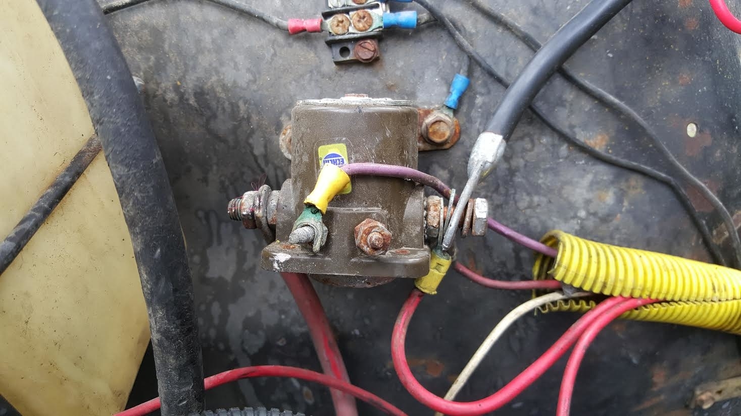

Thank you for the quick reply. Aside from the battery positive cable on that side of the solenoid, there are two additional wires. I will have to check them tomorrow, it's a bit dark here on the East Coast. However, my thinking is that those two wires wouldn't have an affect on the ignition. Currently my Ignition Wire is running to the D post in your picture (It's the purple wire in the attached picture. I took this in the process of disconnecting everything.) If I throw 12V at that post, the engine begins to crank and starts just fine. Would the fusible links affect ignition?

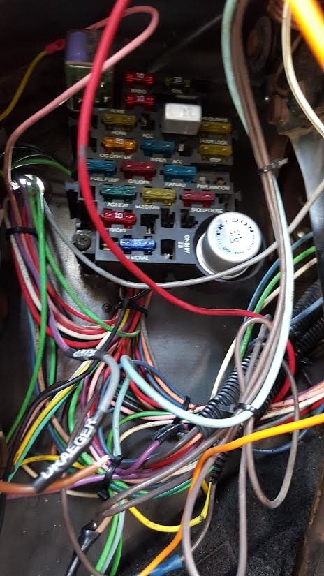

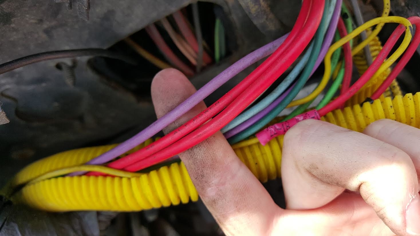

I went ahead and traced the wires all the way back to the fuse box. Each wire from the solenoid switch is just one single wire, I did not find any issues with them from the solenoid to the fuse box.
The wires in the picture:
Purple Wire = Ignition Switch
Middle Red Wire = Alt Power
Bottom Red Wire = Solenoid Power
I also checked a few fuses in the fuse box, I couldn't find any blown fuses that could possibly prevent the key from cranking the ending.

LOOKS LIKE IT'S BEEN REWIRED
THEREFORE I SORTA CAN'T (WON'T) TRUST WIRE COLORS, I WILL TRUST ACTUALLY FINDING OUT WHERE EITHER END GOES!

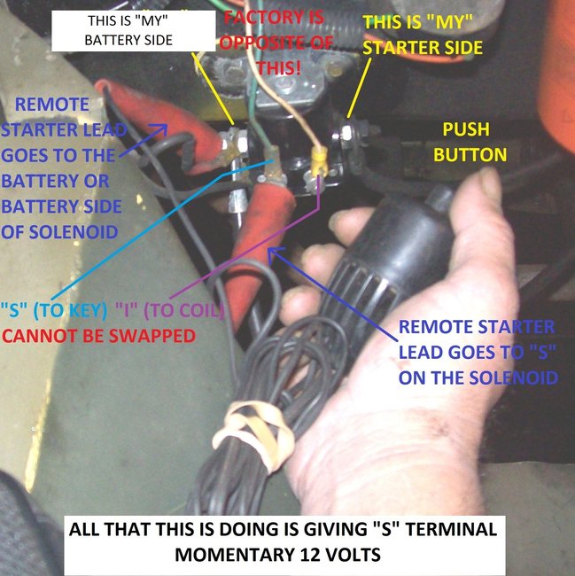

IF YOU LOOK CLOSELY ON THE PLASTIC NEAR THE LITTLE SOLENOID POSTS YOU SHOULD SEE AN EMBOSSED "S" ON "MY C POST" AND AN "I" ON "MY D POST
"S" IS WHAT SHOULD CONNECT TO "START" ON THE IGNITION SWITCH

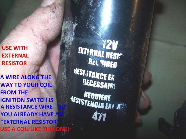

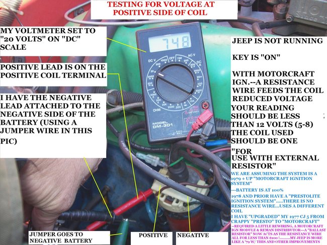

"ON" ON THE IGNITION SWITCH SHOULD ENERGIZE THE POSITIVE SIDE OF THE COIL WITH VOLTAGE. WHAT DO YOU HAVE ON THE POS SIDE OF THE COIL, KEY ON? SEE MY PIC.

MR. SOLENOID LOOKS A BIT RUSTY HERE AND THERE, IT ALSO MUST HAVE A GOOD GROUND TO THE FENDER (REMOVE AND SHINE IT UP)

PIC 1) CORRECT COIL

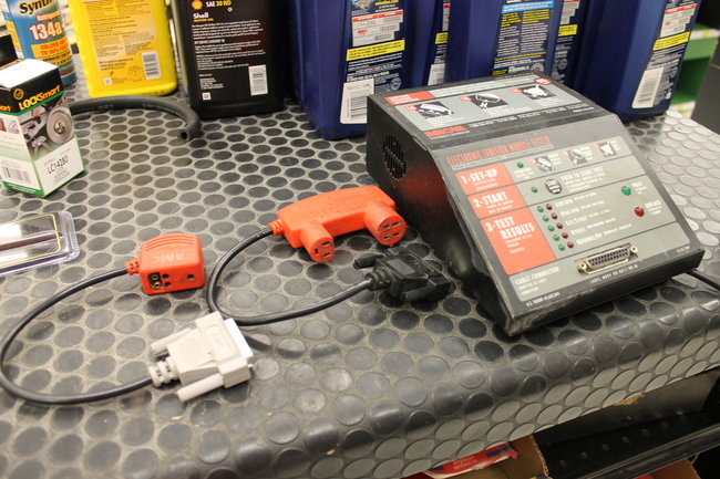

PIC 2) ADVANCE AUTO PARTS IGNITION MODULE TESTER (TEST 5 TIMES IN A ROW, TEST A BRAND NEW ON THE SAME WAY BEFORE YOU LEAVE THE STORE!)
PIC 3) VOLTAGE TEST FOR POS SIDE OF COIL
