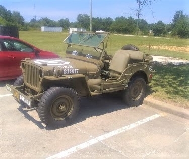

These are existing pics I made, I could make some closer-ups to show the spiderwebs if you want. Even though I have a CJ-2A.........I do have the "Instructional Video" from 4 Wheel Drive Hardware (maybe 1990 or so VHS) showing step by step--changing a CJ7 body over to glass--all the "TWEAKING" that is necessary to make it fit/ work. Really well made and informative. Just looks really EZ, since the hard work is done off camera...they were very specific, with the steps! Let me know what you need, or to know. I also share my Walmart Photo Album Sharing with CJ People---lots of pics--captions of what I have done--several really good CJ mechanical modifications...May help you with same problems I have overcome...I will send you a PM so you can leave me your E-Mail so I can send you "Veiwing" of the 6 or more albums. Noise reduction will sell you with "glass" by itself! The Medic This is the rack on my '77 CJ 5 (MR. JEEP) it is built similar to the one I made for "WILLY"...Mr.Jeep's spare was on the passenger rear fender...4 different times! I got tired of the Jeep body work and paying for/ repairing fences...so we made a swing rack in the back.

11 years after this posting, I still have both of the same Jeeps!
Another cool thing is someone posted the same video (VHS) I have on You Tube.
Here it is!
https://www.youtube.com/watch?v=RbJrG2U2CqQ
Here's my latest pic of Willy, notice I performed some glass work and now have shovel an axe divits!
I hope this aids you!
The Medic
